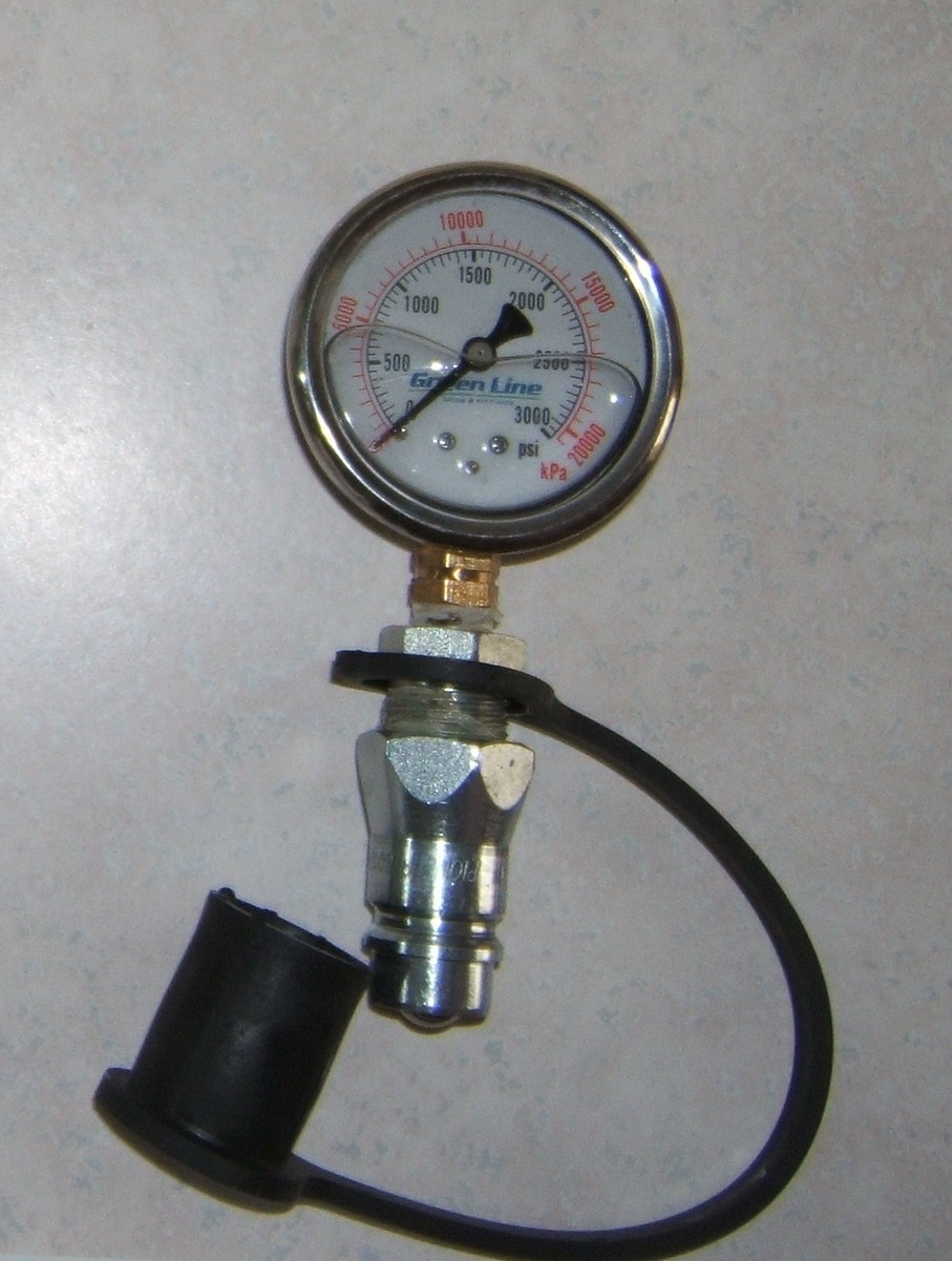

You need to invest in a 0-3,000 psi pressure gauge and a hydraulic fitting so you can plug your gauge into your tractor.

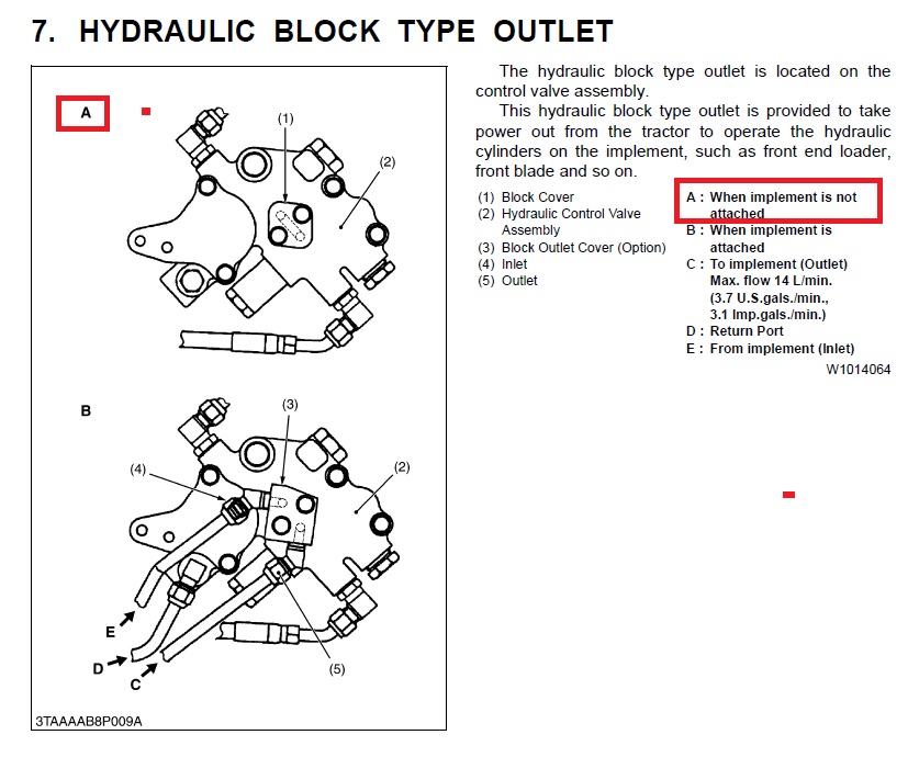

Your tractor has a hydraulic outlet block to provide power to your optional loader.
The lower part of the above illustration is what I expect you have since you have a loader.
You need to study this material and then try and trace each line going to your loader valve as I suspect a line is in the wrong place.

I have a pressure gauge but I’m not real sure where to plug it in.
Disconnect any quick connect going to a loader function and connect the gauge instead of the hose.
With the tractor running move the control lever to send pressure to the gauage and read the pressure.
A few seconds is all you need.
