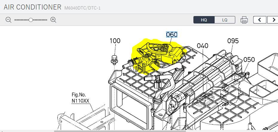

I have not removed the heater valve and don't know exactly where to find it.
The M has the ac/heat unit under the seat so at least it is somewhat accessible as my old L4630 had it under the roof.
Too darn cold for tinkering right now and the tractor is too tall to get through the shop door.
I have been bundling up for powing and at least I am out of the weather.
Spring should be here any day now:eek:
29,077
5,375
I would be getting into this and checking this valve!
