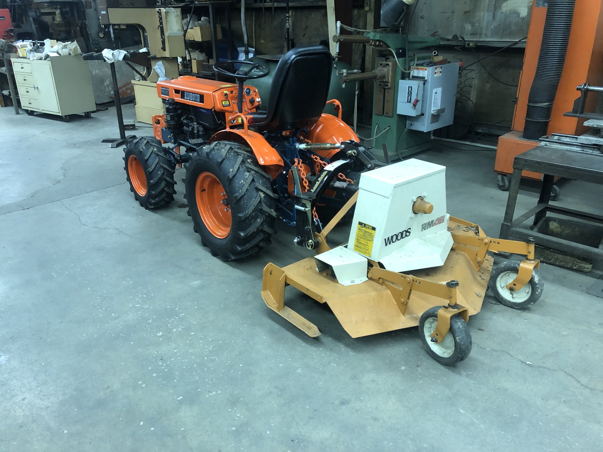

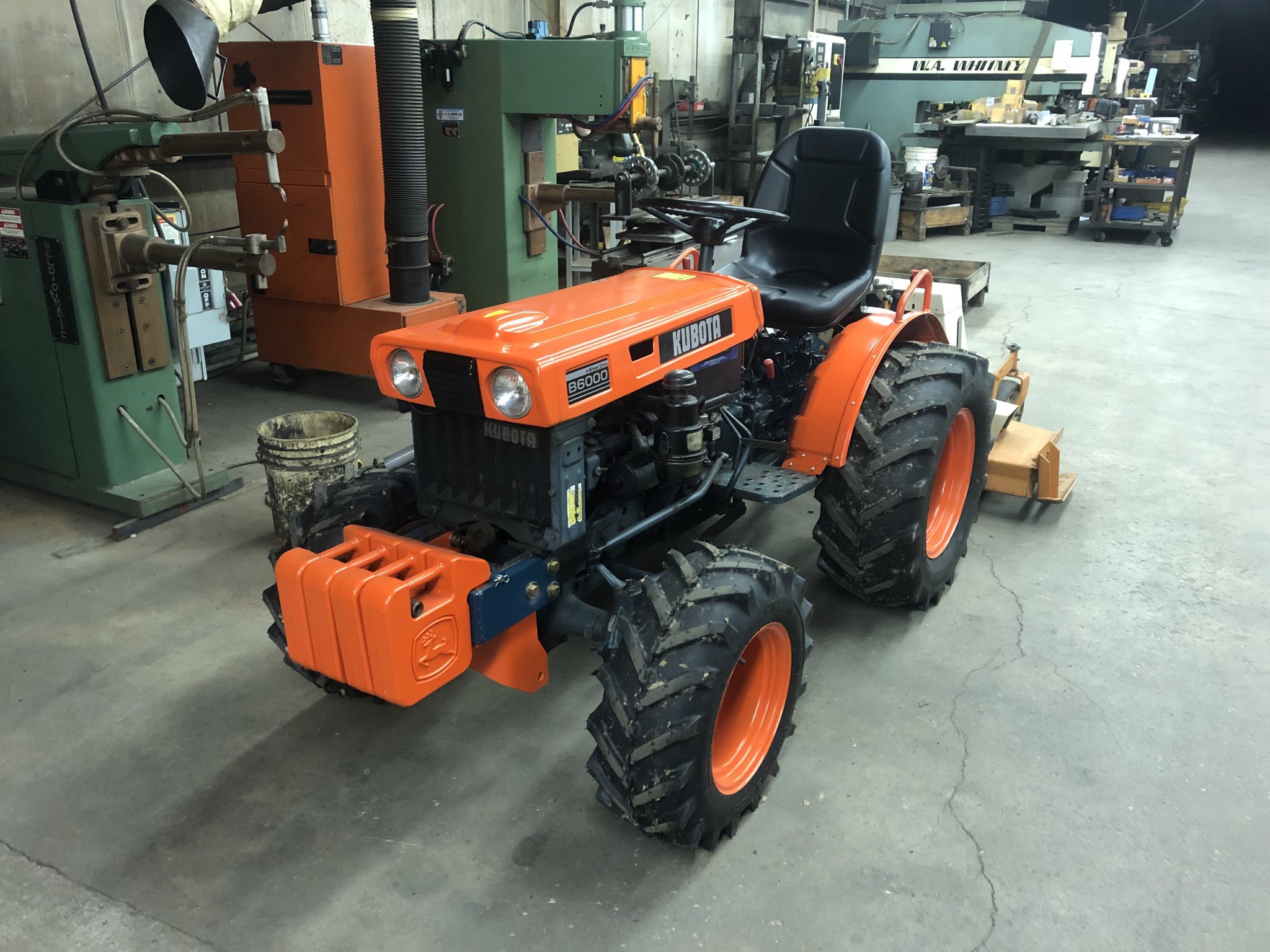

Here is a couple of pictures View attachment 45881 View attachment 45882 of my 6000DT. I have a belly mower but they are a pain. I have Woods RM48 but I have a reverser for the PTO. By the way the PTO turns counterclock wise on B6000. Woods did make a RM48 for the counter clockwise PTO. I saw one on Craigslist several months ago. You are somewhat close to me and if I remember it was up your way. By the way, get the operating manual and the parts list. They are avaliable online to download. Feel free to ask questions. I had a B6000 since at least 1977. I would go with turf tires on grass. I use mine in a swampy field. Millers in Ohio has them.
What rear tires do you have on yours? I spin so bad with my bald truck tires and would rather use something like the ones you have (similar to the ones of my borrowed BX-25) which , when dry haven't torn up the lawn and offer'd great traction uphill.

Carlisle Farm Specialist, 7.50 x 16.

Could just be the picture angle, but those 3 pt arms on the dt sure look long! That could be an advantage when carrying a counterweight for the loader, but might make interchange with the other one an issue. Are they the same?

I think its the angle and the dirt from before it was cleaned and painted. They are std cat 1 size

You were right.
8-16 on rear, 6-12 on front.
The 7.50 - 16 size was what was on the tractor when I got it.
