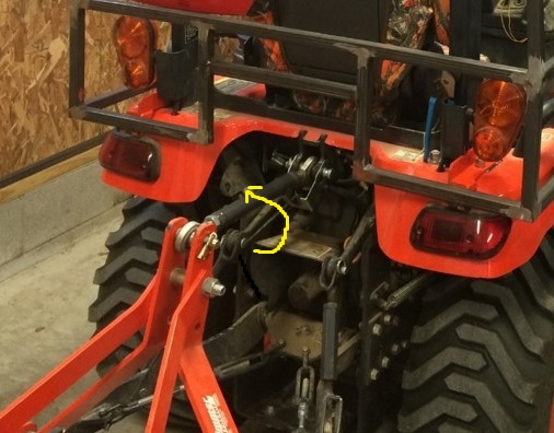

Your mower has to be fully raised in order to turn the 'Height Knob' to the Top position.
In order to keep the back blade raised, you'd need to reposition/move the 3pt arm links. Or, chain the arms up. It would be easy to use those mounting points and chain the 3pt arms in the raised position without moving the arms to the brackets on the ROPS.

Thanks, do have the mower in the fully raised position but still having problems getting the knob to the Top.
Looks like I would need need long locking pins to go through the link joint into the hole in the bracket. Is this correct? The tractor is located on some land we have, will be back there this weekend to see how this would work. Thanks for the input!
