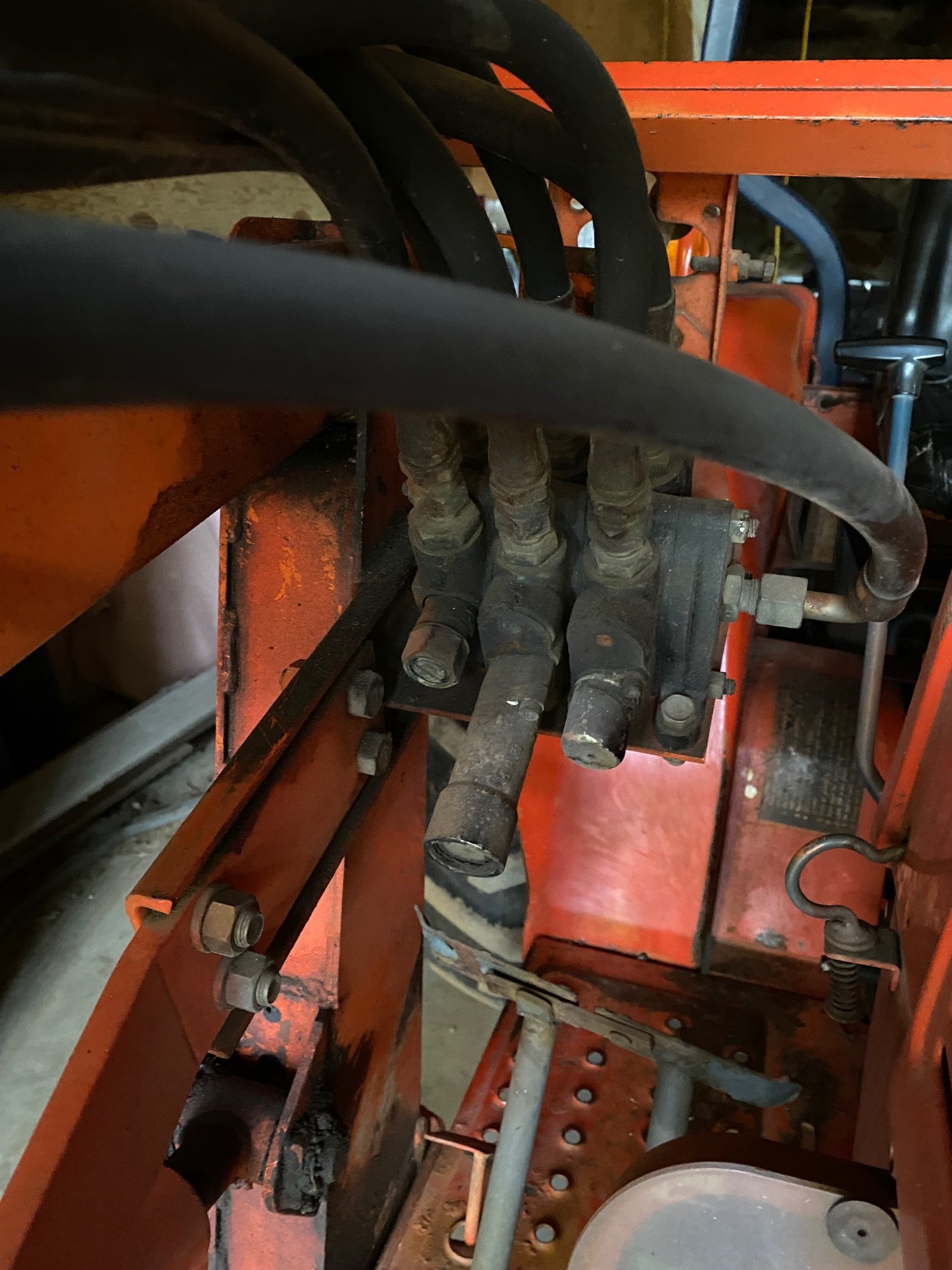

Float is a function or feature built into the loader valve.
Start by determining how many hoses connect to the loader valve. 6 or 7.
The answer will help advising you on a possible replacement loader valve.
Why do you think you need a float feature? Most tractors of the 1960's and 1970's did not have it and their owners coped quite well.
Dave
There are seven hoses, two rows of three and then the one on the end.

That loader valve looks like the one used on a BF300 loader and it has float on the boom spool. Push forward for power down, continue past the detent to the next position for float. May or may not lock in the float position.
MAArcher
Kubota B8200
Oct 6, 2022
47
New England
Damn. I guess I should have taken a moment to read all the labels. I'll try it later and see how it works. Thank you!
