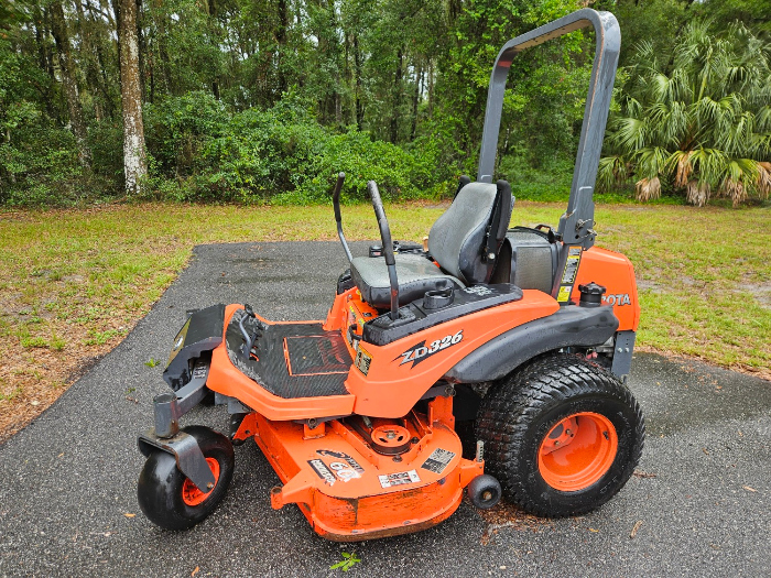

"New" Mower. Tell me How I Got Cheated

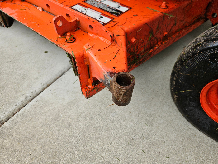

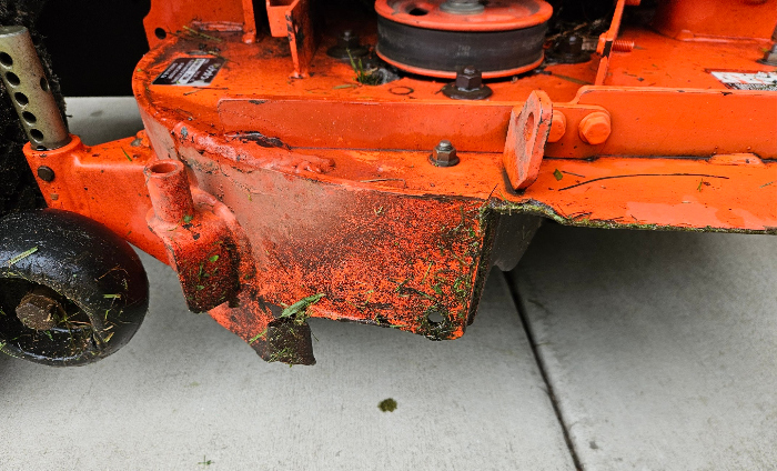

He put tires on it, as I said. He had no idea where the anti-scalp parts were.
The parts diagram for the cutting height dial ("cam dial" K3181-44430) appears to show that the shaft under it will come off if I can get the cotter pin out, but the shaft is currently turned so it is not going to be easy to get at that pin. The deck needs to be raised so I can turn the dial, but I can't start the mower, so I have to take care of that before I can remove the dial.

I believe I found the serial number. There is a number on a decal on the lower part of the ROPS; 37***, I think.
That is the ROPS model and serial number.
The mower model and serial number are on a decal, which is located under the RH fender/operator's platform, stuck onto the mower frame.
Thanks for the info. I found it, and it sets me back a few years. I will ask Kubota.

In case anyone is wondering, the serial number on this mower is very hard to see when the deck is raised.

I believe I found the serial number. There is a number on a decal on the lower part of the ROPS; 37***, I think. Manufactured in Fayetteville and so on.
