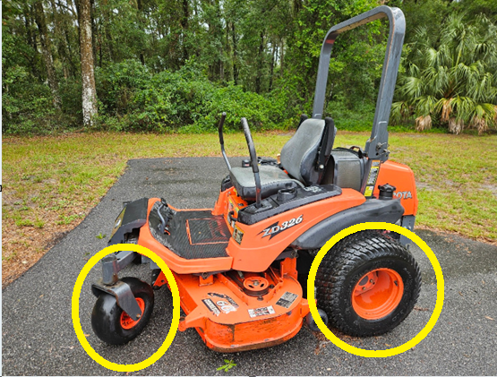

When you say He put new tires on this thing as well as filters and fluids, and he says the dealer told him not to bother with the front scalp wheels on the corners, do you mean new tires on the rear drive wheels?
Shouldn't they last a lot of hours?
PaulL
Jul 17, 2017
2,635
1,607
NZ
When you look at the deck it has anti-scalp wheels on each corner of the deck. The front ones are entirely missing - someone's taken them off then lost them.

I took his statement to mean that the pneumatic tires had been replaced. Shouldn't they last longer than 500 hours?
No, I believe he's talking about the anti-scalp wheels. In that photo you can see anti-scalp wheels on the rear of the deck ( just in front of the rear tires). You can see a bracket for anti-scalp wheels on the front of the deck, but no wheel.

Here is his quote:
Question: do I need to replace the scalp wheels? He put new tires on this thing as well as filters and fluids, and he says the dealer told him not to bother with the front scalp wheels on the corners. Weird thing for a dealer to say.
I did see that the front anti scalp wheels were missing. I took from his words that he meant something different by tires. Maybe Mr. Haney will come back on and clear up what he was referring to.

I was talking about anti-scalp wheels.

I stand corrected. I hadn't heard them referred to as anti scalp tires before
