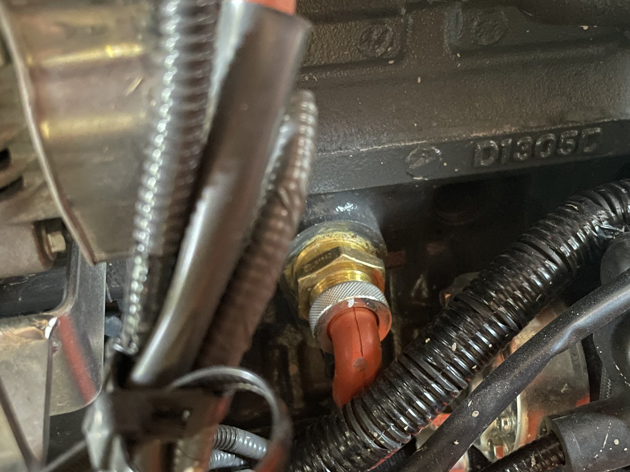

I’m wiring up my auxiliary LED lights today and took a look at the block heater. The drain valve is just under the block heater. You can’t see it in this pic because the little orange wiring boot blocks it. I tried getting a better pic but none of them really helped. You can’t miss it. View attachment 77552
Hell yeah, thanks Shekkie! Any tips on draining? I think I can probably get away with funnel and hose without making a mess. Plan is to dump everything that comes out right back into the radiator.

No tips really. I have a giant drain pan I put underneath after I made sure it was washed out. My tractor was unused by me at that point so still clean. I dumped it from the drain pan into a jug through a paint filter then back into the radiator.
The nice thing about the petcock location is that you only drain as much as you have to to swap in the heater since the drain is only maybe an inch lower. I opened it, took the radiator cap off, went inside for dinner, came back out and it was no longer dripping. Easy peasy.

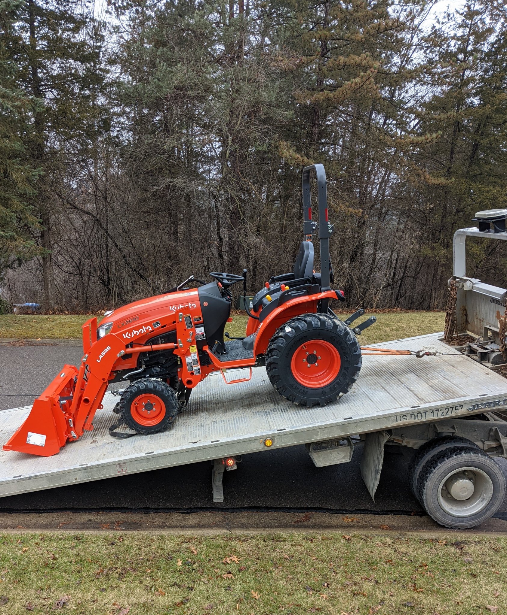

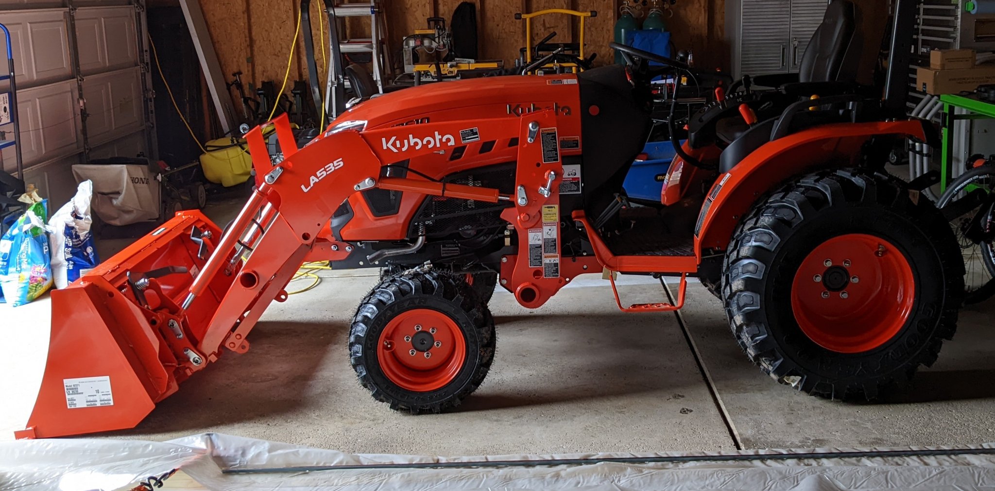

She showed up today, got to drive her around for a bit and let my son get some seat time long enough to snap a few photos. I love this tractor! Going to break it in this weekend by moving a whopping 1 yard load of 6A limestone for our standby generator base 😂
I ordered a cutting edge from a local Kubota dealer for the 54" bucket for general duty for $120 to arrive by this weekend and plan on ordering a pirana or EA toothbar for future projects (4-5 week lead time). More mods and implements to come soon.

Congrats on the new tractor! When you do the block heater you will need a 17mm hex bit socket the factory plug is tight probably on the order of 100 ftlbs. The block heater takes a 1 3/8" socket to install and even with thread sealer it needs to be very tight. I had to get mine to at least 80 ftlbs to stop it from dripping.
If you use Amazon the hex bit is oemtools 22843 $5.98 the socket is DeWalt demt19289b $4.00

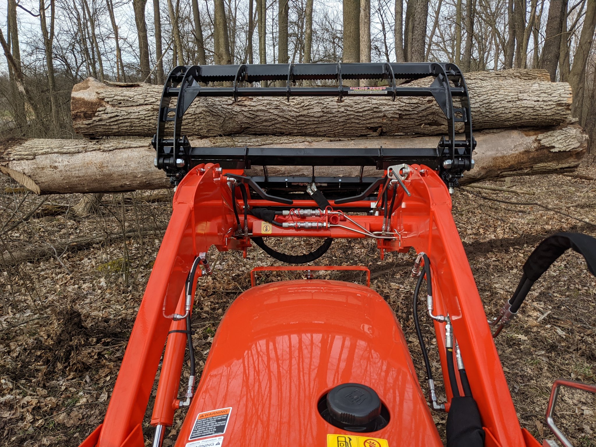

If your doing much clearing in the woods there is not anything that works as good as a grapple. I have the EA Wicked 55 for mine but I had to wait 5 mounts for it to come.... Tree in Grapple.jpg

I used a 12" or so extension with the breaker bar to get out where I had more room. When you install the block heater I removed the drain petcock so the socket had room. Also I flushed out all of the factory green coolant with distilled water and used a nitrate free extended life antifreeze. This is the one I used NAPA carries it. https://www.valvoline.com/en/zerex-nitrite-free-extended-life-antifreeze/
When you go to unscrew the plug for where the heater goes you might need a pipe on the flex handle I think the factory used a impact to screw it in!

Much appreciated! I may also do that flush as well. I've run nitrite free in a few vehicles in the past. I wonder if the paint has anything to do with how difficult these are to remove... Lol
