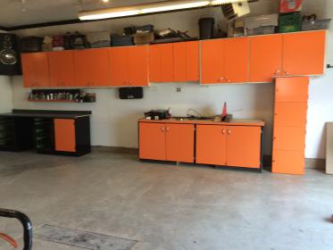

Jetman, you made my decision easy, my black cabinets hide greasy fingerprints, but dont brighten shop much. Been tossing around the idea of orange, guess im getting a gallon....thanks
Thank you, and good luck on your paint job. I did prime the cabinets before painting which took a long time but I am happy the way it turned out.
This is an on going project for me , because I have an Orange and Black, check a board tile floor going down when the weather gets warmer here. Should make it stand out when the floor goes in.
Just to help you get moving , this is where I started and it's a work in progress, when I have time after work :(
The floor was only put down as a test for later installation.

Great garage! I did my cabinets similar but in Ford blue because I have a number of old Rancheros. As a pretty cool tip i went to the flea market and bought a bunch of cheap Chinese open end wrenches. I welded a couple 1/4" bolts on them, cut some steel brake line for spacers and used them as cabinet handles. I think i paid a buck each for the wrenches and a Saturday afternoon and have some cool handles in the shop.
Later, Trashpicker

Well, that definetly brightened it up. After moving out i find it difficult to organize things. Still hunting for tools and parts.

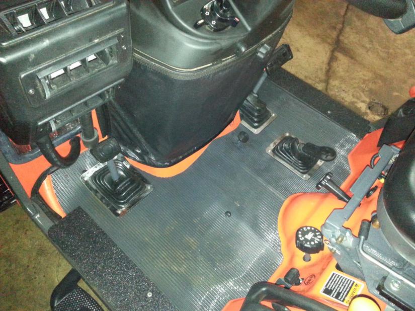

The cover located under the steering wheel, comes from Curtis Cab company, which was part of the cab heater kit installation parts.
8SV-BX5014-VC AIR INTAKE COVER (BLACK VINYL)
http://curtisindustries.arinet.com/...EN&TF=Empartweb&loginID=consumer&Loginpwd=jqp
Works good keeping the cold air out.
Thanks, went to go look at my BX in the shop - and sure enough they had the cover installed :)
They took off the batter box covers or something they were showing me - not sure why.
I have to take a good look at her when she comes back to my garage
Its a really really nice cab from what little i saw so far of it

Good to know they did that for you. Just remember to take it off in the summer.
I haven't taken the cover off yet - but why did they remove the battery box cover? Any clue? I have the two pieces put to the side with a note saying put it back on in the summer time (I guess once the cover is back on).
Plus I have a few black hand turn knobs and some bolts in a box, not sure what they took off to put the cab on or where they go to.
I used your measurements to make sure the cab would fit in my garage. You were correct 79 1/2"! I was still nervous right to the point of slowing backing into the garage. But sure enough - I have three inches to spare :D
Did you put a wiper on the back glass? I see the two holes there so it might be an option. Not sure how the snow will fall on the back glass and if its needed. Guess I wont know till I see some snow falling.
