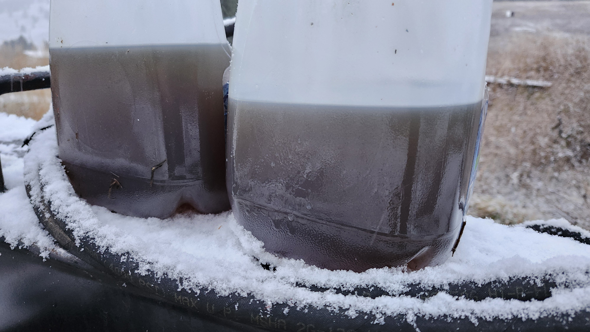

I recently bought a used hydraulic rear blade with angle, tilt and swing cylinders. I drained all three cylinders using a little compressed air to cycle them. I ended up with around 1.25 gallons of oil that was dark enough and unknown enough to warrant changing before connecting the blade to either of my tractors.
Now to your point about an implement that has always been run on your own tractor. The quality of oil in an hydraulic implement isn't as critical as the oil in the transmission, but the former affects the latter, along with the hydraulic and transmission oil filters in the loop. Manufacturers don't know what hydraulic implements are going to be used with the tractor, so the published service intervals are for the tractor only, or at least that seems reasonable. So the crux of this is what are the chances of the oil in an implement being detrimental to the oil that flows through the transmission of the tractor.
Your B2601 holds 4 gallons of hydraulic oil so how much oil is in the cylinders on your BH70 backhoe? I would guess that it holds somewhere around 1-1/2 to 2 gallons when you take into account all five cylinders and hoses associated with the backhoe. So if you assume that the backhoe holds close to 50% as much oil as your transmission, and the fluid in the backhoe is in the same condition as the fluid in your tractor, when you drain and replace the transmission oil, are you ok with the oil mixture that you end up with, e.g. 70% new and 30% old?
Personally, I don't like those numbers, so if I had a backhoe I'd be inclined to change the oil in it along with the transmission oil for peace of mind if nothing else. There probably aren't many implements that hold as much oil as a backhoe, but it's not a bad practice to drain and replace the oil from hydraulic implements on some kind of schedule. No doubt there are farmers all over the country who never bother to drain and replace the oil in their implements and claim to never have a problem. I have eight implements that have some form of hydraulics including a snow blower, front snow blade, offset flail, folding cutter, rear blade, post hole digger and two turn-over plows. I use the first four implements a lot so a yearly oil change on those wouldn't be a bad idea. Draining the hydraulics and topping off the transmission would be exchanging some older hydraulic fluid for new which also isn't a bad idea.

I doubt that any oil change, including engine oil, actually replaces all of the oil. There is always some left in places which don't drain. If you are worried about contaminated oil in the implements then I agree that you should change it. Otherwise, if the oil is fine other than normal use, each time you change the oil you are replacing some of the old stuff. I believe that is all that is necessary.
Of course I agree with your concern about buying used equipment with unknown age and type of oil. That should be drained out before connecting it to your machine.
That's my opinion.
There's a big difference between "oil left in places which don't drain" compared to the capacity of an implement that can approach 50% of the capacity of the transmission. Also, with the former you can't do anything about it whereas you can for the latter.
That's my opinion. 😂

Like many things in life, this comes down to one's comfort level because none of us have actual data to support our positions. Some here drain and replace the transmission oil at the first 50 hours along with the filter, despite Kubota only stating that the filter should be replaced. That's their comfort level.
Given the ratio of transmission oil to backhoe oil and the small difference between the cost of 4 gallons of UDT2 vs. 6 gallons, I'd be inclined to drain and replace, but that's not based on any evidence to say that it's the best practice.
