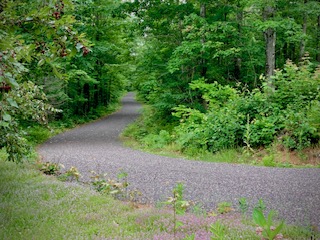

Just added another 80 tons (bit short of 80 cubic yards) of what we call 3/4" blue rock gravel. ~2 inch depth x 10ft wide coverage over ~800 linear feet. Unlike the mix of #1 & #2 gravel the previous layer of blue rock does not develop gullies after heavy rainfall requiring maintenance after every heavy rainfall on my relatively steeply pitched driveways. Average grade is ~6%. Bit too much of a crown left on the driveway after the previous (2018) application of blue rock. No need for a significant crown with blue rock.
New to box blade operation. Thanks to the people here for hints and advice. What worked for me was tilting the box upwards so the the rear push blade became a dragging reverse blade while driving forwards. Still required fine 3pt ride height adjustments to deal with the transitions and high/low points. First few runs just down the middle cutting the crown and reattributing the gravel to the sides. Image is the mid section of the between couple ~90 degree curves of the driveway after our last monsoon rainfall. The new norm. Drought or monsoon. No need to fire up Kubota.

Forgot to mention. After using the FEL and Vassar dirt bucket to haul gravel to low areas and ease the transition between steep and flat I still needed to load up the bucket when using the box blade. With it tilted upwards you don't move a lot of gravel from the pile to where you need it.

Couple days ago. Driving down and then back up after a hard rainfall the tire impressions are visible. With the #2 grade gravel of the past the driveway would have had washouts and deep tire ruts.

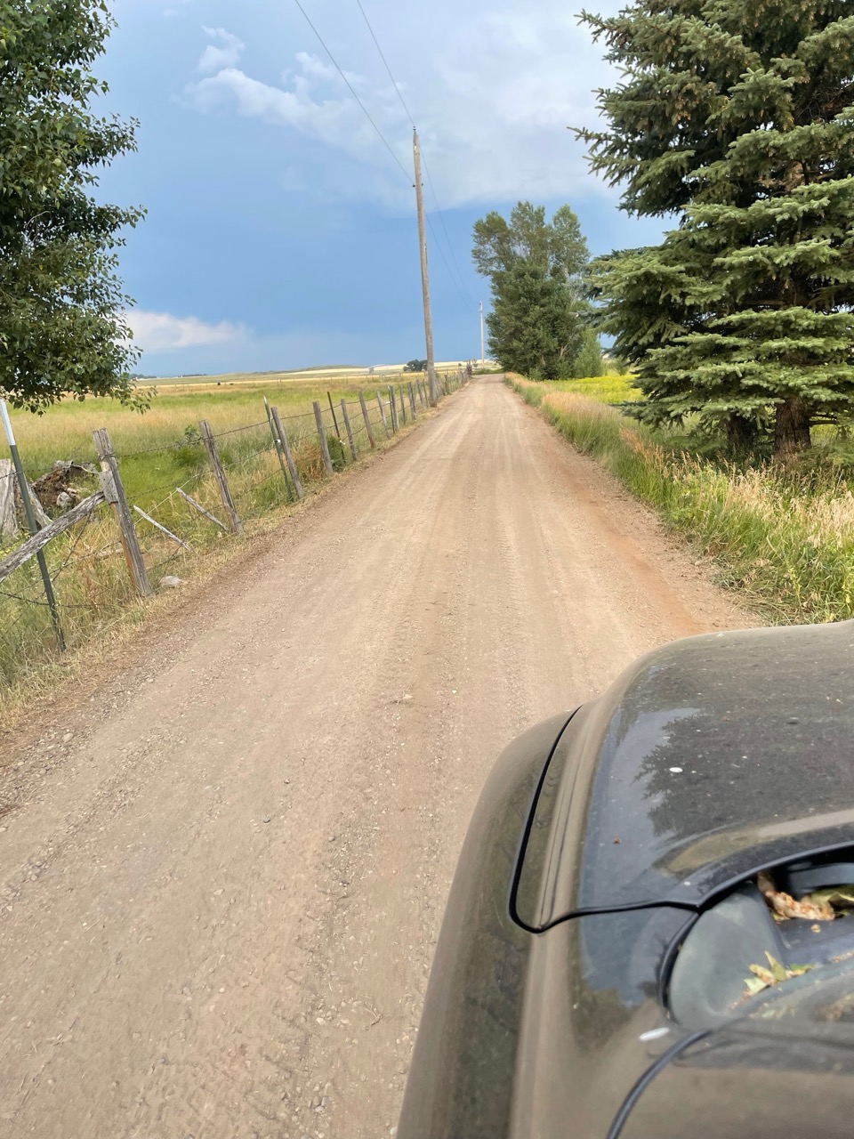

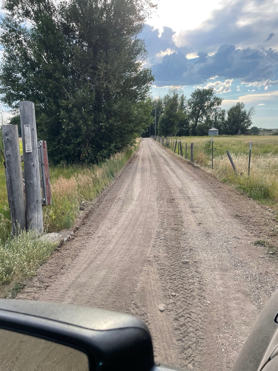

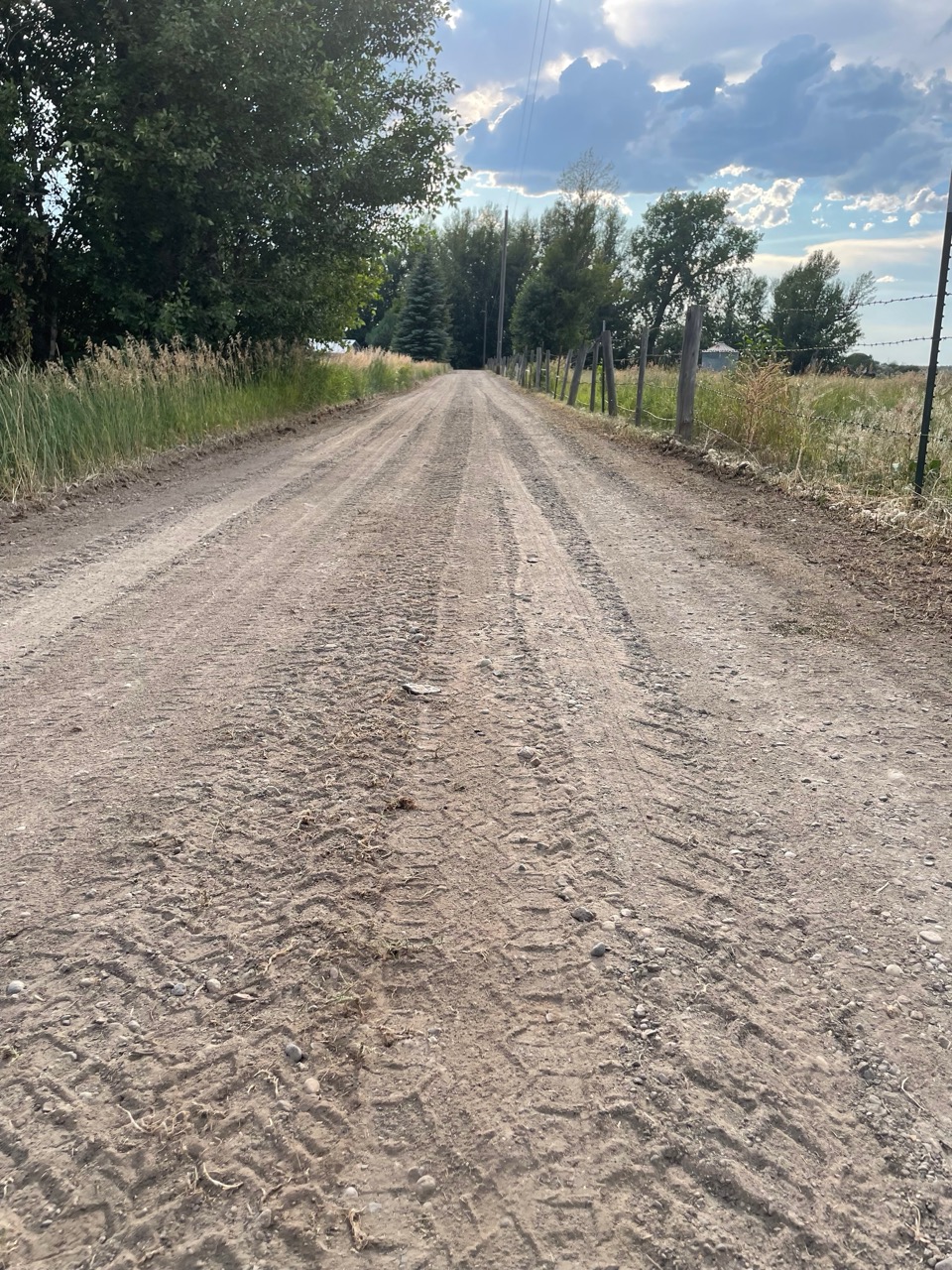

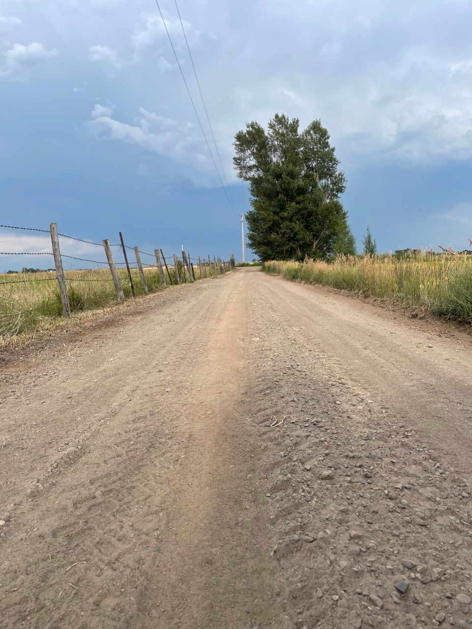

Update: I think I can claim success. Im not sure how it will hold up but its a huge improvement. We’ll see how it does after a few rain storms (whenever they come) and some traffic.
Didnt use the rippers as I wanted to leave as many of the larger stones where they were, and so far im glad i did. Its not perfect, but the ruts are gone and I believe the water will go where I want it to. A few soft spots that I'll keep my eye on.

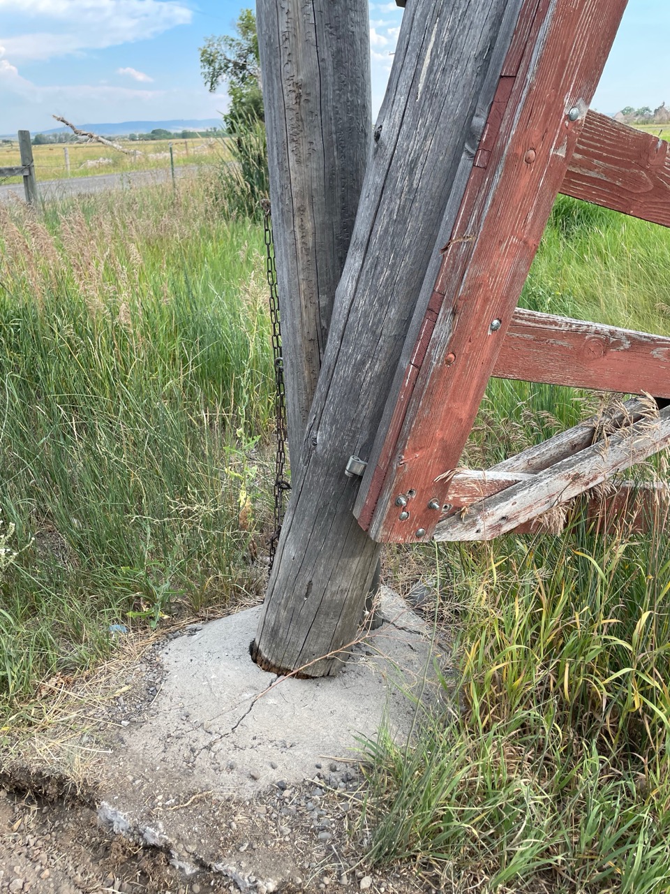

Biggest challenges, aside from no experience, were the larger river rocks it was pulling up & bouncing over, and my little 2620 not having the power to pull through the tougher spots with a full scoop. And I might have taken out a gate post with a wild bucket swing, but other than that…i think i got through this ok.
Pics again dont tell the tale but it drives fairly smooth, all things considered.
Thank you all for the advice! And if you have any tips on replacing a broken gate post...

On that gate post you will need to pull out the concrete and probably the post next to it. That will leave a huge hole and the hole needs to be a few feet deep (4-5) if you want to have a gate on it.
I would use a 6 inch steel post if I was replacing it, but you can use a wooden post if you prefer.
If you can’t get the post out then you can dig a hole next to the concrete and then pull the post over into the new hole then pull it out of the hole.
Good luck

Looking at your pictures again, you might be able to do something without replacing that post.
1) Stand your broken post back up and then bolt it to the post behind it that doesn’t look like it is leaning at all. I would probably use all thread, washers and nuts so you can adjust it to be vertical.
2) Cut the broken post off and use the post beside it?

Driveway looks good!! Drive on it a while then run the box over it again with the front blade mostly angled up so it's not cutting to let the rear blade kind of flatten out any rough spots.

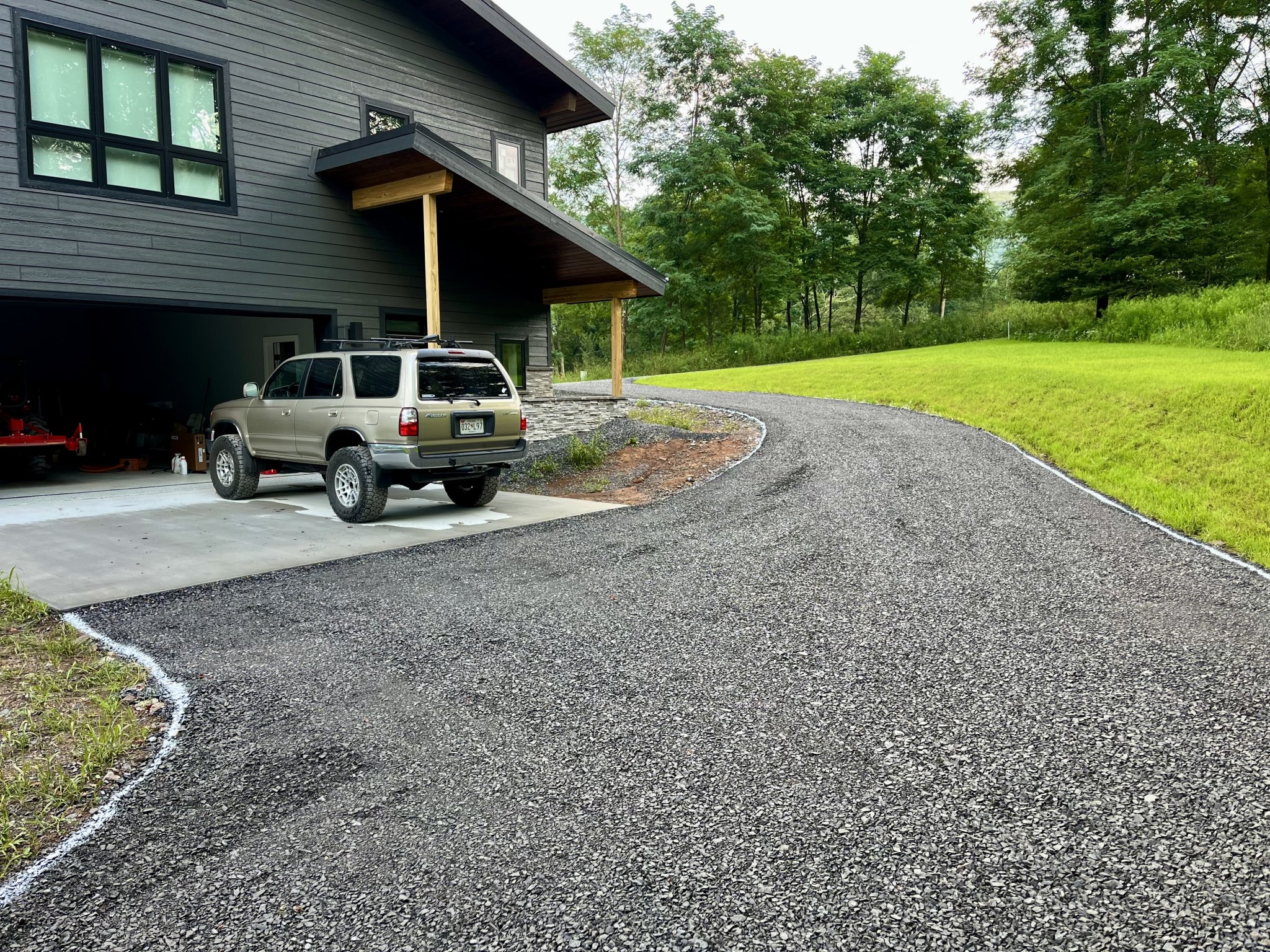

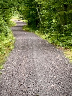

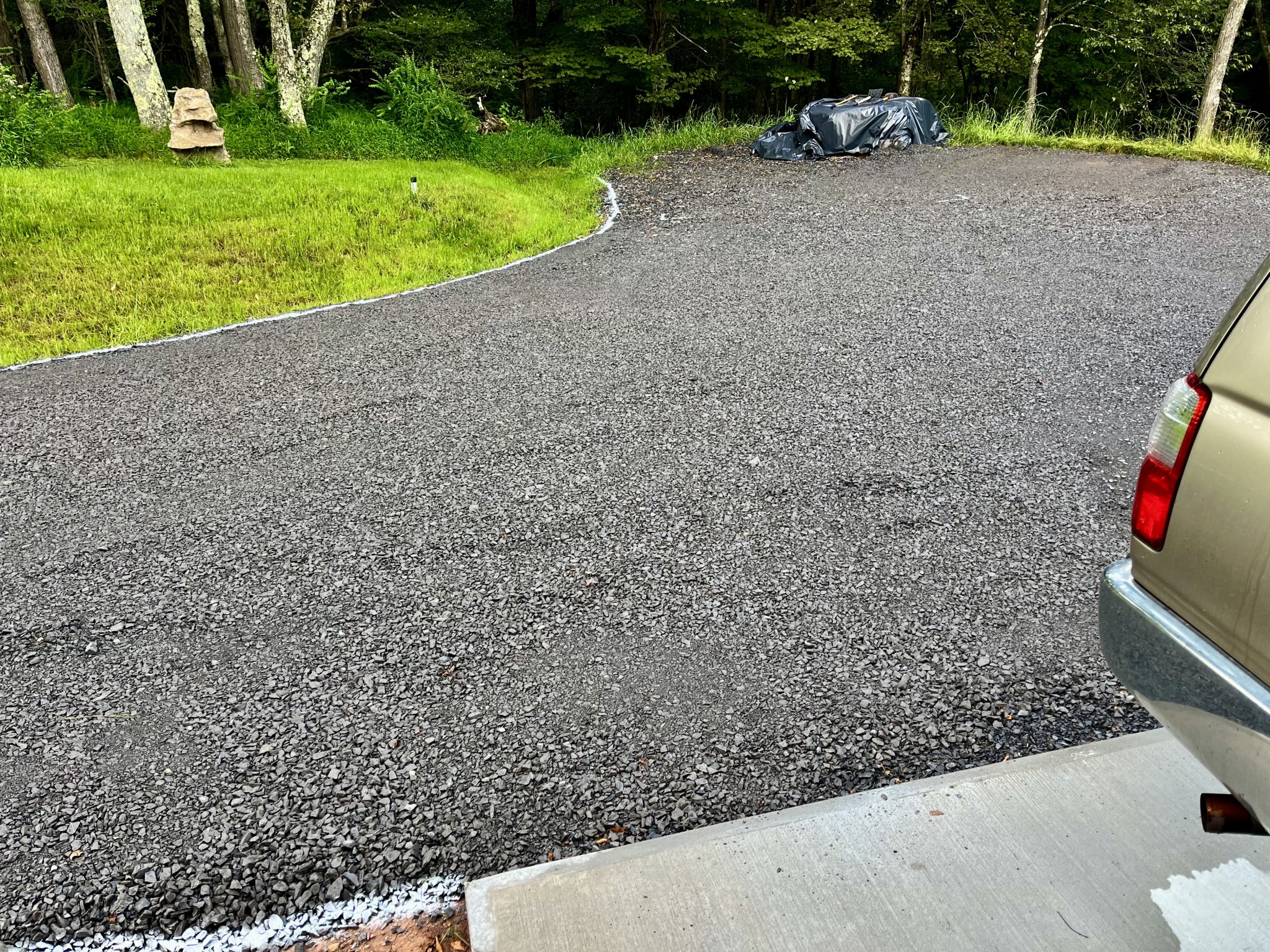

Nice result on the driveway!
I just spread a tri-axle load of 3/4 crusher run (I think that's the correct size) yesterday with my LX2620. We're building a house on the side of a mountain in WV and the excavator created the driveway over time using large gravel (3"-4" pieces) as a base, followed by a smaller size. I wanted to lay down the final layer.
After dumping a few buckets, I would back drag with the bucket teeth, then level the bucket and back drag. Last step was going up & down the driveway with the level bucket on float.

Looks real good. Did you haul in any rock?
On the post, if it's loose pull it out and set something deeper (and maybe a bit larger). Might be able to wiggle it back straight and tamp around it some. Just depends on how much it gets used and your 'want to".

No rock was needed, so far. Im surprised how much i was able to pull up, even without the rippers.
I think im going to try just that. If i can find a way to dig the remaining stump remaining in the ground, i might be able to just make it work. Hoping.

If the post is still attached to the concrete pretty good, put a chain around the post and if you have some hooks on your loader have the chain go to both hooks, the go forward, then backward just a few inches at a time until it loosens up more, then drag it out. Be gentle so you don't break the post off and them HAVE to dig it out!
