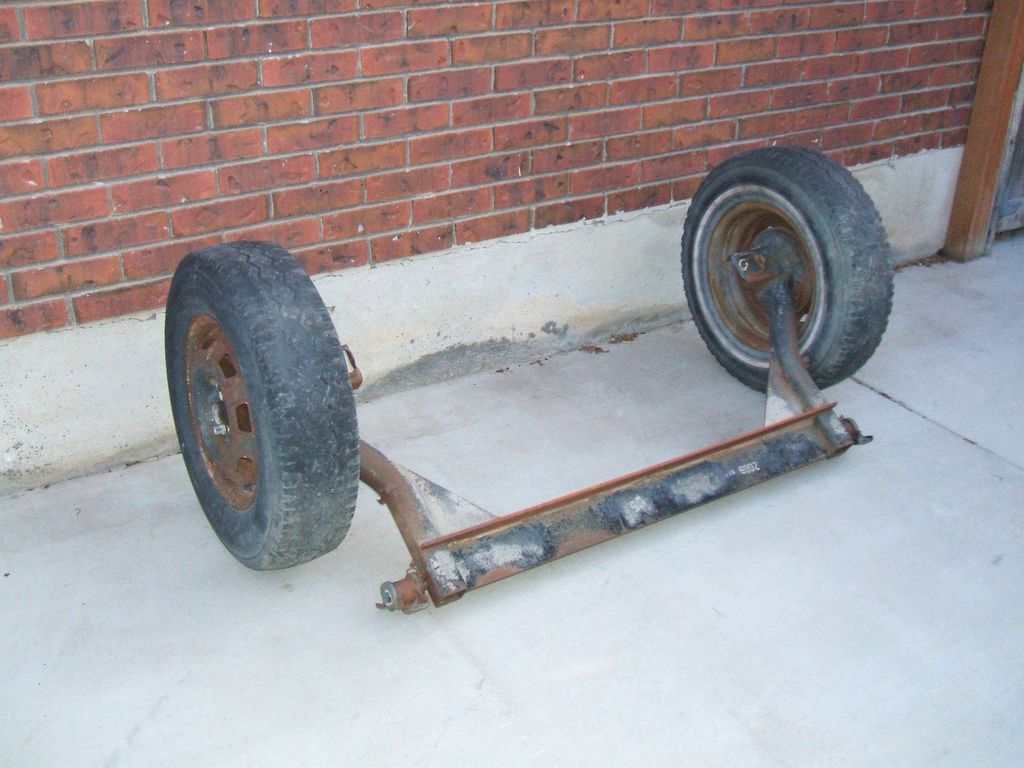

I've thought of making one by adding a long tongue to a front wheel drive VW rear axle. There are several models about like this one.
