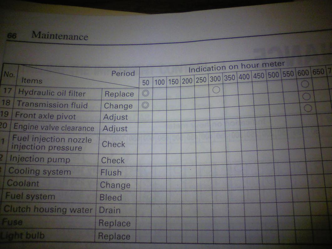

I looked just to make sure I remembered right, my M9000 says change fluid and filter @ 50hrs, change hyd filter again @ 300 hrs, change fluid and filter @ 600 hrs.Indeed! Wow, that's one of the first I've heard of a trans fluid change at 50. I hear it happening to people at dealers all of the time for their 50hr service on machines that do not require it. Make a one hell of a pricey 50hr! Your change is every 600 hours as well!?! That makes up for it. Wonder why most of the Ls go every 400 hours?

Do those machines have magnetic trans filters? I know when I changed the 3800 at the 50 mark the filter's magnet was loaded with shavings. @ 200 hrs I pulled off the filter to look at it and there was nothing what-so-ever on the magnet.I looked just to make sure I remembered right, my M9000 says change fluid and filter @ 50hrs, change hyd filter again @ 300 hrs, change fluid and filter @ 600 hrs.

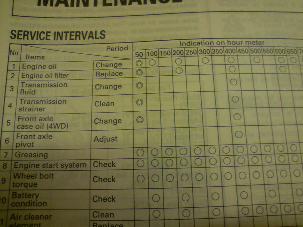

My L3000 says change fluid and clean strainer @ 50 hrs, then again @ 400 hrs.
Same here, except I have around 200 hours on mine. I didn't change the trans oil at 50 hrs (just filter), will wait and do it at 400 per manual.Do those machines have magnetic trans filters? I know when I changed the 3800 at the 50 mark the filter's magnet was loaded with shavings. @ 200 hrs I pulled off the filter to look at it and there was nothing what-so-ever on the magnet.
I have about 330hrs on the factory trans fluid and it's still as clear as when it was bought. I'd like to hear their reasoning for the 50hr change. Sounds like a waste of perfectly good fluid.
