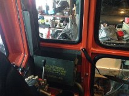

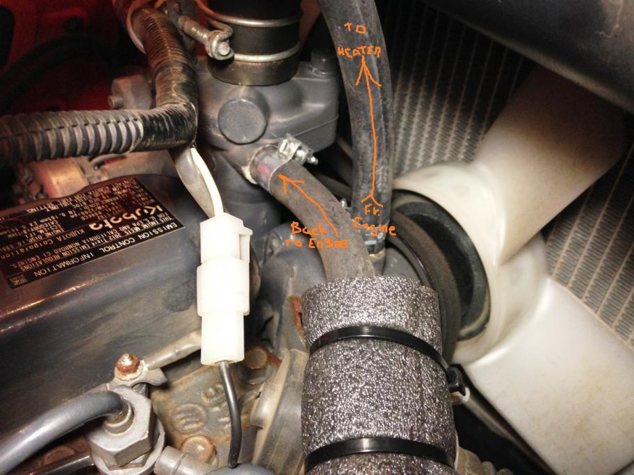

A couple more photos, showing the Cab Heater hose attachments location plus a couple of the Tool Box I'm installing in the cab.
I did hook the heater hoses into the Water Pump bypass fittings, I simply loosened the two spring clips and pried/twisted the short hose off the barbed fittings. I used 5/8" heater hose from the heater up under the lower cowling into the engine area, then using copper plumbing fittings, made a reducer with 1/2" copper pipe & reducer to 3/8", then ran short pieces of washing machine hookup hose from the reducers to the Kubota bypass fittings with hose clamps. I used tie straps to hold the hose along the air filter tubing to prevent kinking, and the foam pipe insulation shown, is simply to keep the hose clamps from rubbing on the fuel injector lines. This all worked very well, and since it gets it's flow before the thermostat, begins to produce heat as soon as the engine is started, as it warms up.
The Tool Box is a 7.62mm Army Surplus Ammo Box, measuring approx. 4"W X 12"L X 10"H. I originally bought a 50cal ammo box, however it was 6" wide, and slightly too wide, with having my rear aux. Hyd. valve in that area. I made a simple slide-in clip to hold the box in place, and it can be removed easily. - Works perfect. Photos were before painting, I'll paint it orange soon.
It works great to hold my spare shear pins, fuses, and basic tools, grease rags and extra gloves.
