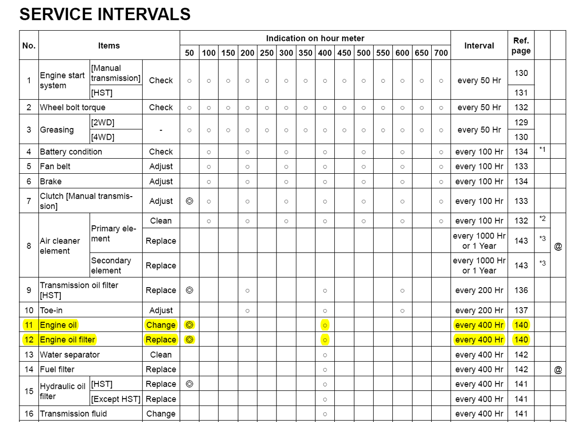

That's not what it says in the owner's manual I have for the MX. Oil and filter change at 50 hours and then at 400 hours is what it shows. The M6060 owner's manual shows 50 hours for oil and filter and then every 500 hours after that.
I’ll have to go look at my manual again. That does seem like a long interval between changes.
Edited: you are correct. 400 hour oil changes. It sure seems too long.

The new engines only require oil changes at 400 hours because they are not blowing the exhaust back into the inside of the engine and making dirty oil.
