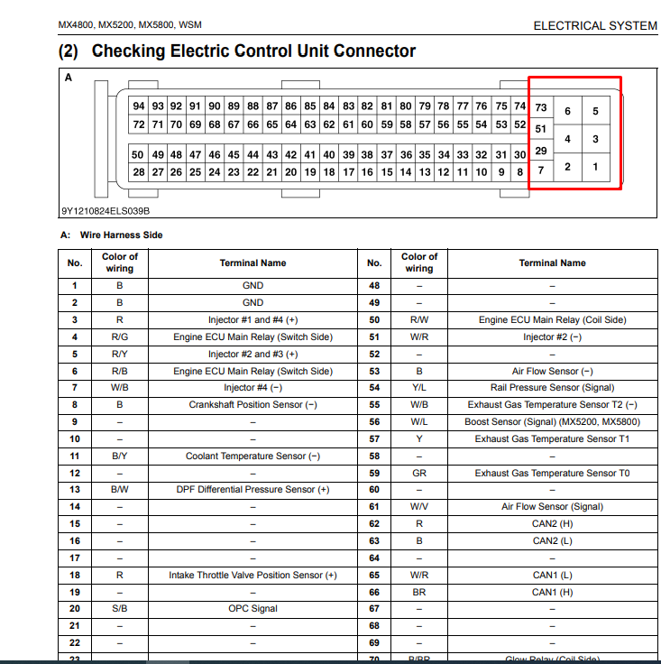

Just got it back from taking the tractor to the dealer. They put in "known good" ECU and still read the code. He did some quick checks on the pin-outs, more than discussed in the WSM, and said one of them was not getting power. I opted to leave it on the trailer and take it back home and work on tracing it down. He suggested replacing the wiring harness, but I'd like to find the issue on my own time first before I do that. He said the power wasn't coming through here, but I'm not sure what pins are supposed to get power and which aren't. Anyone know that answer? Haven't found it in the WSM yet

Based on what you have highlighted in RED, the only "power" coming in on any of those pins is (-) Ground , not (+) positive, the rest of the pins are outputs.
So look at the ground connections.
I woukd expect most of those are input signals.
Some engine sensors (e.g. CPS) toggle the line high (+) or low (-) to signal an event to the ECU.
Others like the coolant temp sensor vary the voltage to indicate a value like the temperature of the coolant.
The details of that should be explained in the individual sensor descriptions.
