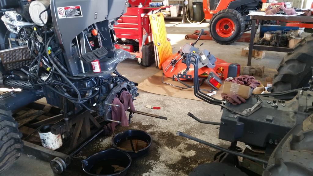

Here is a pic of the repair on a GL. Parts needed are 2 gaskets, sounds like the MX gaskets are available, the GL ones on back order. One poster said if the bolt loosens the HST will act like in neutral, so it may not be catastrophic failure issue
And that's not even a cab GL!
From what my dealer was telling me, it all depends upon the serial number. The dealer has a used 2018 MX on the lot they said they might be able to lend me while fixing my GL...just needed to check the serial number.
Thank you! This is what I was thinking but didn't know for sure. I'm ok with covering the brake pedal on my flat Texas ground as long as it's not going to damage the machine while I'm waiting on my dealer to get the parts.
