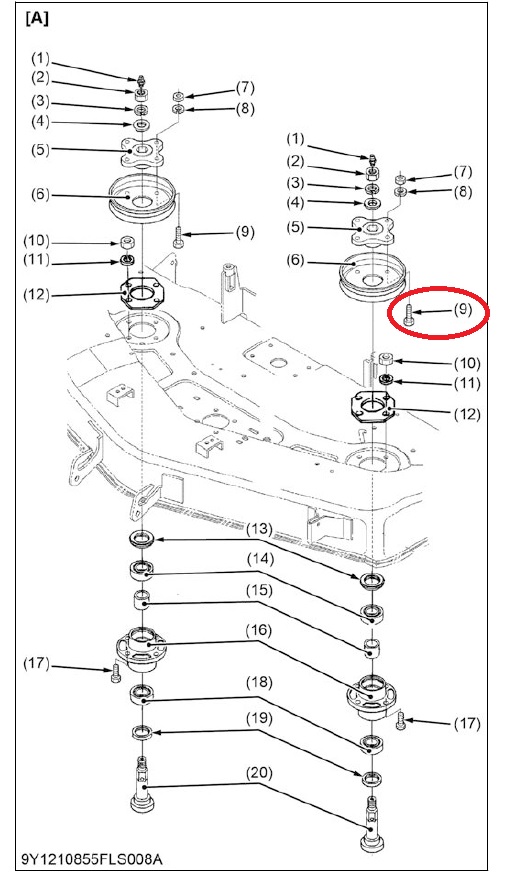

Yes my left blade stopped spinning after a piece of wood got caught, I think I need to replace the cup washers?
Try turning the blade and drive pulley holding unto the pulley while moving the blade.
Whatever is no longer locked together should be visible.
Try re torquing the blade bolt. Cup washers do not suddenly fail..
There are 4 bolts between the drive pulley and its hub which could have sheared.
