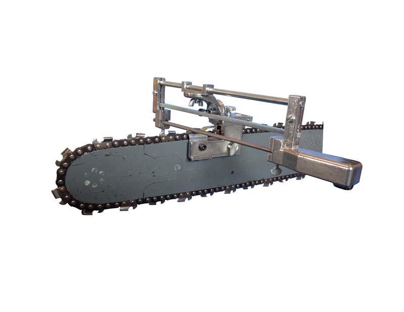

I personally (unintentionally) sharpen LH cutters differently than RH cutters since I'm not ambidextrous and have to be careful of that when free-hand filing in the field. In the shop I have Granberg jigs set up* so filing is even and precise, and unless a chain hits a rock or nail it's as fast as an electric grinder.

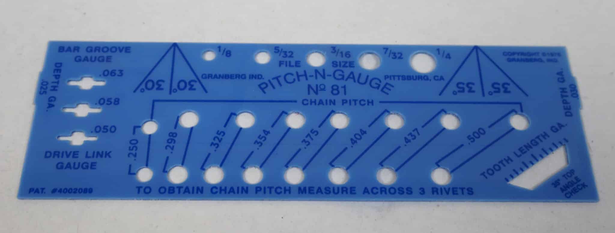

If you use a very affordable Granberg Pitch Gauge there's a window on the bottom right for measuring tooth length, which at this point your chains may need. If things are "reasonably in balance" left-to-right your chains will cut straight again.
*The Granberg jigs I use are no longer made, but they have an updated model that's all metal and works far better than plastic Oregon Made-In-China jigs.

Silly question- couldn't I use a vernier caliper for the same task?
WI_Hedgehog
Apr 24, 2024
1,130
1,646
Milwaukee, Wisconsin, U.S.A.
You might be able to, but with the multiple angles on a cutter and my ginormous hands I'm not able to do so repeatably--at least not last time I tried, and maybe I was being too picky. It seems like such a simple task...
Then again when it comes to picking up spilled coffee beans or rice I just get out the Dyson and Hoover them up.
Yeah, you can probably use a caliper without issue.
