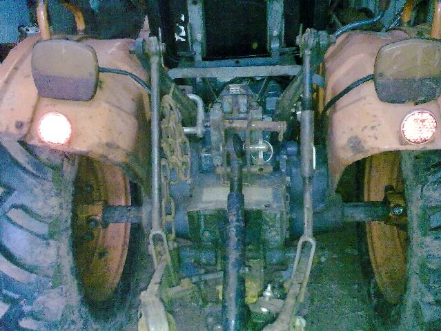

It's easy to tell- there aren't that many holes in the axle for adjustment- if the tire looks fairly centered with the fender, then you should have one more step to the outside.

If you want to get the maximum width posible,you can turn the wheel around on the hubs so the clamp and tube vavle is towards the tractor .you will also have to change the wheels from one side of the tractor to the other so the chevrons face the correct way.I have mine set this was or I would have turned it over long ago:eek:
