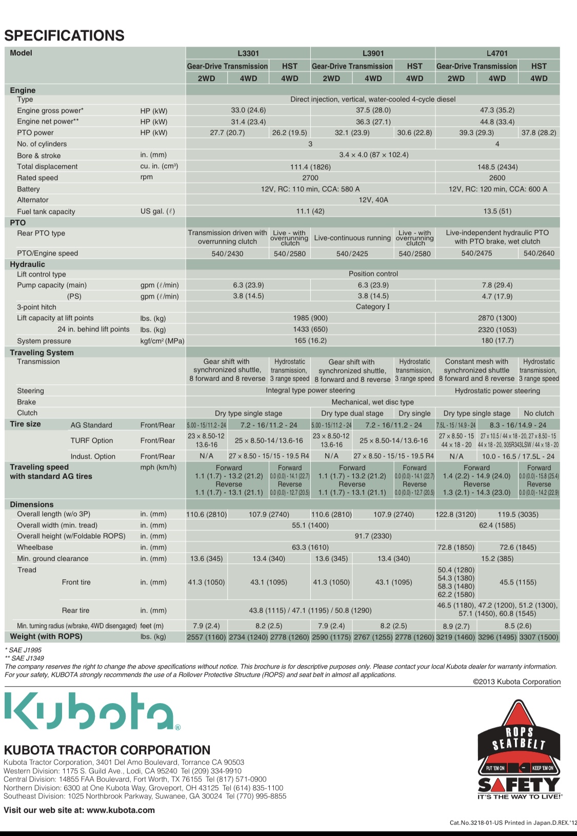

I'm digging up an old post because I want the same info as the OP. I can measure the tractor at the dealer but still need to know the weight.

I have that brochure and none of the OP's questions are answered on there. I reached out to Kubota with these questions and at least got one of them answered. The LA765 loader weighs in at (aprox.) 1155 lbs. That puts the tractor and loader at about 4,462. According to Rim Guard's tire fill calculator the rears would add 610 lbs each and the fronts would be 128 lbs each. I'm not sure yet if I'm going to have the fronts filled but if all four were filled then that brings the tractor/loader to 5,938. My 7K lbs. GVW trailer is not going to haul this. (safely/legally) Probably would need 10K minimum and at least 24 foot deck for this and a 6' bush hog.
