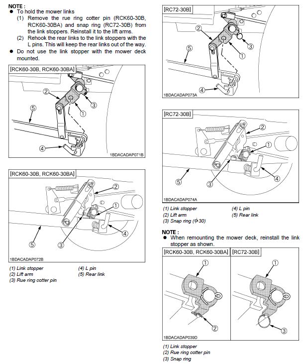

I need to make some hangers for when I don't want to pull the mmm using other 3 pt eq.
The B2650 I'm finding to be a great all around machine, no it won't keep up with my Deutz-Allis 6275 75hp 4X4 but the Deutz can't get around and run the 60"mmm either>
SDT
multiple and various
Apr 15, 2018
3,250
1,041
SE, IN
No need to make hangers.
Your MMM can be pinned in the fully up position allowing use of the three point hitch.
Instructions for doing so are in your mower (not tractor) Operator's Manual.

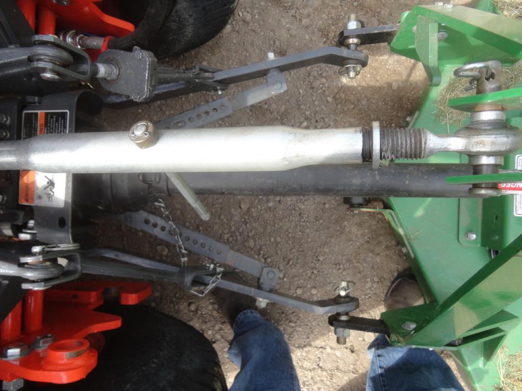

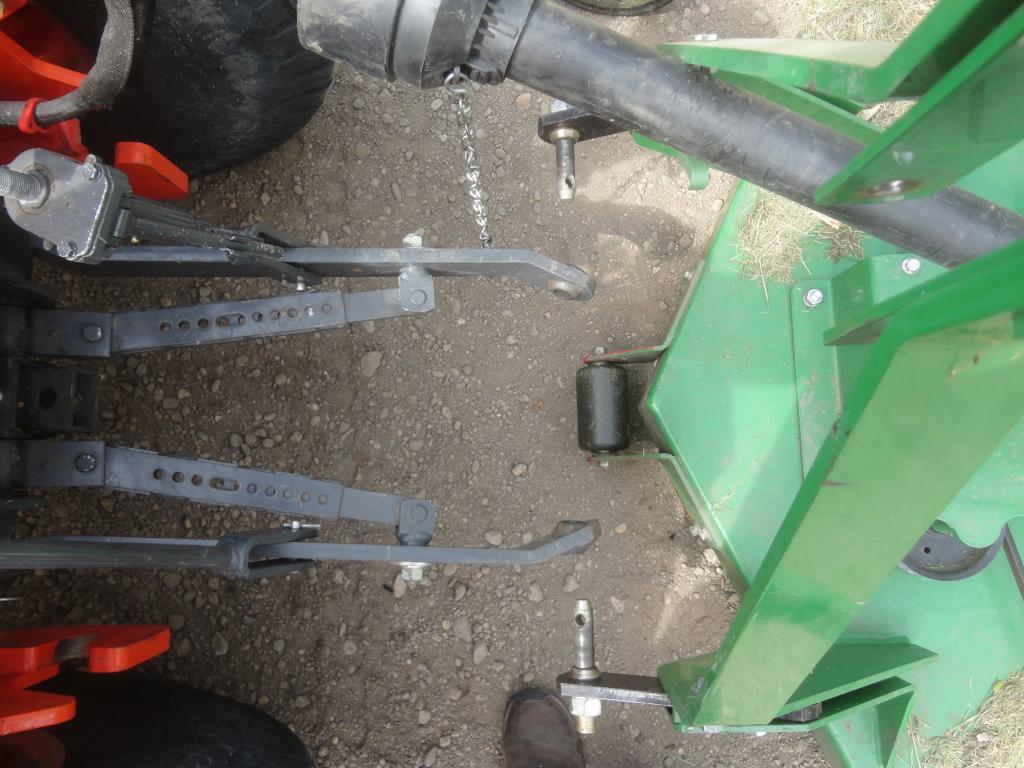

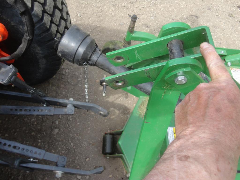

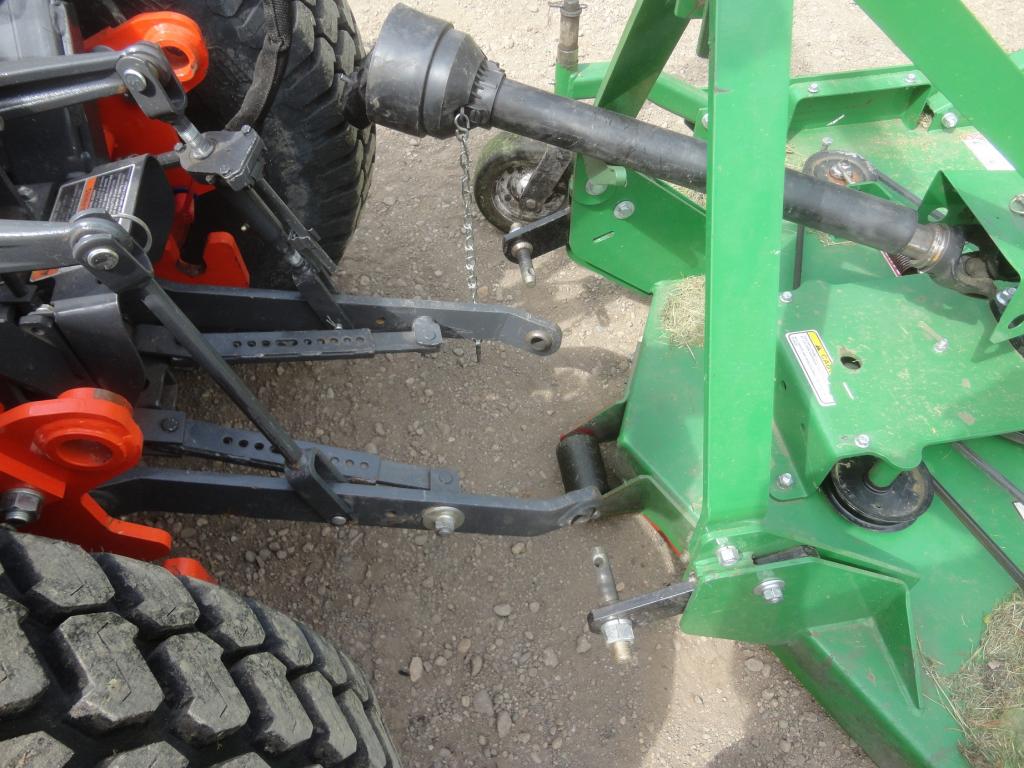

This afternoon was spent on some outdoor work including mowing, chipper/shredder use for mulch, and using the pine needle rake to fluff up some drown-out grass patches for over seeding. Before beginning, I started to think about my earlier claim in this thread that it takes but about 3 minutes to hook up my Bush Hog RFM. Had I been dreaming or was I in La La land with those claims on my 3 point implements for the B2650? :) Since my I-phone has the stop watch, what better way to find out but to time the hookup. I wasn’t going to practice and didn’t. I would start timing right when I had backed up to the mower and stood up from the tractor seat and stop timing when the mower was completely hooked up.
Well, I was off by over 30%. But I was a little nervous and even dropped a lynch pin for one lift arm. With everything hooked up (PTO, top link, side links, sway pins and safety chain) when I hit the stop button on my phone it registered 1 minute 58 seconds. I thought it was going to be under 3 minutes but was surprised it was just shy of 2 minutes. So, while mowing, I thought afterwards I’ll take some pics of my hookup for the skeptics along with some ideas for anyone else to ponder.
First of all, I don’t have a cab on the tractor (I take my homebuilt cab off for the summer). Being reasonably healthy I can look over my shoulder and down while backing up to the mower and stop pretty darn close to the ideal spot for ease of hookup. With the shorter spread of the lift arms on the B2650 it really makes for easier hookup to reverse the lift pins to the inside on the mower itself. It also makes it easy to judge the line up and stopping point when backing up to it. This mower's side links float for a short distance (+/- 2 inches) up and down so all one has to do is pull the pins on the sway bars and move the lift arms outward to match them up with the pins. Top link hookup also swivels. And lastly, on my B2650, putting the pto selector lever in the MID PTO ONLY position allows the tractor pto stub to rotate for 90 degrees stop to stop, making it easy to match the pto shaft to the tractor for hookup.
Here’s some pics that show those features. (Sharper eyes might notice that I don’t have the pins in the anti-sway bars. I had disconnected the mower and then remembered to go get my camera for the pics and I forgot to put them back in. But they were installed for the one “timed trial” run for hook up.:))
So, for a 60 inch RFM on a B2650 compact tractor it really can be that easy and quick to hook up. Removing it was even much faster. If anyone is interested in seeing my mods and quick stands for my pine needle rake, I’d be happy to take some pics and post them too. Very easy on/off also, as it’s standing at the ready to be hooked up and left standing when unhooked. And for the still skeptical I’d be happy to have my wife take a video of the process on my phone and could send it to you. Of course you’d have to PM me with your contact info. But seriously, I’d be happy to do that. It really can be that easy and shows that if you need to be swapping out implements to use where you can’t have a MMM hanging underneath your tractor you might like the RFM. Either type mower has their advantages and disadvantages and should be considered for your own circumstances.
And best of all, I can rest easy tonight knowing I hadn't unintentionally embellished my 3 minute claim for hooking up my Bush Hog RDTH60 RFM. :D

I'm not finding that in the manual? Only the lifting arm once the deck is removed.
Please advise as I would love to know other than making my own.
