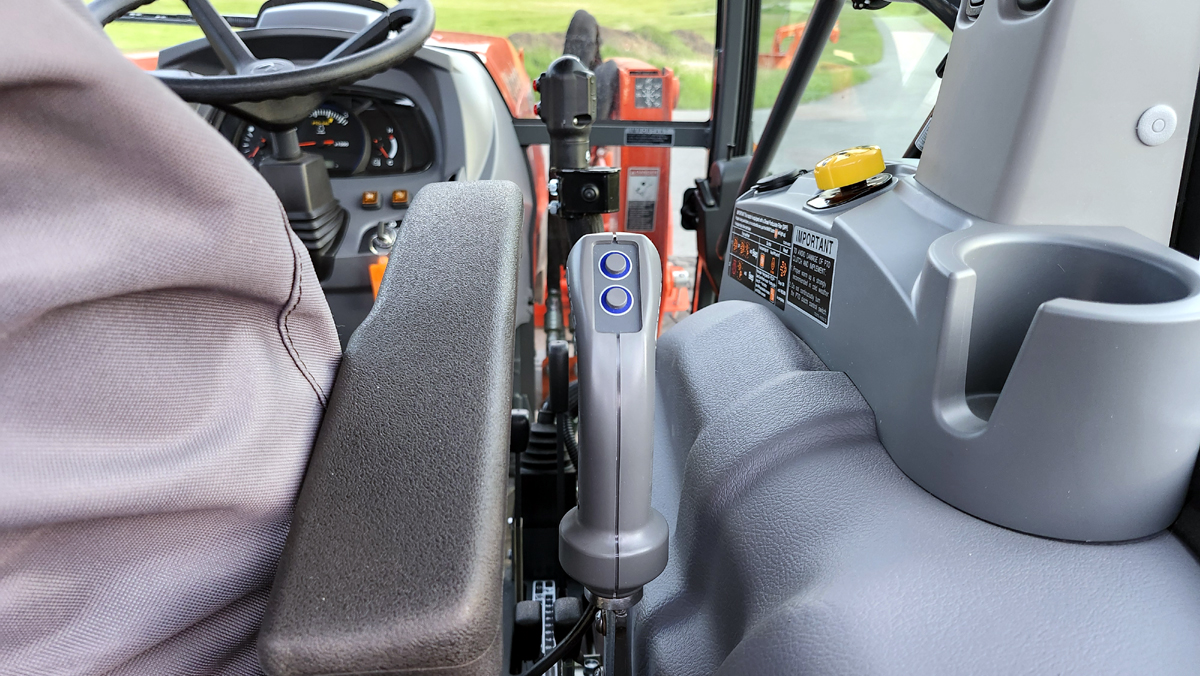

@Blue76, I've been running a ditch bank 62" flail mower on my MX for four seasons now. I have to say, running the cutting head rotation (angle) and cutting head offset via two momentary buttons on the same lever in the cab is a huge improvement over how I used to run the flail. It's way easier and more ergonomic. I did add flow restrictors from @Kennyd4110 but plan on drilling out the orifices to the next size up, and keep opening up the hole until I like how the flail reacts. It's ok at present but a bit slow and the pump seems noisy.
I have the other two factory rear remotes connected to the top-n-tilt cylinders. There's never a need to adjust more than one cylinder at the same time even though it's possible. The Scorpion control grip shown below has a trigger on the front to control the third pair of remotes on the Summit Hydraulics multiplier/diverter but I'm using the top button for head rotation and the bottom button for offset.
This winter I'll control snow blower chute rotation and deflector angle via the two buttons on the control grip.

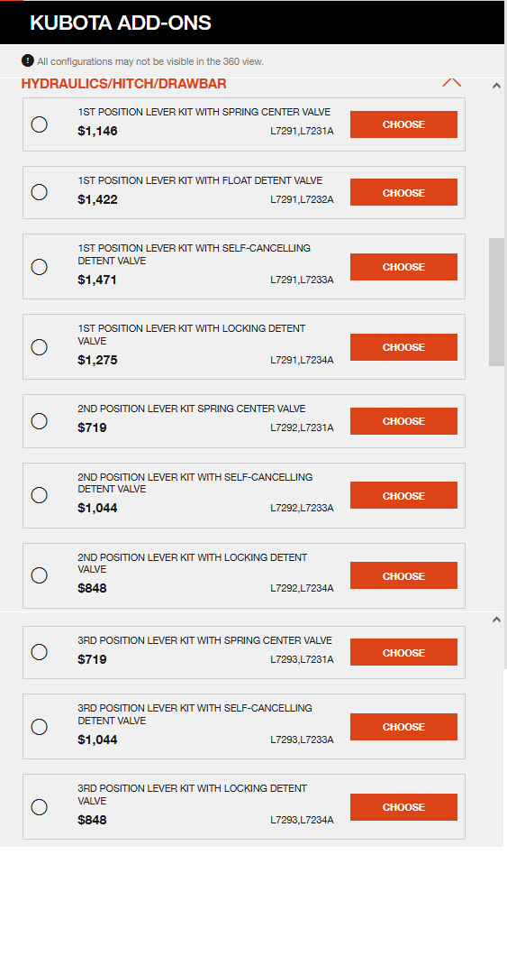

Dang... I called two dealers and both told me $1000 in parts and $500 installed. I am sure I could install it. The $1000 threw me off. Maybe I am asking for the wrong parts at the dealer? I simply said I wanted to add a second remote to my L2501.

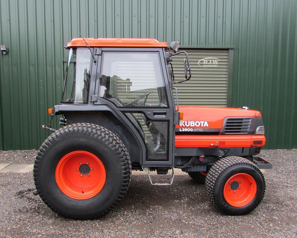

Oh ... so not a fancy L3600 with cab! 😂😂 Come on! How cool is this tractor?
I used to wish for a cab on my L3600 back in the hay field days... Tractor still runs good but pretty much everything else is worn out. It is relegated to bush hog duty most of the time.
I would mow, Ted and rake with the 3600 and my father in law would show up with a Ford 9600 with a cab and roll it. He was riding in luxury compared to me.

These prices are for the L2502 but probably the same for the L2501. Buying through sales rather than parts is a lot cheaper, but Kubota sure is proud of their add-ons. The labor charge is fairly typical too. That's why I suggested a Summit Hydraulics 3X multiplier since you already have one pair of factory remotes, but Dan has another option for you, and options are good.

The valve is $250. The full stacking kit with valve handle, studs, hoses and couplers is $450. So $700 in parts total and that includes all hoses and fittings and probably a better choice than trying to go ala carte using off the shelf bits to save a few bucks.
Installation is not hard but its a little cramped working in that area.
One word of caution. Kubota used at least two different valve stacks. The prices I am quoting is for the current version where the hoses for the outlets connect to the underside of the stack. The older version had the hoses on the top side and is probably hard if not imposdible to get.
