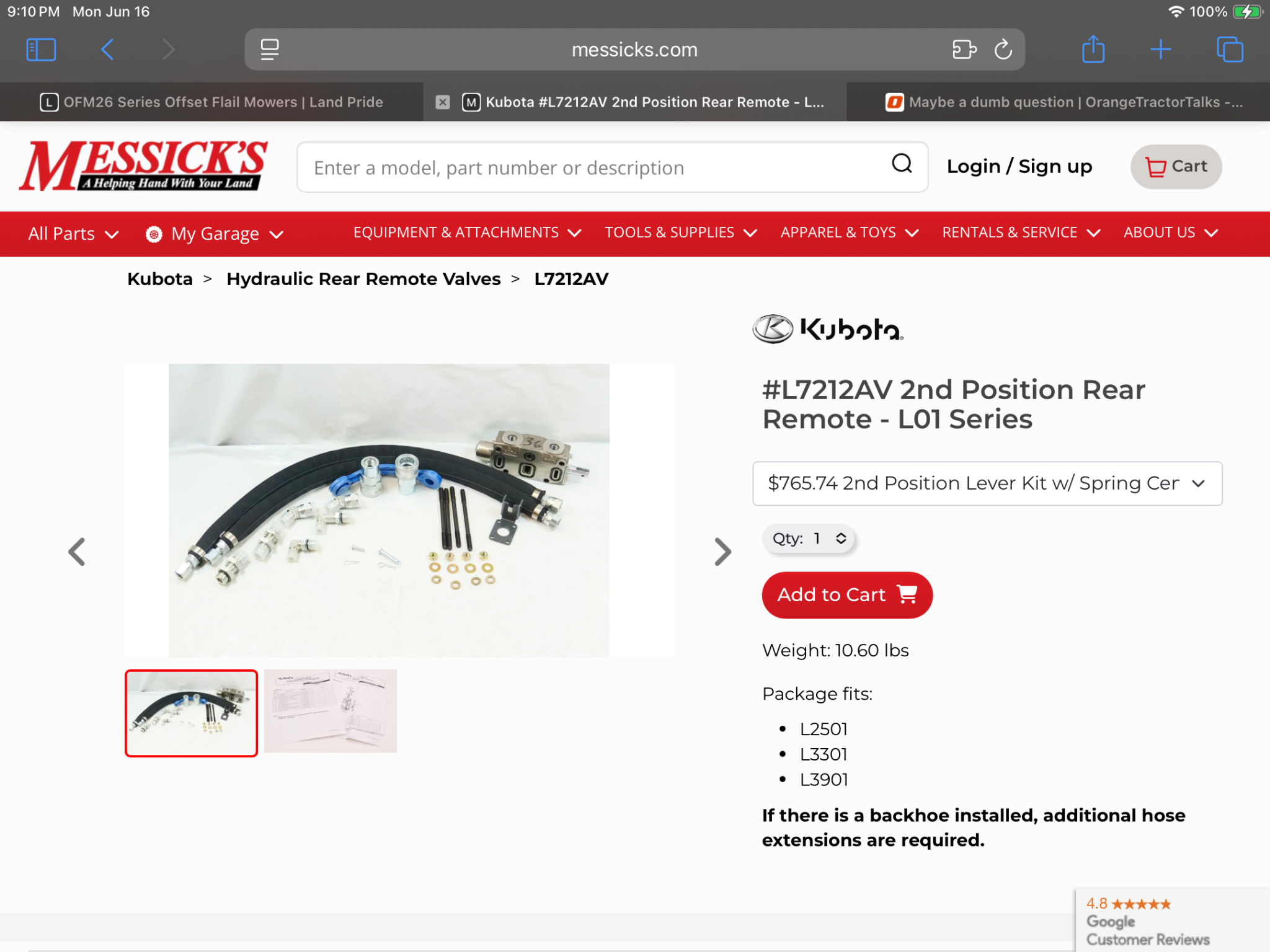

like this one?

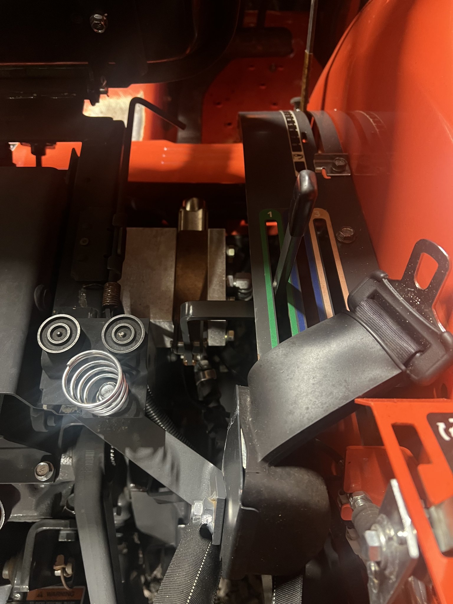

That could be mounted either way but I think itz the old stylekit. Tilt your seat forward and post a picture of whats on your tractor.
assuming that is the correct kit. What else is required? I don’t see a shift lever in the image.
I will take a photo.
