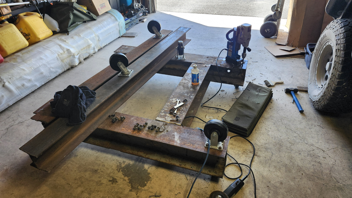

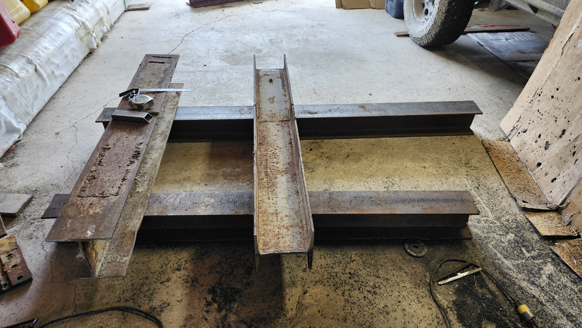

I need to remove the 150hp Yamaha outboard from my boat and store it for a while so made up an engine stand today. I used some nasty, messed up old steel that I bought from a farmer a couple of years ago. I got a lot of decent H-beams from him that I'm saving for more important projects, but my plan when I'm done with the stand is to remove the "transom" and add another cross member and use it as a heavy duty cart or dolly.

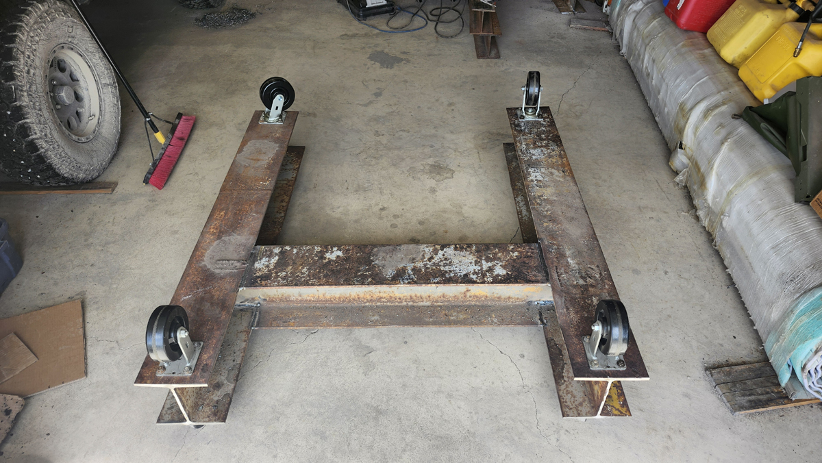

The mag drill once again earned it's keep. I had to drill 20 holes in the steel and the mag drill made fast work of it. The base is so heavy that I had to put the MX to work in order to flip it over onto the casters. I used some heavy duty casters and this thing rolls around with little effort. I have a little more welding to do tomorrow morning and will most likely add two gussets inside the cross member and beneath the uprights to stiffen the beam. The outboard weighs around 500lb so better safe than sorry.

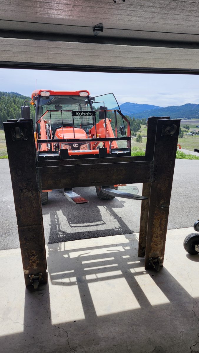

The uprights are drilled for bolts to support the engine, and if I got the math right I should have about 6" of clearance between the bottom of the lower unit and the concrete. The bolt pattern for outboard engines is basically a standard today with most manufacturers using the Johnson-Evinrude bolt pattern. That's the pattern I used for the four holes on the uprights.

OMG>>>> You could move an Abrams engine on that stand!
I'm going to put the load rating at about 10K possibly higher
Yes the casters won't hold that much of the load but the frame will.
I've got a set of casters here that would handle it!
Nicely built!
5,825
3,099
Yep…very pretty welds and work.
I’ve used those same casters on a 300 lb generator…and after 4 years of mostly just sitting….the plastic wheels deteriorated and simply crumbled. I suspect all-metal casters would be necessary for long-term use of that H.D. outboard-stand.

The W8 beams are probably 360lb and the uprights are probably 100lb so around 460lb all in.
I've never removed an outboard and don't think it's something I'd do again. I'm pulling the 150hp off so that I can put the new 200hp on after I've completed some other upgrades that will be easier to do with the engine out of the way. I plan on selling the 150hp at some point so it will live on the engine stand until it's sold. It only has 267.2 hours on it. I made a lifting eye today that will bolt to the flywheel. I bought three 12.9 8mm cap scews yesterday and had to cut them down a bit to get them to work with the lifting eye.

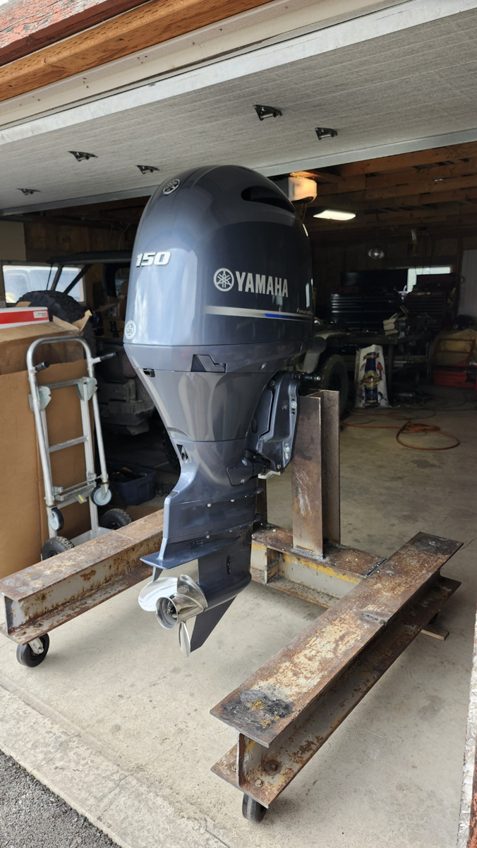

The F150XB is on the stand and all is good.

Looks great.
I love those Yamaha 150's for their legendary reliability. (y) (y) (y)
