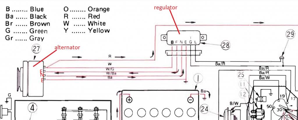

I have a m8950 and recently the charging system on my tractor is not working. It is running off battery power alone. I've replaced the alternator and still only getting 12v at the battery when running. Is there a inline fuse or perhaps an external regulator on this tractor? Also if someone can give me information on buying a repair manual that would be great.

From looking at the wiring upgrade for a B7100 which is of the same era as your tractor I believe you have a voltage regulator.
The three terminals on your alternator with letters E, F & N correspond to three terminals that would be on the regulator.
Do you see anything that looks like this regulator on your tractor? The 3 wire connector would have some connection to it if it exists.

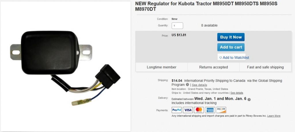

For $14 I would be inclined to buy a new regulator since you already bought a new alternator.

Please read my post #5.
The 12 volt signal to start producing power goes to the voltage regulator not the alternator.
Dave
After removing the side wall from the dash, I found the problem. The regulator was unplugged. I'm guessing it somehow got stuck to the clutch linkage and whenever the clutch was pressed, it unplugged it. Thanks for the help. There is still one problem though, the battery light is still on, on the instrument panel.
