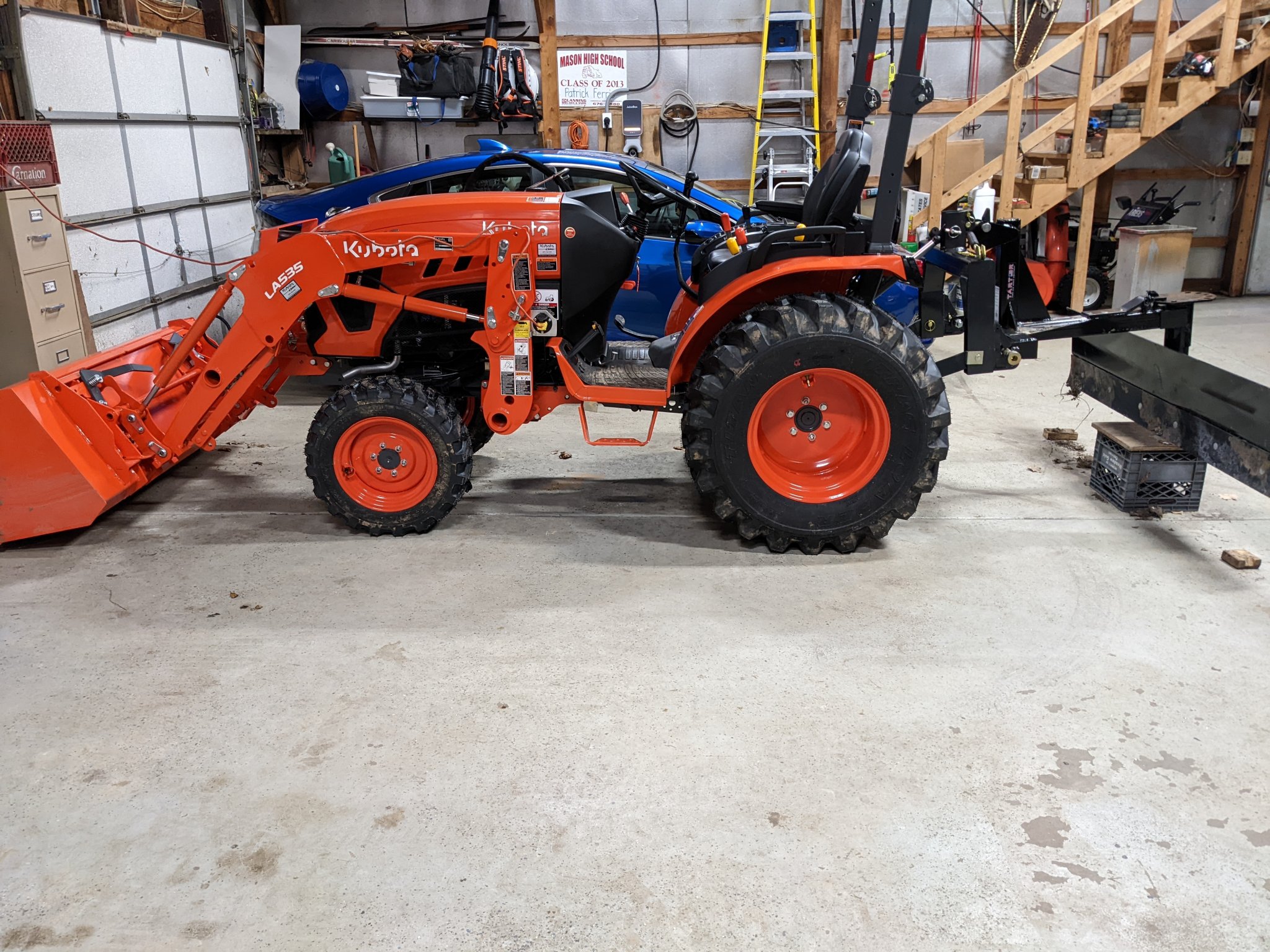

Just a quick comment... I have a LX2610HSD with the 15-19.5 large R4 tires (I did not want the R14's). Yes they are higher but they also are much wider and to overall rear width is just under 60".
They hold nearly double the beet juice for ballast 310 lbs per side.
I find the tractor much more stable with them than my old B7510 a tractor that had a much lower center of gravity.
As to the steering stops the configurator on the web says they are needed but mine does not have them. I have zero issues with any interference in turning.
Attached is a photo to show the fender clearance. For a height gauge it's a gen 2 Chevy Volt in the background.
Yes, the MMM is not compatible with the large R4 or R14 tires as the tires hit the mower deck.
Also the tractor weights in a 3555 pounds as show in the photo. I have not gotten much snow yet this year only about 5" or so at a time. I have only used 4wd once to get over a snow pile.... rest of the time I have not had issues plowing in 2wd.

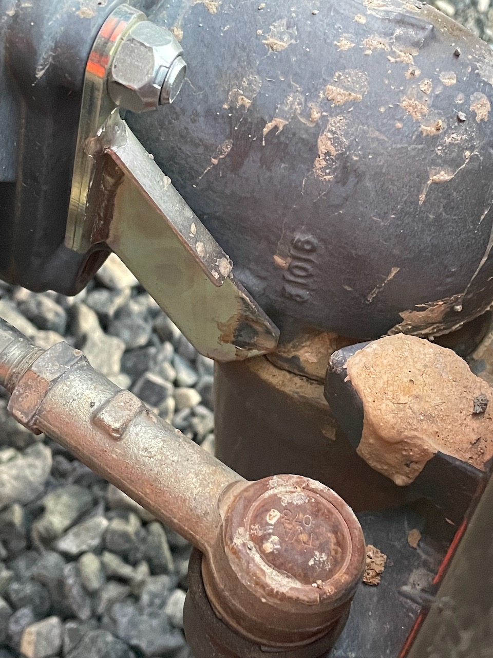

I added the steering stops when I put oversized tires on the front of my B26. I was worried they would cut down on the steering radius, but that wasn't an issue. The stops are just a little less than 1/8" spacer that goes on the front axel stop. $25 from Coleman Equipment, part# B4573. I can't tell the difference when I do close corner work around the garage.
