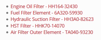

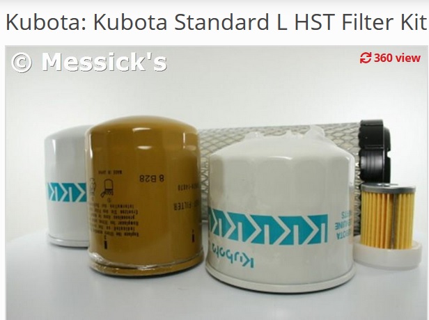

Fordtech86: Your photos had me going for a minute. I was trying to figure out why a loader valve with only 80 hrs would have so much crud built up then I re-read the post and realize this was YOUR valve.
Rdpoole88. Tx Jim's point is relevant in all of this. Do your further pressure tests with the 3 pt lowered. Do you have a backhoe circuit?
Who did the fluid and filter change? Were Kubota fluids and filter used.
Please check the part numbers on the hydraulic Suction filter which is the one which would affect pressure by choking the suction side of the pump.

Changed with Kubota filters and mostly Kunitz ud2 hydraulic fluid. I say mostly because I did run out and topped it off with what is advertised as a comparable fluid. Just thinking maybe a problem with the filter or something
