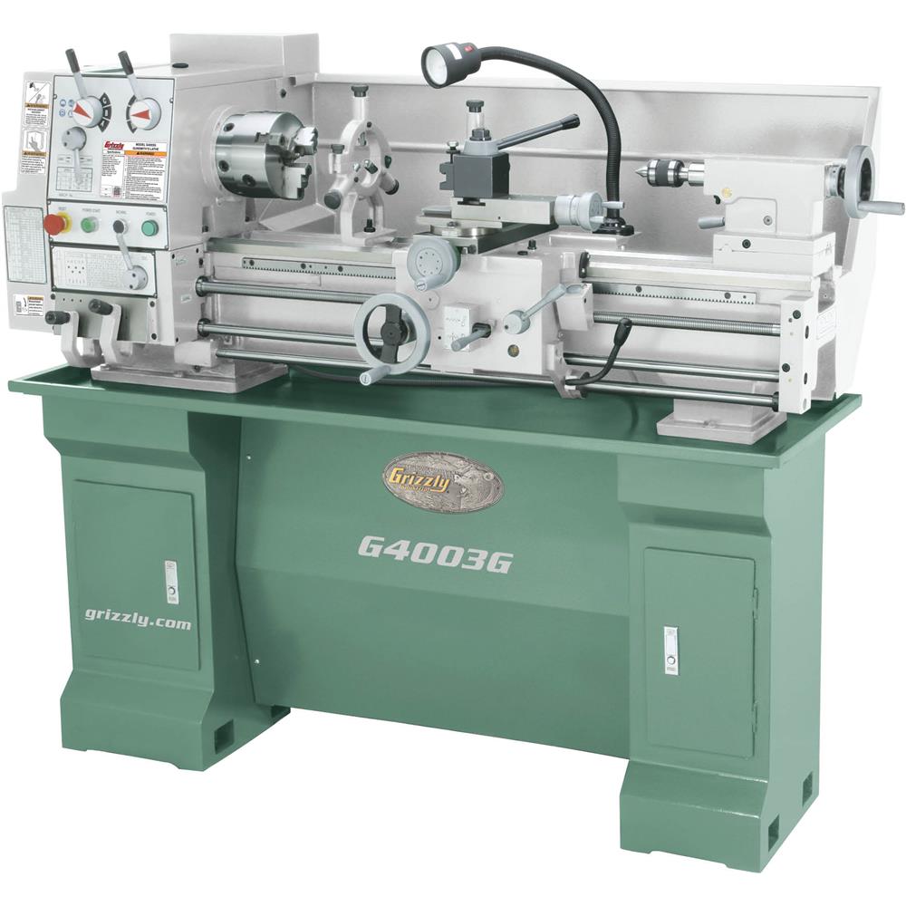

Consider Grizzly also. It is based on the Birmingham design, & it is currently in production, where the Birmingham is not anymore.
I particularly like their "gunsmith lathe".
Too many to list. Acra, Acer, Sharp, Victor, Willis, Kent, Precision Matthews, Birmingham, Cadillac just to name a few.
For a HSM any of the 16"/3000# or bigger machines is going to be more tha acceptable. In the 12"-14" and under not so much.

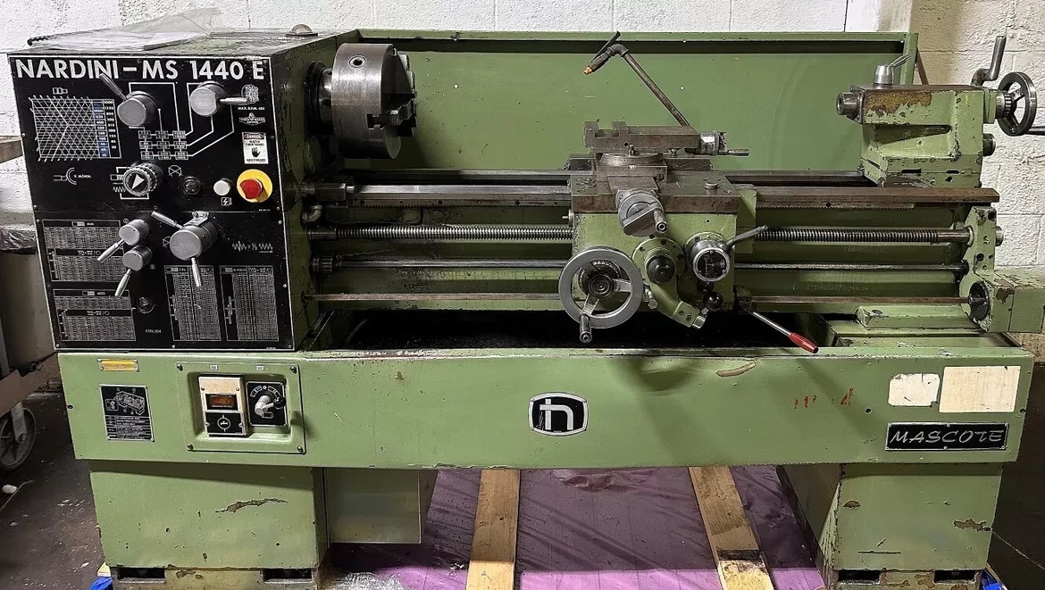

We have that same Nardini lathe at work. It’s a solid machine. It will cut Inch and Metric threads but I believe it requires a gearing change. I’ve only cut threads on it a time or two.
My only gripe with it is that the chip pan slides out the back so you need sufficient room behind it to empty the pan.
