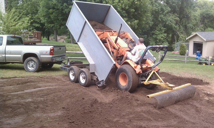

Are you kidding me!?!? Out here you couldn't touch anything like that for twice the money! Man, I gotta make some shopping trips back east…..
Actually I got the trailer for less than $700 if you want the truth! The guy sold it to me for the price he had into the metal sides that you see in the picture. I got the whole deal for $660...then bought 4 brand new 8 ply Carlisle trailer tires for it, replaced the hub seals and cleaned up the brakes, bought paint and painted it, built a tailgate for it, put some tie down anchors in the bed, put some new lights on, re-wired the pump switch, and got a free newer Mercedes diesel battery which a customer had wanted replaced but was still perfectly good.
I know this trailer would go for about $4-5k used around here, I just lucked out on Craigslist!

See is the the other key problem I don't like about a dump trailer. Hardly any of them are built to the right height or bed lenght to raise the bed up in the air and get the entire load to completly dump out without burrying the end of the bed in the dirt. You shouldn't have to drive a tractor up it to unload it all the way. And who has time to shovel by hand?!

I'm in no way trying to nitpick or being an asshole here but the above photo Billdog350 is more then likely putting more weight onto the hydraulic cylinder then its probably capable of supporting, thus running the risk of breaking the trailer alto crap. Potential for the cylinder to fail and come crashing down with his tractor like that resulting in injury.
Also his landscape rake is maxed out and stuck on the ground with his tractor at that angle running the risk of breaking the rake or trashing the 3pth hitch. But these are the things people have to do with a dump trailer to get it all out. NO THANK YOU.

Eric, you have a real bone to pick with me for some reason? I don't recall going after you ever on this forum.
In regards to your points above, I agree that the DROP AXLE trailer isn't ideal for dumping loads without having to move forward, however it is THE BEST to haul a machine around with! A normal height dump trailer would dump better but put the machine another few feet up and make it tippy around corners. Its the best compromise for my situation. Easy and safe loading+transportation.
As far as being high enough to dump a load, that was a load of very wet topsoil that would have stuck in a dump truck too. I know because a pickup came and delivered the first load at the same location. All other dry materials dump out of the trailer perfectly.
The weight of my B9200 would hurt the cylinders? Come on...that's a 10000lb rated trailer (I have dumped over 12k) and the tractor weighs 1800lbs plus the FEL and rake. Call it 3000lbs. No way that's straining the trailer or cylinders. Make sure you know what you're talking about before you start spouting uneducated comments.
Yes the rake was bottomed out but I could have adjusted the top link...I was able to get the load off the trailer and it all worked out great.
To summarize the original intent of my additions to this thread. The OP asked about dump options to avoid CDL and my suggestion was to save money and maintenance and go with a plow pickup plus dump trailer. Eric and others have suggested getting a dump truck. Some have suggested specific models. Overall there were multiple suggestions and reasons for each.
I'm not here to piss in anyone's cheerios. I'm here to provide suggestions which some may benefit by, and if some have other opinions, I'm happy to hear them as well. There are more than one ways to skin a rabbit.
Peace and have a nice day.

Billdog350 I'm not trying to come at you directly but use your photo as an example to others. Ok fine and dandy the cylinders are rated for 10k, still having the bed in the air and driving in and out is NOT SAFE. If you feel comfortable with it then thats your thing. Running in and out with no side to side stabilitly can and will cause the trailer to flip over.
And Fordman your tailers are about the only dump trailer I've ever seen built right and has the rear end height like a deck over trailer to allow it to be fully raised and not dig into the dirt.
