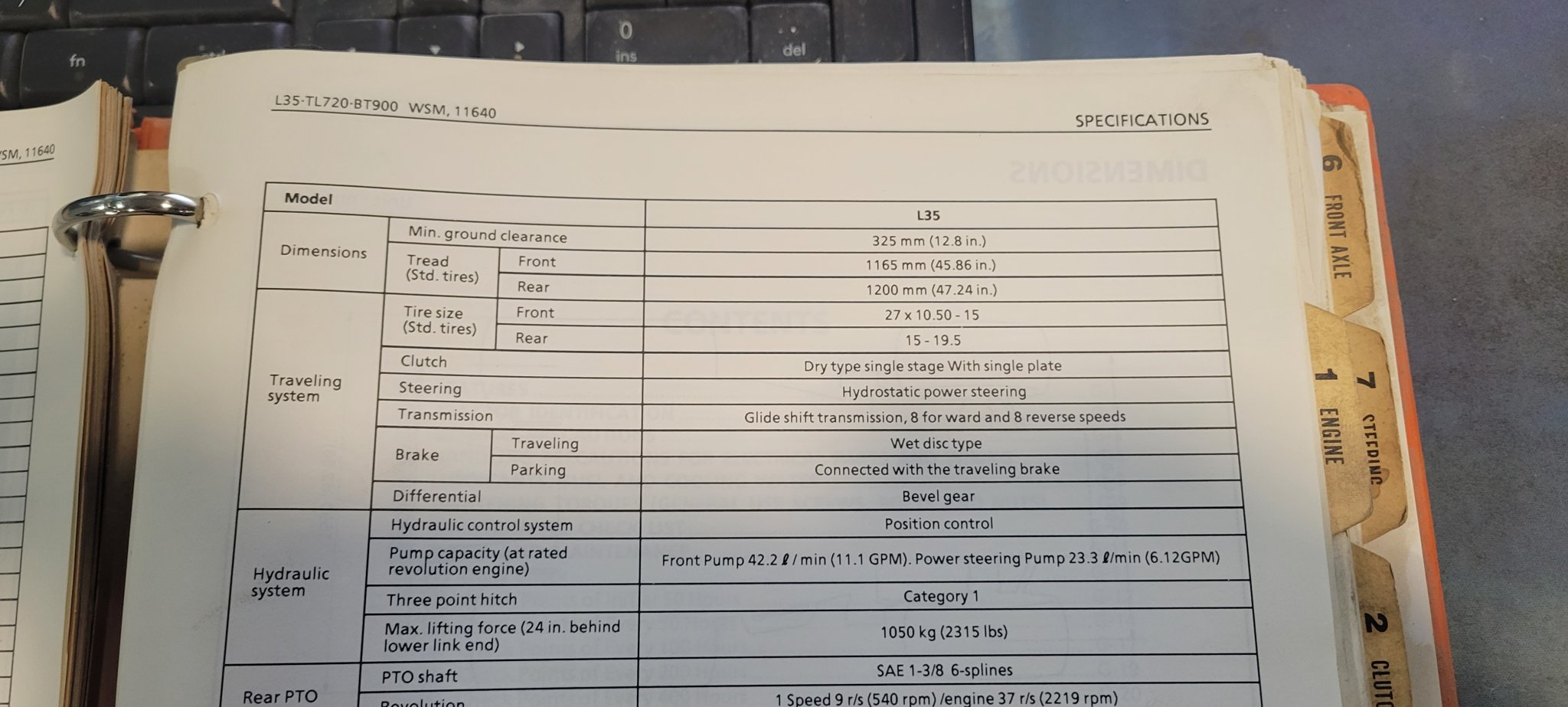

Yes and correct me if I’m wrong but my bucket functions would also be reduced to 13 gpm due to the diverter? I don’t really know how much power I would lose on the lifting arms.Did you read what I wrote?
Well you just made my life easierYou only have 11.1gpm for the loader to use.
So putting a 13gpm third function valve in is not going to reduce any flow to the loader at all.
The other 6.12GPM is on a different loop, that loop runs the Steering, Three Point and the GST.
And fyi GPM is not power, its speed, PSI is power.
