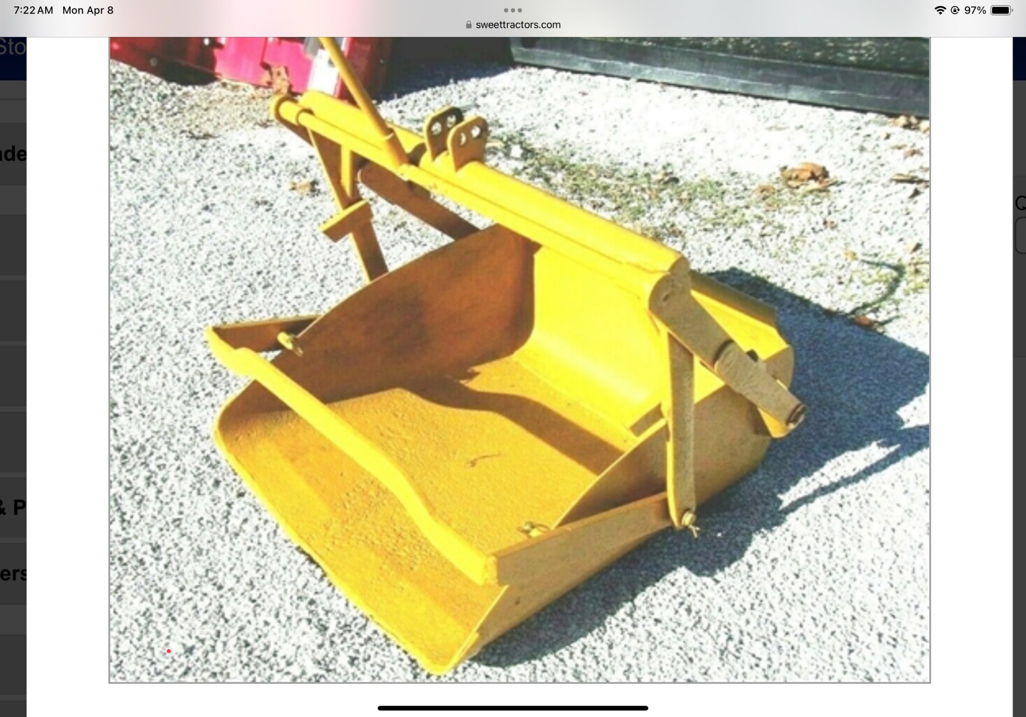

I used to have a Dearborn Pond Scoop which faced backwards …and is how I’d skid a log.
(this is a pic of a pond scoop…not mine…just a pic I found to illustrate …the idea of using an old car hood…or sheet of tin…etc., is a good one.)

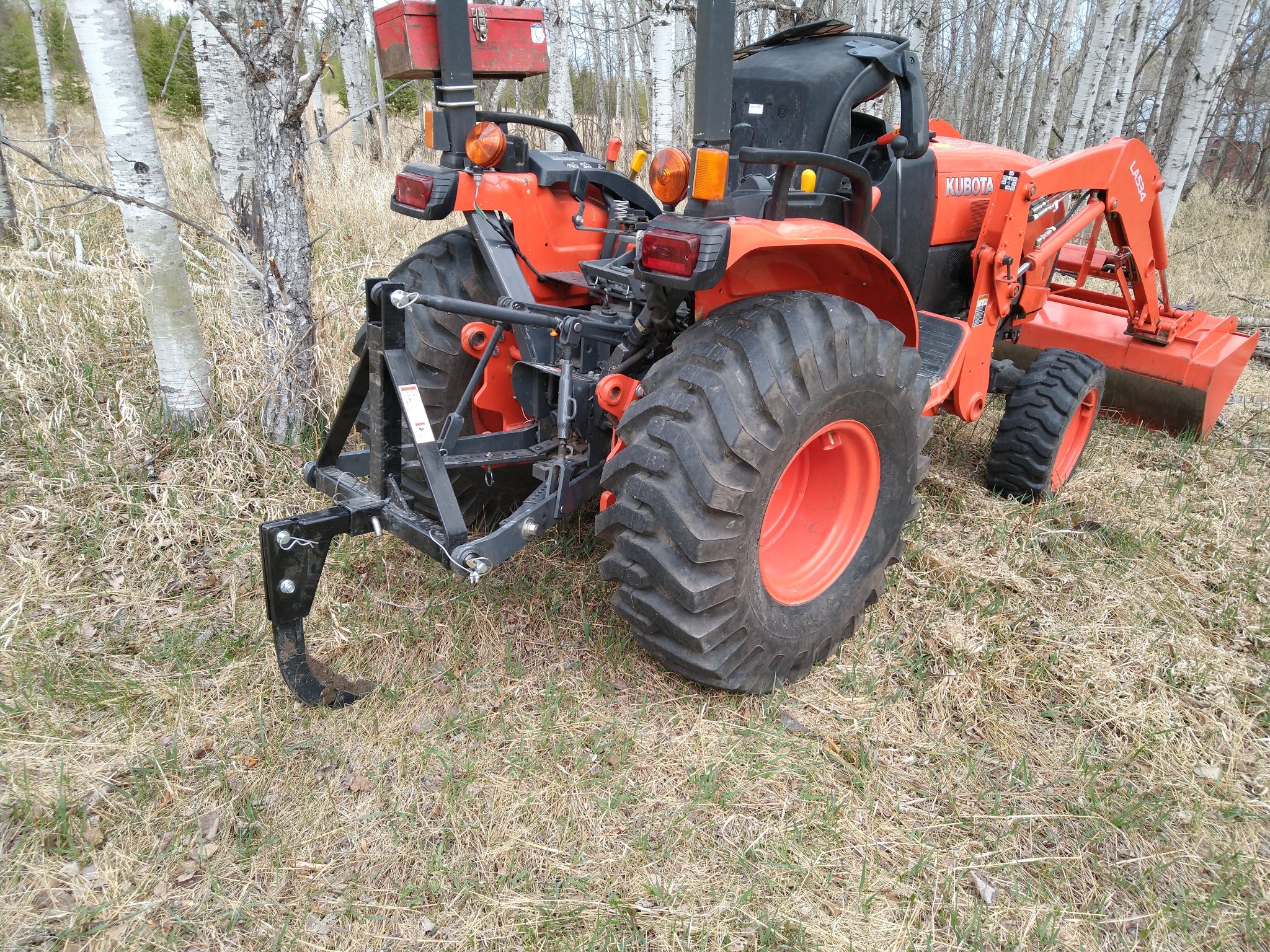

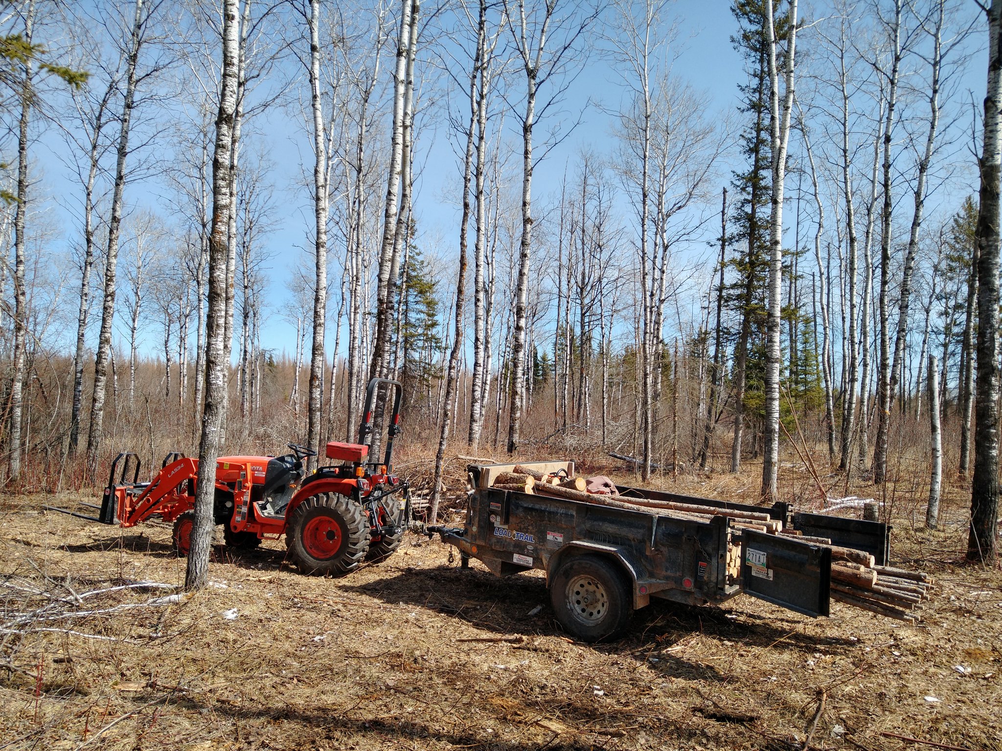

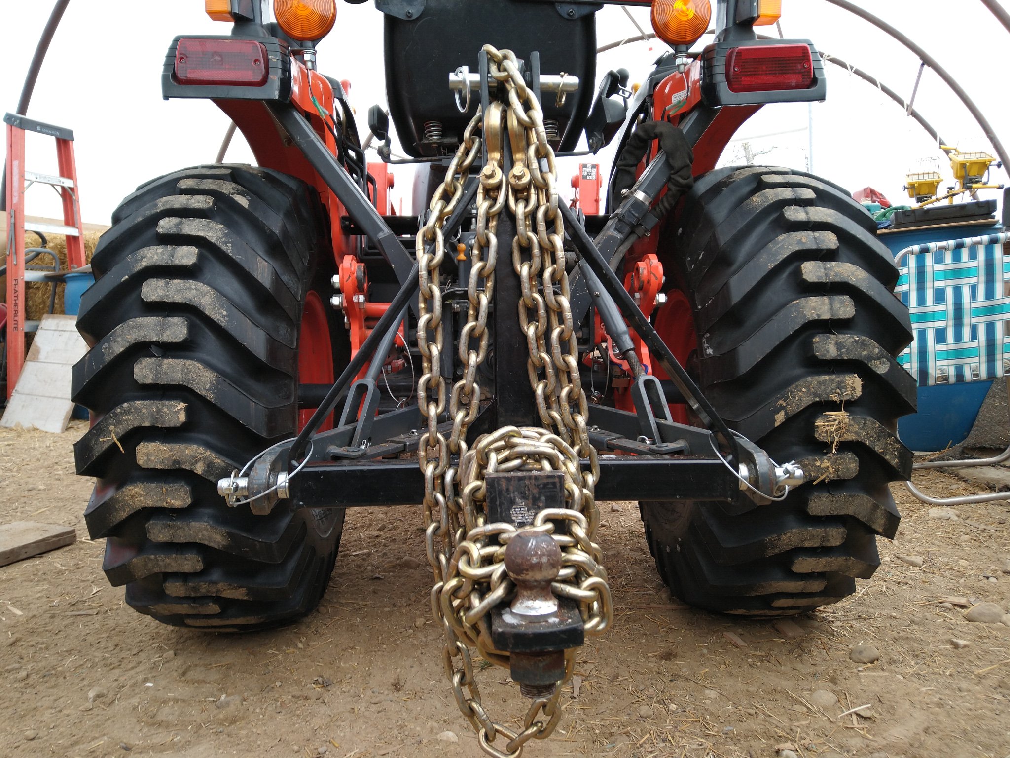

1/5 the price of your somewhat schmancier unit, and besides the 2x2 receiver being included in your unit, this one does just fine doing exactly what you'll need. I got one of these 4 years ago, has been put through the ringer chain-hauling logs out of the bush, and hauling heavy trailer loads of timber etc. Just needs a standard auto receiver hitch with ball.
I also got a 2x2 receiver type single-tine sub-soiler/ripper to use with it, works great.

I use the 2x2 receiver with ball and chain up as tight as possible to the top of the load, then raise the 3-point only enough to take the weight of the load off the ground when dragging. I've hit a number of solid obstacles doing this and the tractor's feet remained planted.

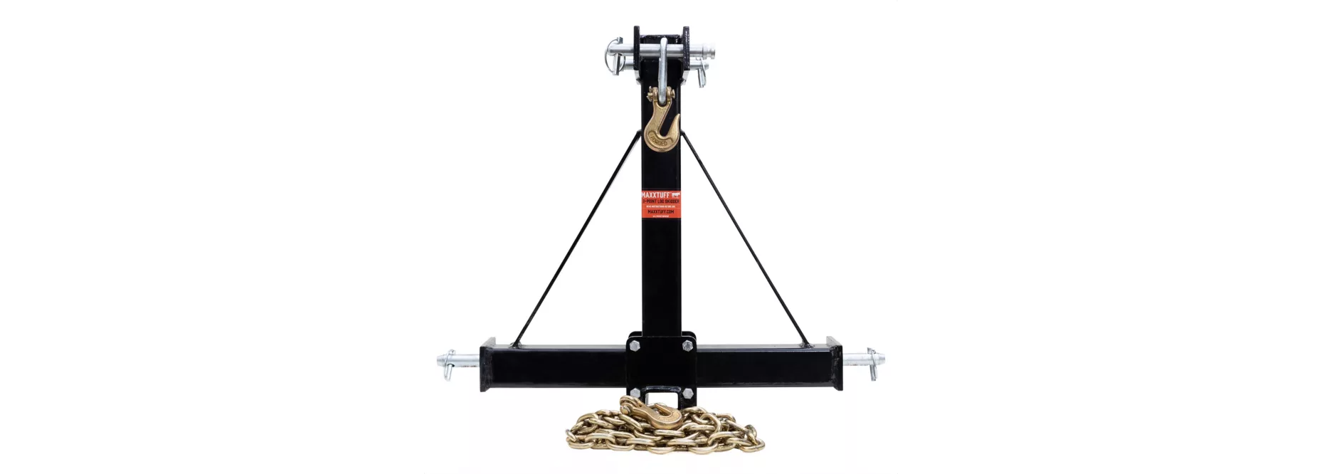

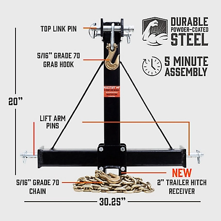

This is the Tractor Supply model I have. I like the hook up top for chains. I understand the potential risks that come with skidding logs. Personally, common sense goes a long way in these situations. Nuff said.

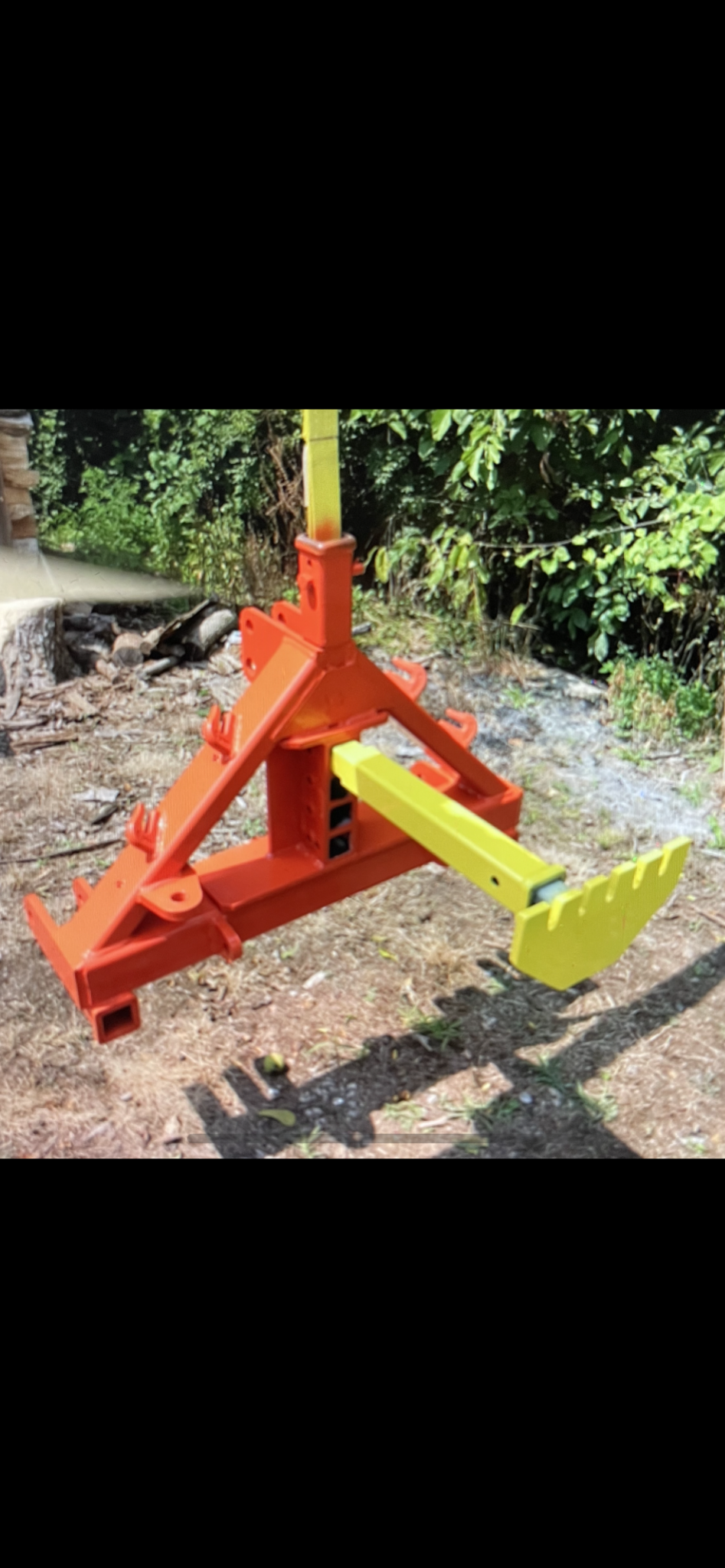

I think the skidding winch/plate is really the correct tool if skidding a lot logs with a compact tractor (and some have a receiver too)…an arch might be nice as well if not wanting to make a mess or get dirt all over the log.
Until the spousal unit buys me one (this could be the year😉), this (see pic below) is what I have come up with for MX…I have a much simpler one for the B that is a basic triangle tube style with a receiver for a 2 hitch which works just fine.
I think a skidding winch/plate would make decent ballast as well, and if that would allow fewer attachments to have to step over/around in the barn that would be nice.
The problem with just the triangle is that not much weight and if using the loader, I still need the ballast in the woods while working. So until the spousal unit buys me a winch, I use the BB until time to skid and then I switch over to the triangle. ☕
What is at the top of the triangle? It is cut off in the picture. Inquiring minds need to know! :giggle:
GrumpyFarmer
3,005
4,006
It was just zoomed in…that is the day I painted it and I was holding it with that strap (simple hitch pin holding thru the loop)…strap is looped over forks on the B outside the picture frame.

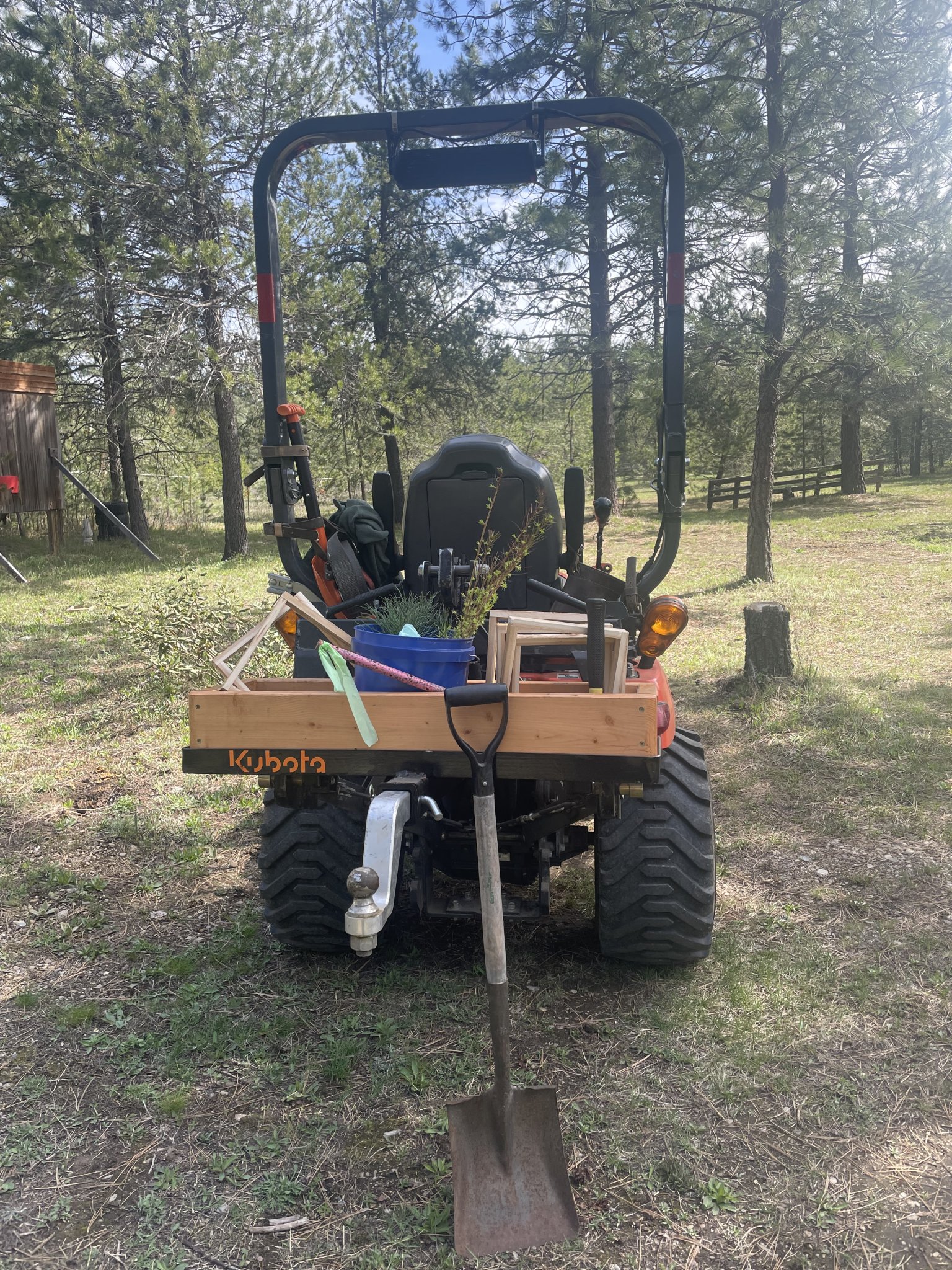

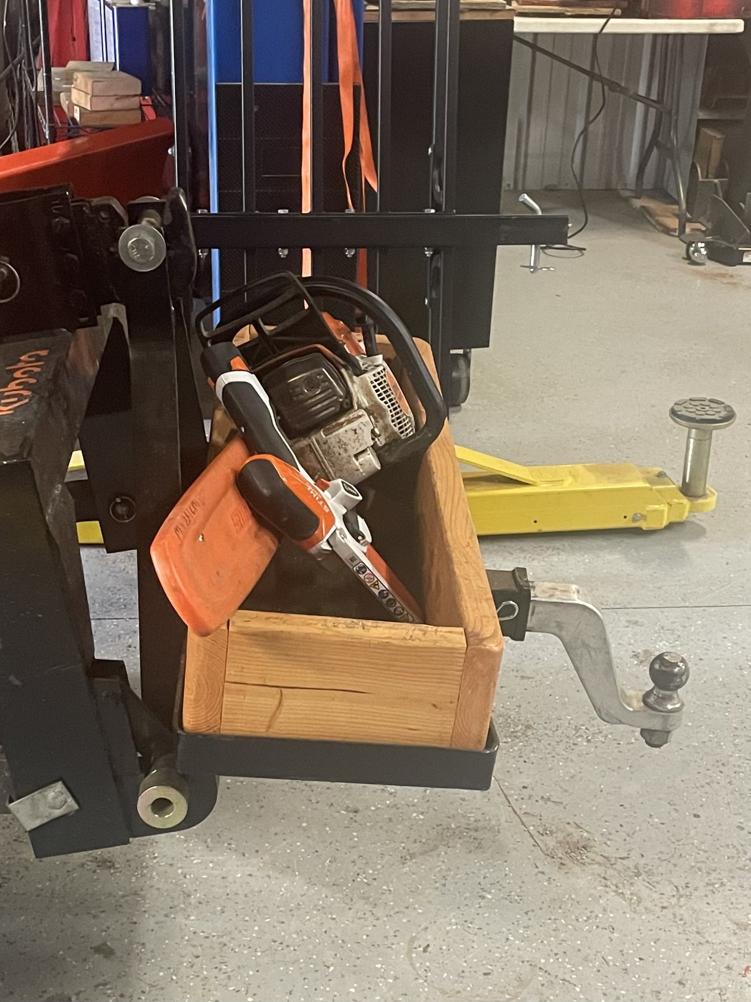

Just saw this, I have 2” hitch receptacles on a few 3 point pieces. I haul my saws around when I’m grappling up branches and brush. Good for planting tools too, then I can go move trailers around, or piggyback an attachment to it.
