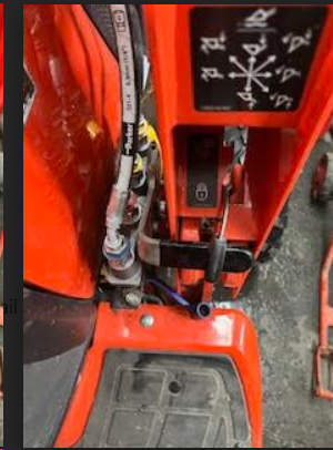

I lhave a BX2380 with a LA3444 loader. Only 50 hours on the unit. While pushing snow, I heard a "pop" and the loader would not raise or lower, and the bucket won't tilt. No response from any position of the control lever. I checked all the lines and can find no leak. Oil level appears to be fine. Three point hitch raises and lowers. Any advice on what to look for or what might have gone wrong. Thanks.

I
I can't detach the hydraulic couplers due to the location of the release handle against the lifter arms. Is there a way to move and detach the lifter arms without the use of hydraulics? Thanks,

What are you trying to accomplish?
Lifter wont respond to control lever. No visible hydraulic leak. Recommended fix is to remove couplers and reseat to see if there is a leak. But I can't move the handle due to location next to lifter arms.

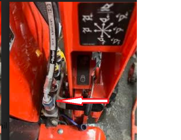

I'd move the loader frame lever to the 'unlocked ' position...
unlock the 4in1 coupling lever..and then lock it down.
I suspect it's not properly seated.
On my BX23S that lever is horizontal, yours looks 'up a bit'.

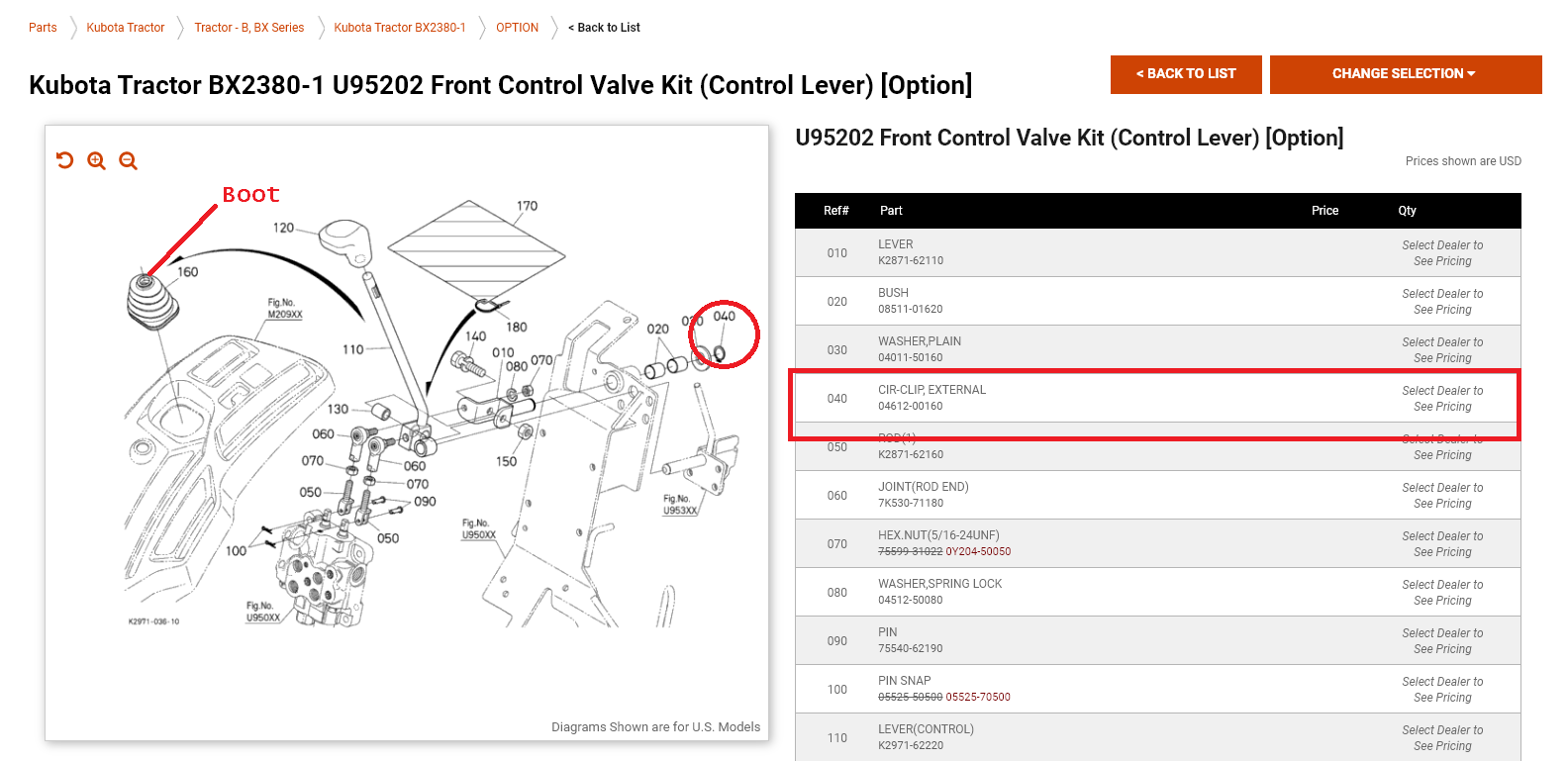

It is in the loader control. Open it up and look around for a clip the has fallen off. It happened to my BX22 and drove me crazy till I found it.

Before you get too carried away just look here and verify this clip is still in place. If it comes loose the joystick will not operate the spools in the control valve. It looks like all you need to do to inspect that is remove the the rubber boot on the fender. My guess is it has a molded lip on the bottom edge that engages the hole in the fender. Gently pry it loose and slide it back up the joystick to expose the linkage.

it may be the picture but it looks a bit 'off' from the handle position compared to mine. Mine is horizontal, his looks 'up'.
zero operation of the loader points to the coupler of the joystick(maybe joystick is locked ?'
mor einfo/pix are needed
Problem solved when I was able to move the connection lever to the correct position (used a metal rod to lever it down).
