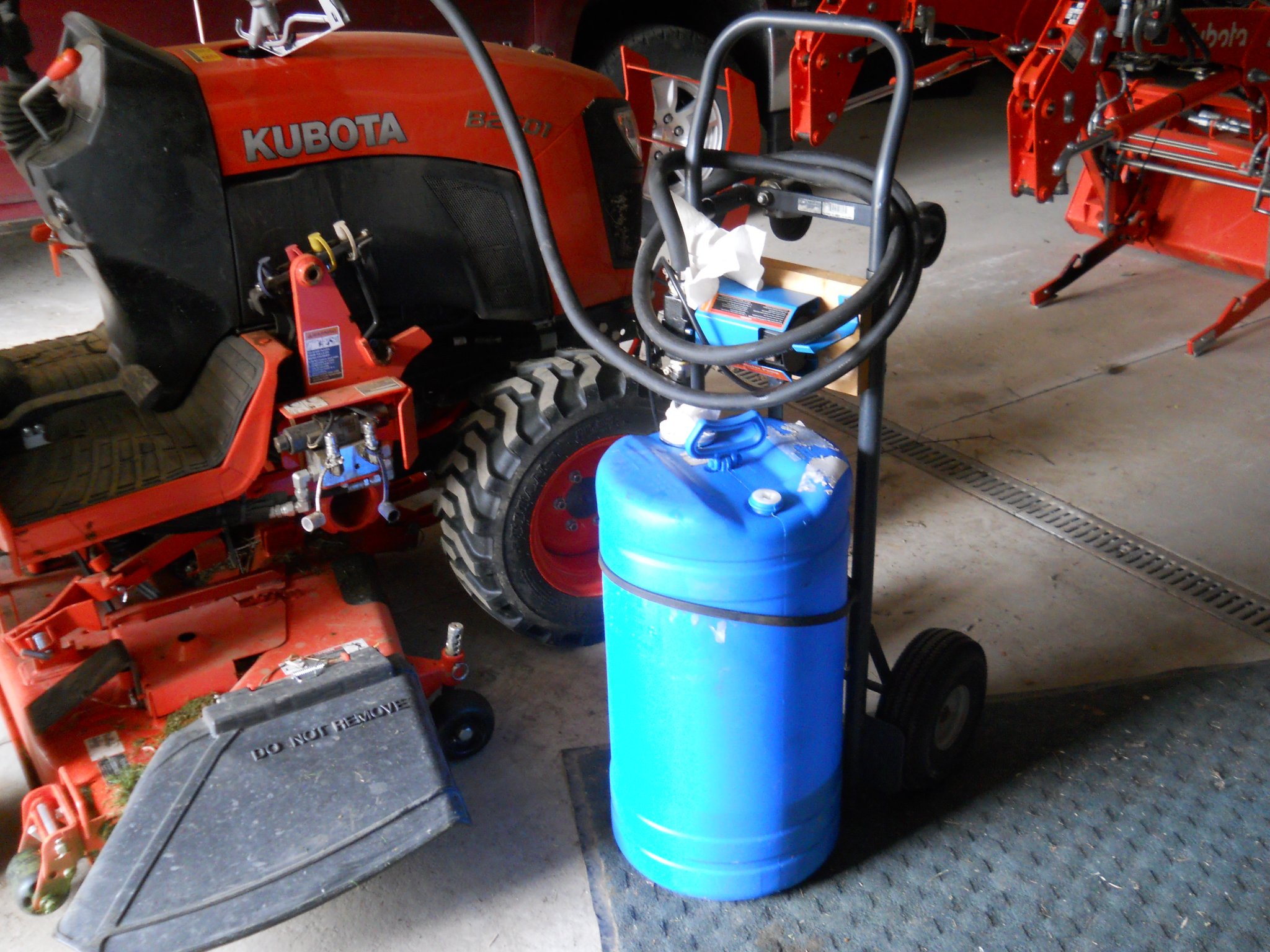

Robert, how do you refill your 5 gal can? Do you take it to the public pump and fill it and then transport it home in personal vehicle? Do you have any difficulties in lifting it during those times?
At the rate you report, you’re using 200+ gallons/year and could consider a seriously sophisticated storage tank and delivery. In my area, the local supplier will deliver 200 gals or more with no addt’l charge. By purchasing dyed (off road) diesel ….instead of retail-at-the-pump …you will easily pay for the system in 5 years or less.
I made my own system using an old propane tank and common plumbing hardware, plus a fuel-hose/nozzle. I run it by pressurizing the tank with shop air to about 10 p.s.i. and fill my tractor as easily as if it were at a public station.
Here’s a link to the post: https://www.orangetractortalks.com/...your-refueling-setup.29684/page-7#post-247691

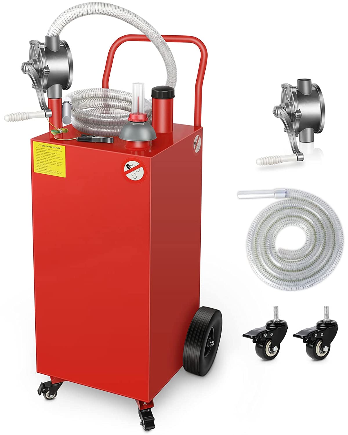

I was given a 30 gallon tank on wheels for gas, now I just have to figure out a pump for it. It has a pump, but not quite sure what to do with it yet as far as mounting and powering it. It is also nearly full of gas.
Tractor Supply has a good variety but a little bit pricey
