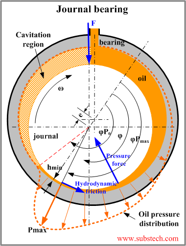

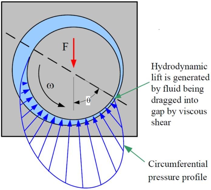

A journal bearing must remain immersed in oil to function. The instant an engine starts spinning that residual oil film is swept away and lost due to shear. The bearing and journal surface are instantly in metal to metal sliding contact - or more technically a condition called the boundary lubrication regime by tribologists.
The several thousand PSI hydrodynamic oil film "wedge" that is needed to lift the journal off the bearing surface will not form until the oil pump delivers enough replacement oil to allow that same rotational shear to shape and maintain an area of high pressure differential. It is that localized hydrodynamic pressure differential that "floats" the journal and prevents metal to metal contact. The same thing happens in reverse when the engine shuts down. Thats why most journal bearing wear occurs at startup and shutdown.
You dont have to believe me. Go read any good (or for that matter bad) textbook on journal bearing theory and operation.
EDIT: The first picture is a little geeky. I added a second that might be easier to understand.

Nice explanation. So when h min (the thickness of the squeeze film) is less than the roughness of the surface (e.g. height of the asperities) then the bearing journal and the bearing surface are in at least intermittent contact with one another for some portion of the surface area between the journal and bearing.

And later you can try to wrap your head around the Babbitt bearing in combination with the lubrication regimes of bearings
good times for the mechanical and fluid engineers!

I dont think any of this is news to you 🤔
That condition is called the mixed mode regime. In a journal bearIng you want to maintain a full hydrodynamic regime where HMIN is never less than the height of the asperities and there is no metal to metal contact.
HMIN is largely dependent on the radial loading on the journal, the rotational surface speed of the journal relative to the bearing, diametral bearing oil clearance, and the dynamic viscosity of the oil.
Slow engine down HMIN decreases and you get boundary conditions
Thin oil out with heat or loss due to hydrodynamic shear force HMIN decreases.and you get boundary conditions.
Lug (load) engine up at low RPM HMIN decreases and you get boundary condtions.
And the nail in the coffin. Over tine bearing clearances inevitably increase with wear, HMIN decreases during nornal operation, boundary and mixed mode lubrication begins to occur more frequently, and the rate of bearing wear accelerates.
