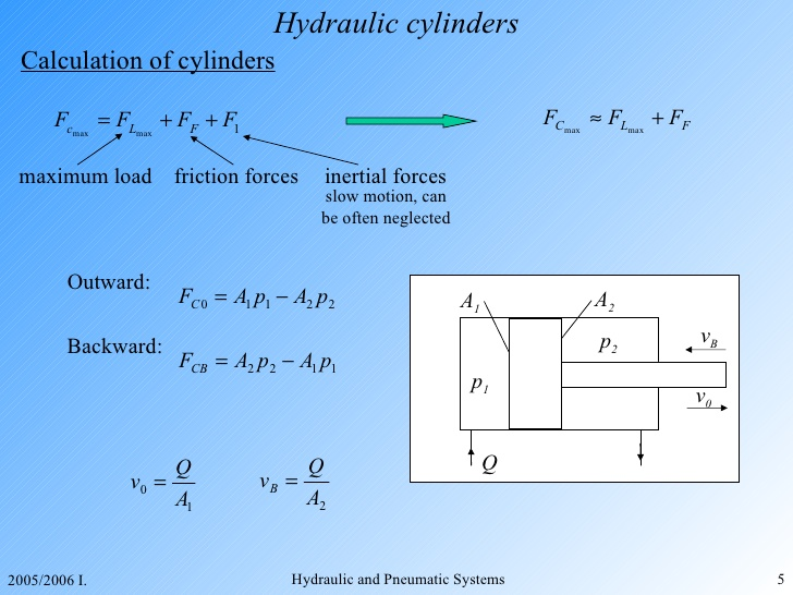

The rod displaces a considerable amount of fluid when the cylinder is retracted. Depending on bore size vs rod size, it could be more than 50% displacement. The cross section of the rod is actually subtracted from the cylinder bore when calculating the retracting force of a cylinder. The cross section of the rod is square inches on which the pressure from the oil is completely ineffective. More cross sectional square inches on head end. I've seen cylinders that had only enough bore for the rod, e.g. a portapower ram. Most hydraulic bottle jacks and rams are built that way intentionally. Their sole intention is pushing. Others use the rod end for fluid storage, and can only extend as far as the amount of fluid in the rod end will push. A fully retracted jack with a 3" bore and a 1" rod will only extend out to about 2/3 of it's total cylinder length. This is an inherent safety feature of jacks that use the rod end for fluid storage. Cylinders expected to use the full stroke are naturally weaker when the rod is fully extended, and this is the most common position when cylinders do fail (bent/broken rods, cracked rod guide, blown rod seals, etc.) Given the same operating pressure and flow rate, cylinders will retract faster but pull with less force. They extend more slowly, but use the entire bore size so push much harder.
