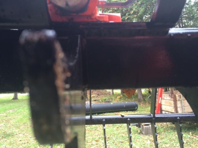

I just got a SGC1060, got the 3rd function valve isntalled today and got it home. I need to add 2 short hydraulic lines and Im ready to go.
As far as welds, I havent looked it over good yet. MIG welds are stronger than TIG though. In MIG, the wire gets penetration. In TIG, thats more a surface weld and a filler rod is used to filled gaps or holes.
MIG welds are strong, it has a lot to do with prep and the person welding.
I've seen many MIG welds that look great but would pull apart easily.also porosity seems to be more likely than other weld methods.
To each his own on welding methods. In our shop, MIG was not allowed on any x ray quality weld. Only ARC and TIG methods were used.

MIG or TIG has nothing to do with penetration or quality of weld. Both are different methods/techniques for welding. Standard stick welding would work bonzos for this application as well.
Lack of penetration (regardless of the method of welding) is too low of amperage vs. wire feed rate in MIG welding, lack of amperage and too fast of a travel speed in TIG. They should either use heavier wire or up the amperage and feed rate for MIG, or more juice and slow down for TIG.
My view is utter lack of a weld across the bottom, that allows the side welds to be ripped up like zippers, so that's engineering failure. Compounded by the lack of fusion in the welds (cold welds), that's operator error on the welders behalf.
If I owned one of those units I'd be flap sanding off that bottom paint and taking a good heavy stick of 6011 or 7018 to that beast then repaint.
I'm sure that LandPride's factory MIG is strong enough to weld those joints properly but I'm not so sure a 110V home MIG would be able to do it. TIG could do it simply because you can blast it with amps and hover longer for deeper penetration and just risk the distortion on the thick metal. However, I'd just stick it to it. Fast, easy and effective.

Ok, an update, of sorts: I received a call today,... the grapple is done!!!! They added welds to the top, and the bottom of the brackets. The tech said the original welds did not penetrate near enough, which we all kind of figured... So, now, just to get it to my place, and get back in the woods and get to work. I will update you all as soon as I am able to see how it works.

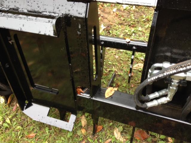

Here are a few pictures of the repair, painted all the grapple, which was nice of them to do....

By the way, Im not sure if you can tell from the pictures I took today, due to the fact it was so cloudy, .... but, the dealership welded the top and bottom as well... To me, it looks like the welds have much better penetration, as they aren't as "pretty" either.
"Pretty" or "Ugly" aren't an indicator of weld quality. Generally, people like the 'stack of dimes' look but it really doesn't affect the quality of the weld. TIG is easy to do that look, MIG and Stick are a bit harder.
Best weld, looks wise, is one with no undercut at the edges of the weld (it vanishes into the metal without a clean 'line') and the top is about equal with the edges on a fillet style weld. It should have a consistent step or banded look to it and be fairly straight. MIG guns can deliver strong welds that look like they almost have no pattern to them at all, just a raised, continuous blob of metal that comes up cleanly from the source material.
This is going to sound weird, but the best welds are the ones that work and don't fatigue over time. So using a welded tool is the best test of all.
