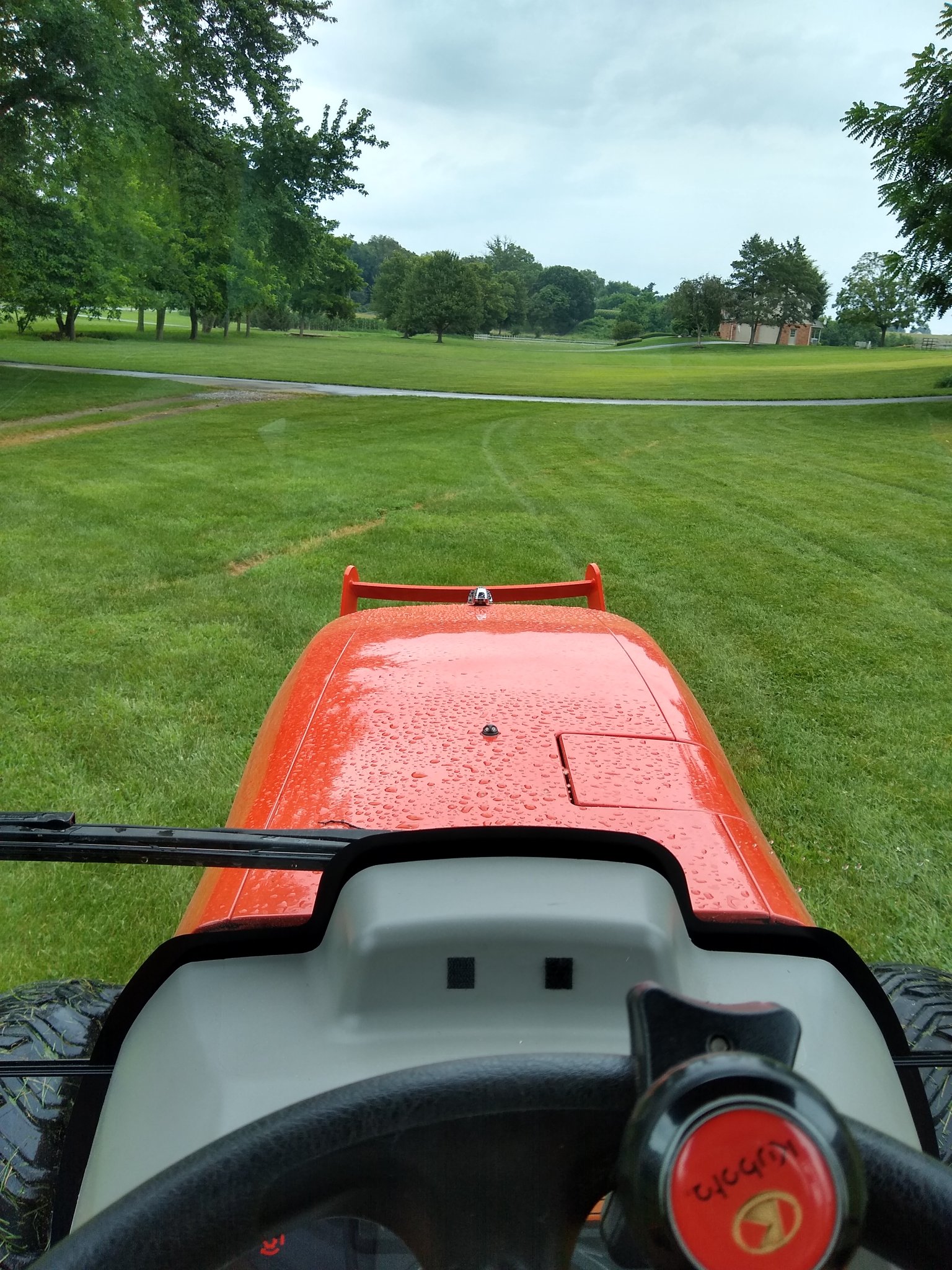

The photo below is from yesterday. #3 Son & family were here and I didn't want to mow with the kids running around. When I did get started raindrops appeared on the glass. Determined to get 'er done, most of the mowing was done while it drizzled, occasionally needing the wiper. The deck worked well. After the mowing was complete, the underside of the deck was garden-hosed off and green slush plopped to the ground. Fortunately the deck didn't leave green turds in the yard.
