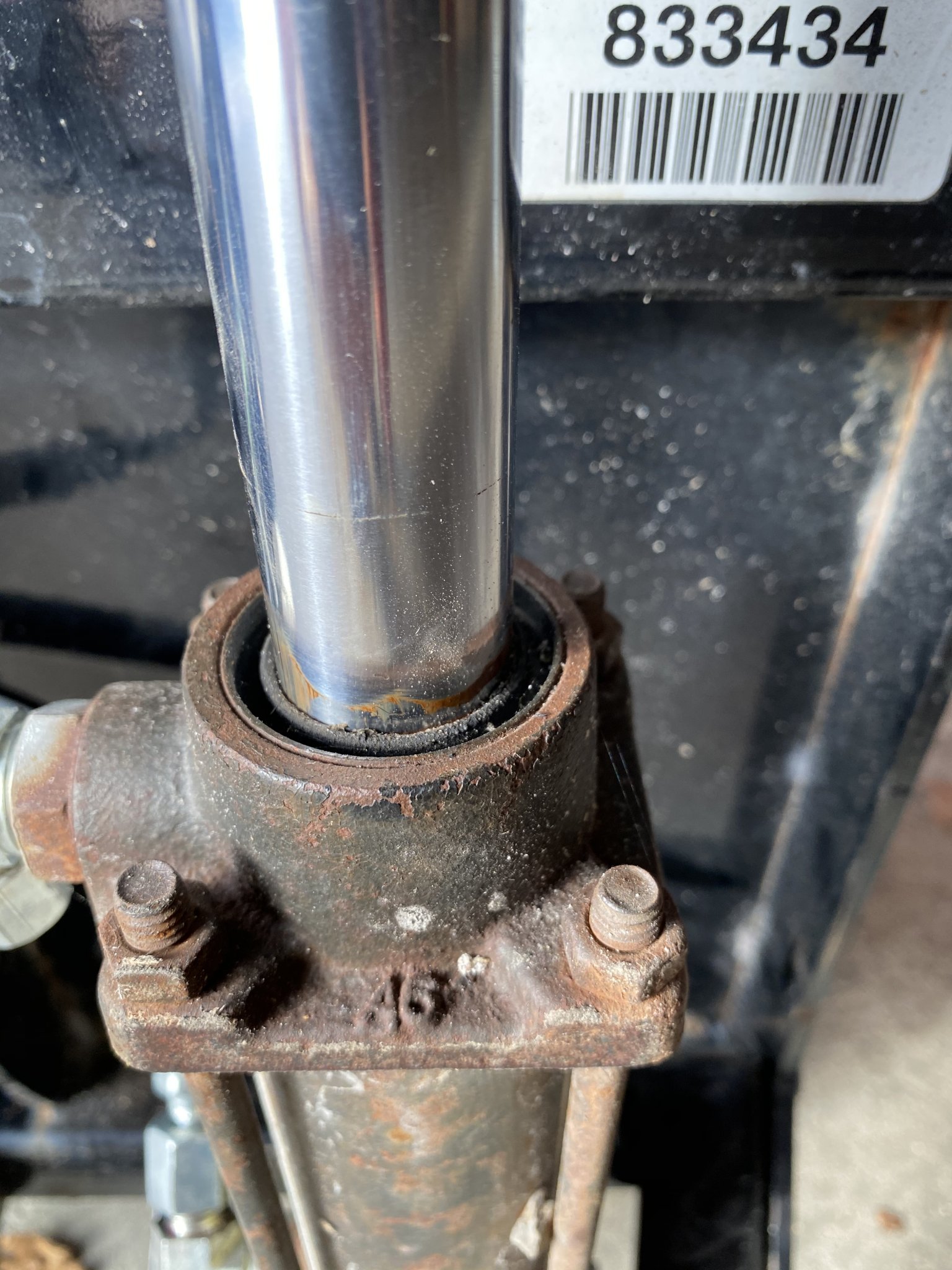

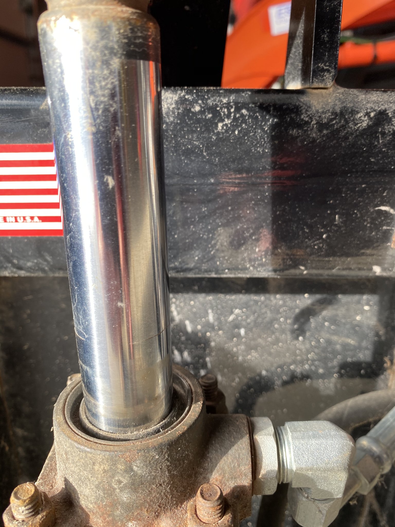

Ok, a picture is worth a thousand words. Here is what I’m talking about.

This image shows some blemishes that may be shallow pits or may be dirt -- hard to tell for sure. If they clean off, then don't worry about them. If you can feel a roughness with your fingertip after cleaning, then ease them with emery cloth as per D2Cat's instructions.
Awesome, thank you. I believe this to be dirt but I haven't done yet had the time to really take a close look. I say dirt because the few times I've tried to rub some of this off, it comes right off on my finger. I do have some time today, so will try and clean-up with WD-40 and cloth.

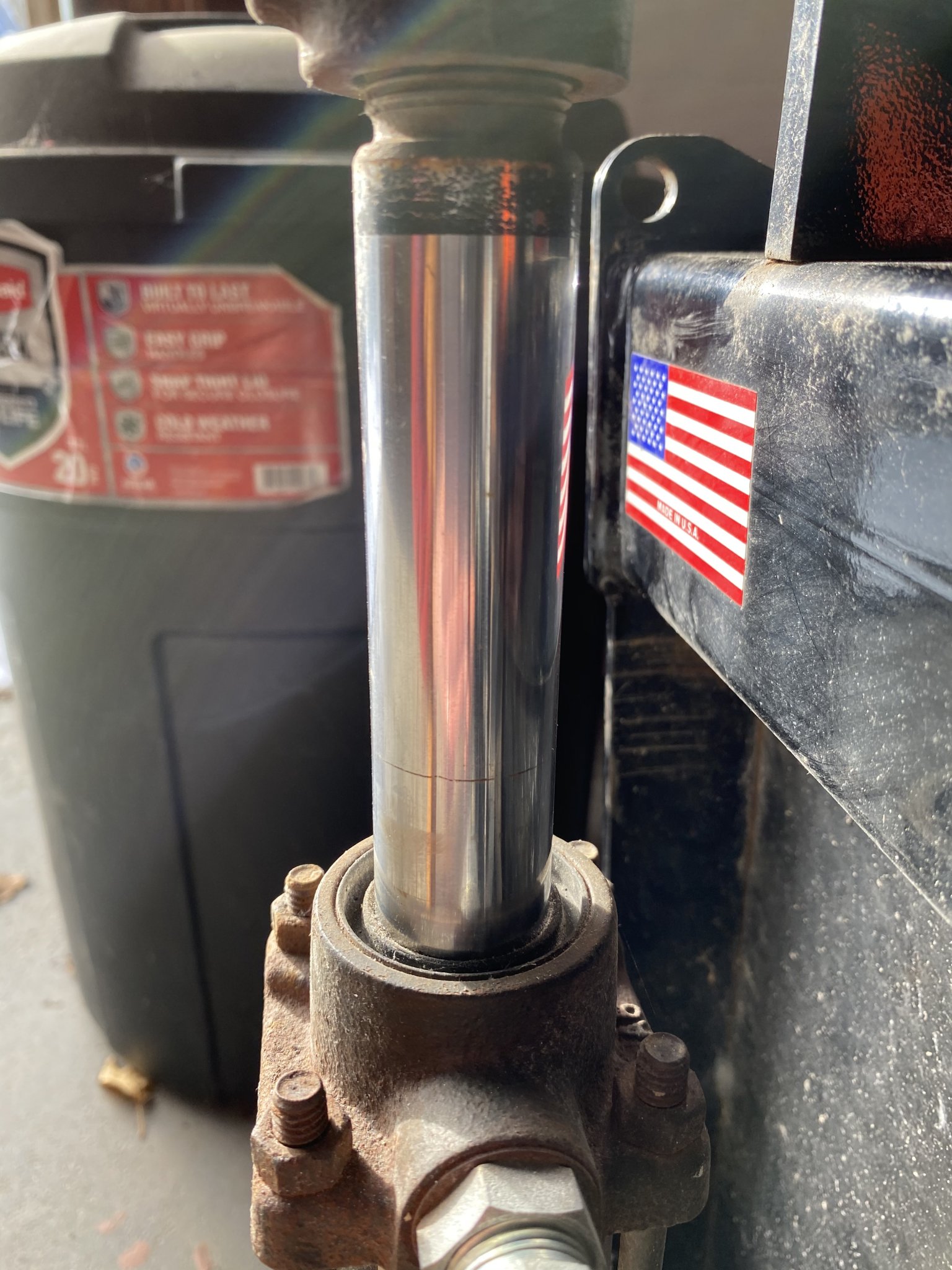

Ok, started to strip some of the rust off the cylinder bodies; looks better. I covered everything in a coat of WD-40, including the pistons. This took off quite a bit of dirt, but I do see some very small black marks which I assume are some pitting. There are two spots and they are very small, like the size of 1/4 of a grain of rice (or smaller). Are these worth trying to buff out w/ emery cloth?
Are they raised? Are they sharp-edged? A pit will leak a few micro-litres per stroke. Top off the reservoir every year. A raised, sharp edge will damage the seal and eventually lead to fluid running down all over everything. Those need to be eased with emery cloth.
Nope, they aren’t raised or sharp-edged. I check the hydro fluid regularly, so I’ll keep an eye on it for sure.
