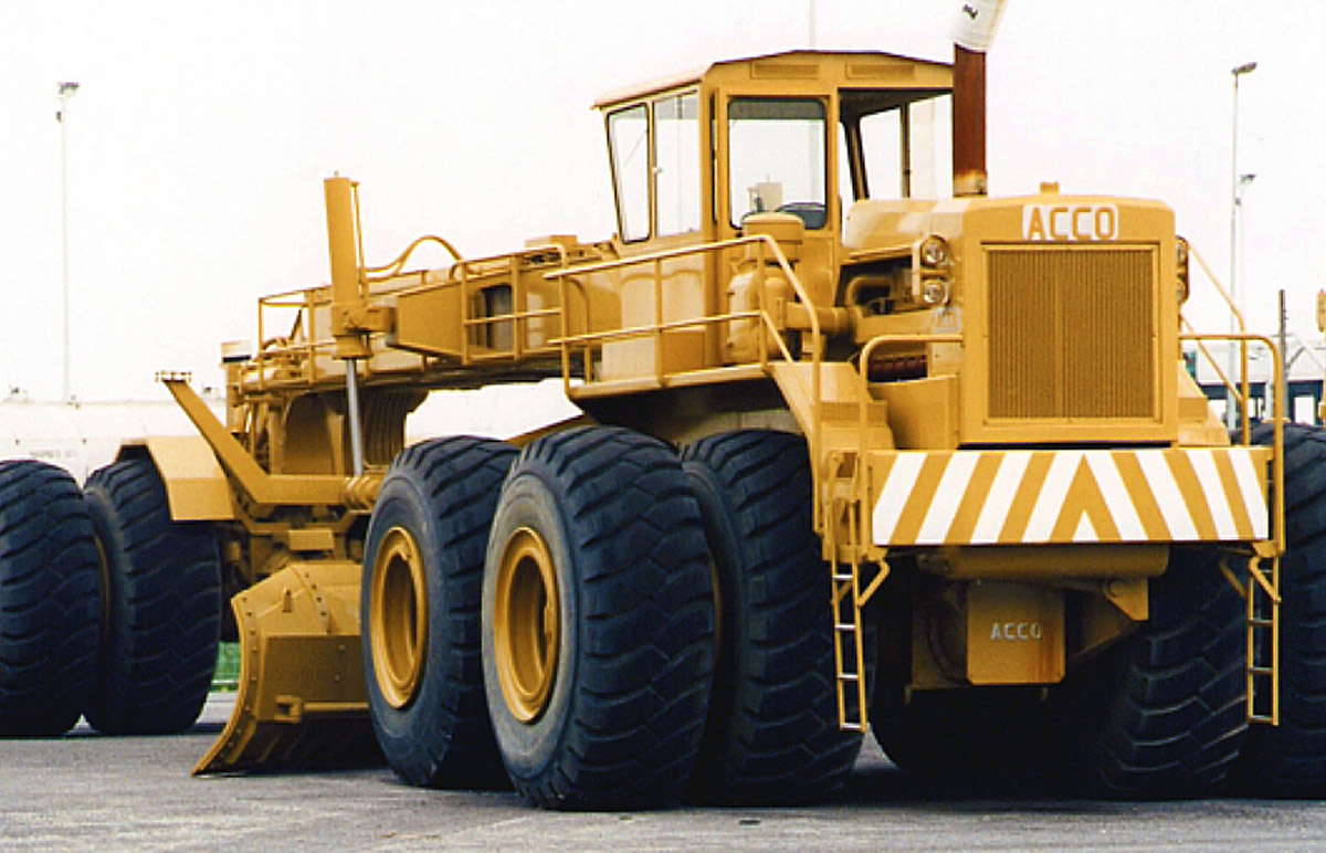

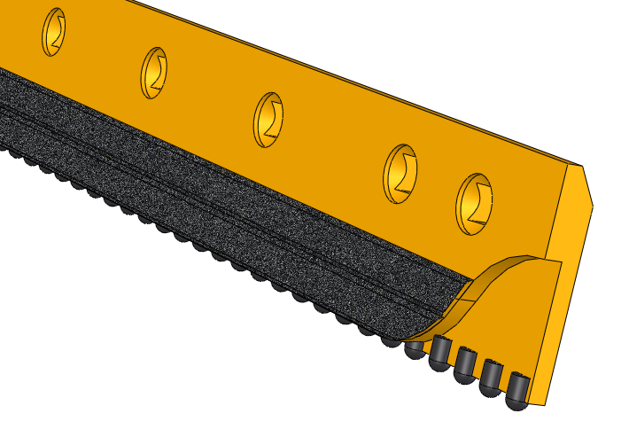

Need one of these
with this blade!

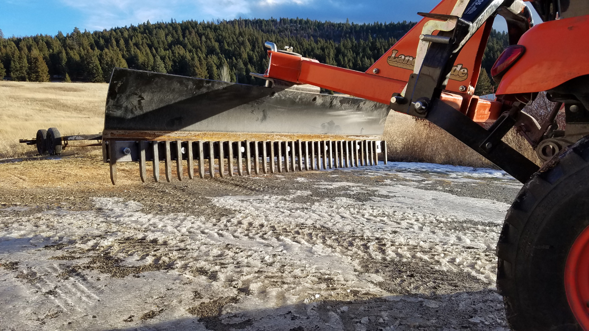

I found some photos of the "ice comb" I made for the BX25D rear blade. The original photo is dated January 5th, 2019. It didn't work that well, possibly because the rear blade wasn't heavy enough.

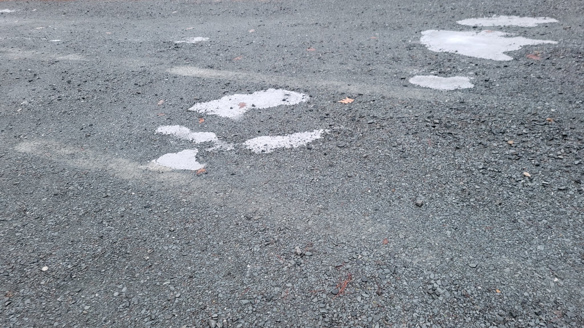

I am happy to report that I have found the solution. Three days of 50 degree plus winter temperatures will remove the ice buildup from your driveway.
7,265
10,028
I am happy to report that I have found the solution. Three days of 50+ degree temperatures will remove the ice buildup on your driveway.
Nice! I had similar results on the south facing asphalt driveway after three days in the 40s. But the gravel driveway which is north facing is still a luge track!
