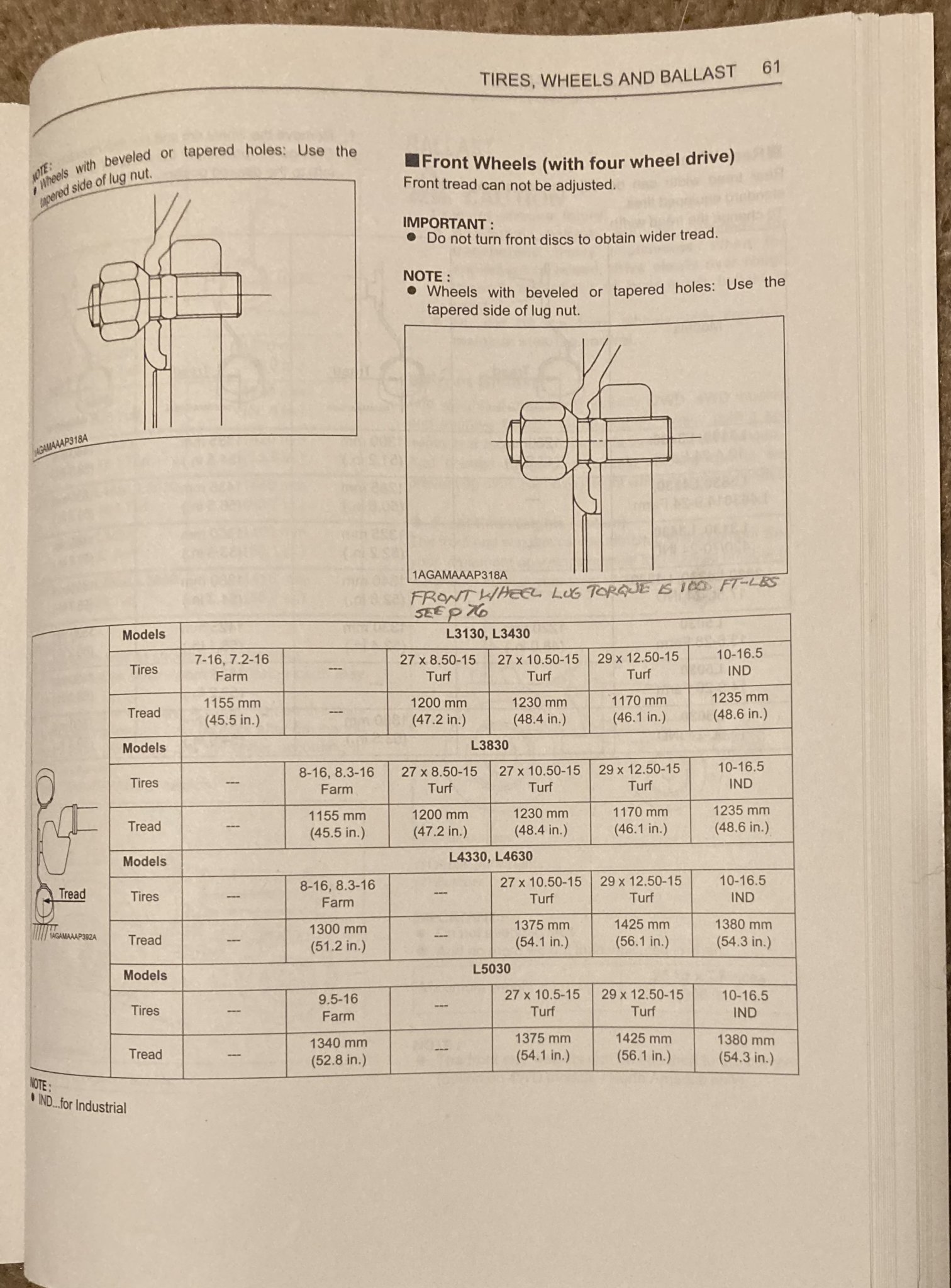

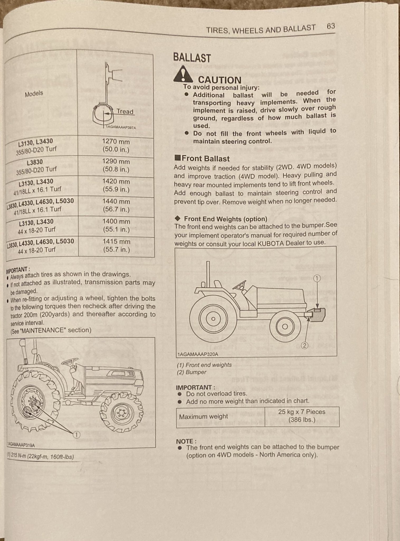

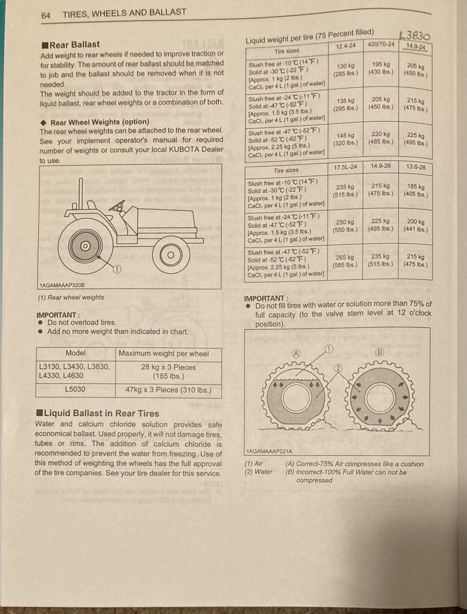

Yup, as stated above, it’s the R4 (industrial) version vs R1 (farm) version. Here’s some photos from my L30 series manual. I included the ballast weight chart too incase that’s helpful.

Ah, yes, it does have the R4 tires. So, maybe the Kubota manual offers specs for the R1?
Yes you have Industrial R4 tires, do you want to keep them or do you want to go with AG R1 tires?
If your looking to change types of tires you'll need different rims.
Thank you. The owner's manual that I found on-line has some of the pages you show, but it did not have the optional tires for the L5030. This is very helpful.
