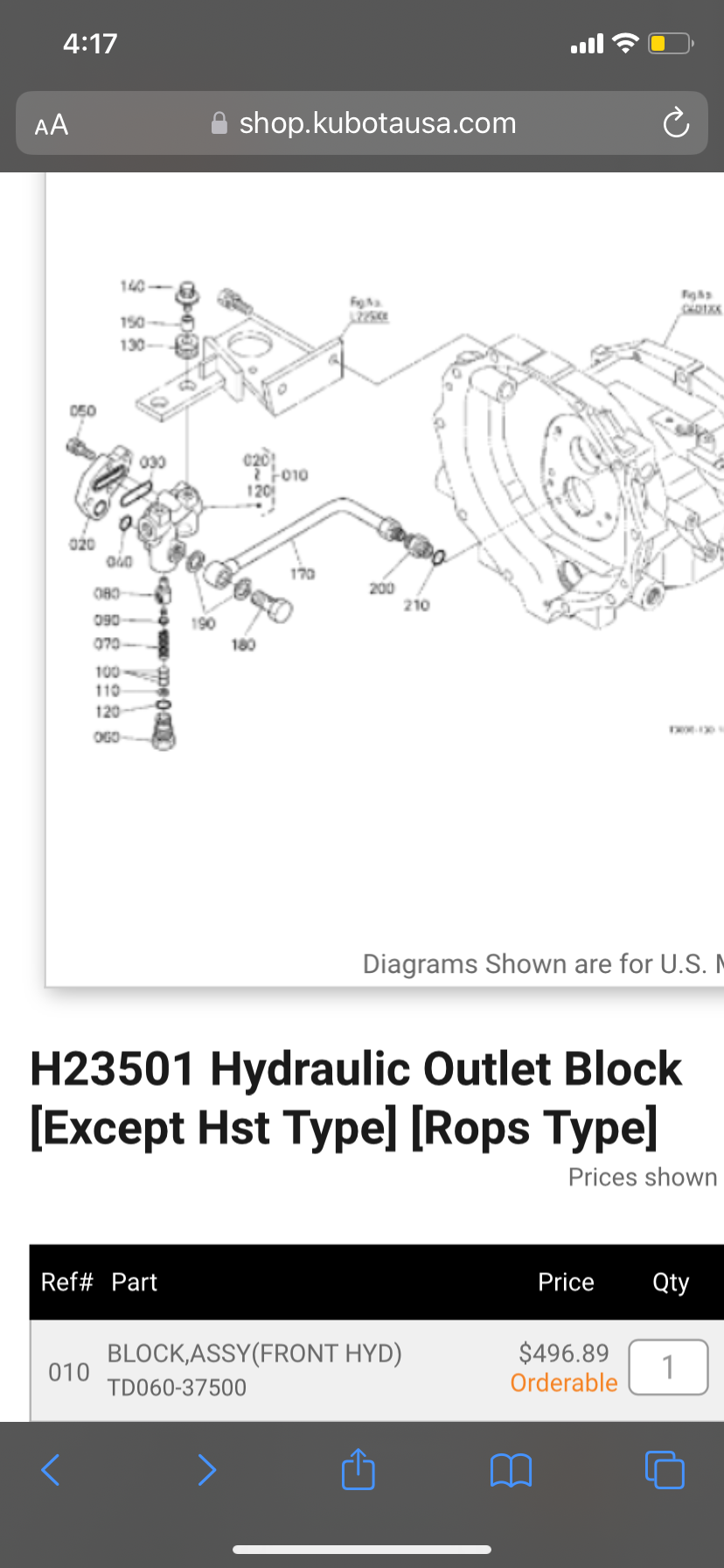

Ok, shouldn’t it be 2633 at idle? Kubota gave me this.

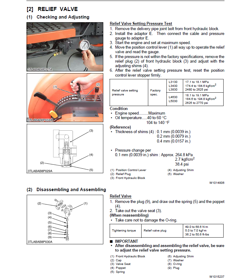

Actually the WSM does not give a spec at idle. The test is meant to be performed at max rpm see below. Like stated remove and inspect the relief poppet and seat and record the shims or lack there of. It appears it will take around 0.101 shim thickness to bring the setting to spec 2700psi. With that much shim needed, I suspect something is damaged, more likely, or you may have an air leak or restriction on the suction side.

I insalled 5 .2 mm shims and brought it up to 2000 at idle and 2600 at full throttle
Interesting considering their calculations show a change of 5 0.2mm shims should make a change of 192psi. Very possible you had a slug of contamination in the relief valve.
Now add a couple more shims and you should be in the middle of spec.
The other thing I would ask, is was the plug holding the relief in tight or is it possible it had backed out a bit?

Careful. You are off by 2X on the pressure increase. Its 38.4 PSI for every .1mm shim and he added 5 x .2mm = 384 PSI.
Yes my mistake. Sorry that's what you get for working and posting at the same time...LOL.
