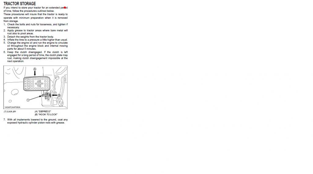

I have a 3901 HST...they (Kubota) recommend when parking your tractor for an extended period of time to press down the clutch and there is a pin that you slide over and it locks the clutch pedal in the pressed down position.
This is supposed to separate the clutch disc from the flywheel. They say that moisture builds up in that area and will cause corrosion when left long periods of time. This was not my case I ran mine once a week at least. I think this advice pertains to people that leave tractors inactive for months at a time.

Kubota even uses the "welded on hook" on some of their their newest HST models.
L3301/L3901's HST's from factory utilize same concept for storage / not in use periods. Depress pin - hook to lock - keep clutch disengaged when in storage or not in use.
B2620's HST's and similar came from factory with wooden block (spacer) to go between clutch pedal and frame. Push clutch down - insert wooden block - keep clutch disengaged.
etc...
good habit and recommended by Kubota for many of their HST's to do. Cheap and easy preventative maintenance for HST's https://www.orangetractortalks.com/forums/images/icons/icon14.gif
