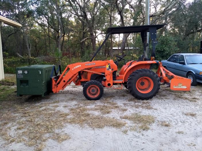

OP back with an update...
I put my grapple on because it is the most solid anchor point I've got. Put the rotary cutter on the back for ballast. I rigged up a sling and anchored it to the bottom of the back edge of the grapple. No, turns out I cannot lift a 1200 pound generator... but I can curl it! By tilting the grapple down, lifting to take all the slack out, then tilting the grapple up I can get a few inches of clearance, just enough for my needs. I was able to move it (very slowly) from where I had dragged it off the trailer and into the garage so I can tear it down in relative comfort. Thanks for all the suggestions and encouragement, guys!

OP back with another update...
After moving the generator a couple times with my jury rigged sling contraption I researched pallet forks and ordered a lightweight set from Titan. Turns out I can lift it just fine. Whew, that problem just got a lot easier! :)
