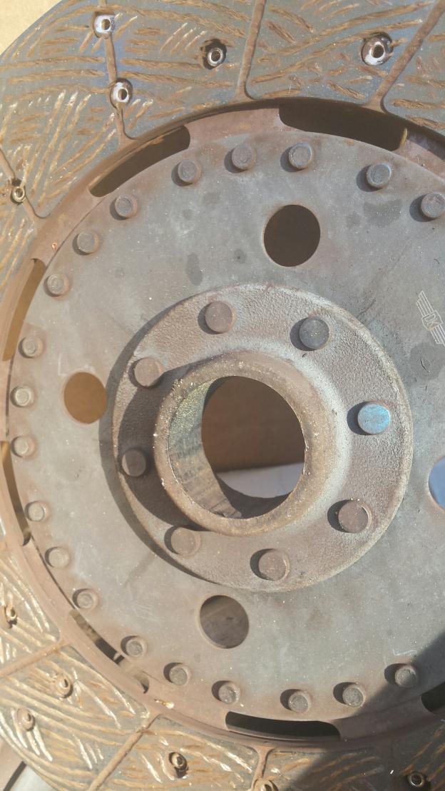

Been a little time since I posted. I got the parts and it went back together beautifully. The clutch disk has no splines. :D

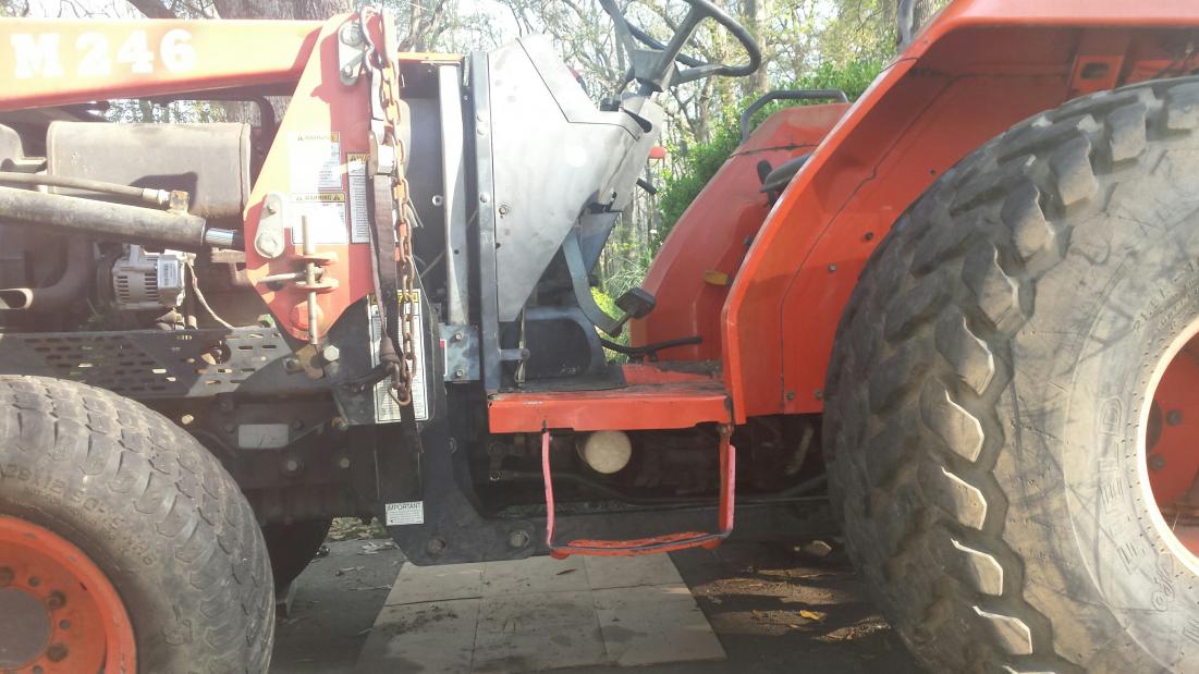

By the way, everything went great until I tried to start it and it would not crank, turns out a little 4 pin connector came loose to the ignition switch when i was tearing it apart. I plugged it in and all is well! Patience is king!

Kubota must have poorly heat treated a few of those clutch hubs, I've run into this a couple of times. The clincher when you are diagnosing this is observing if the pto also is not turning.
