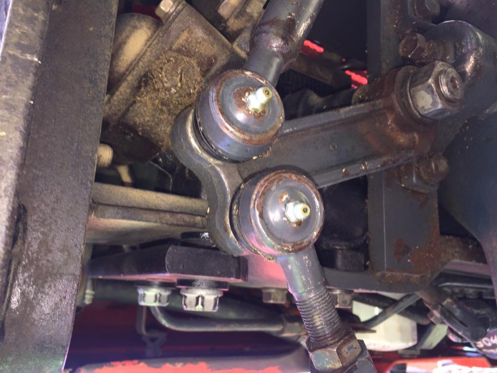

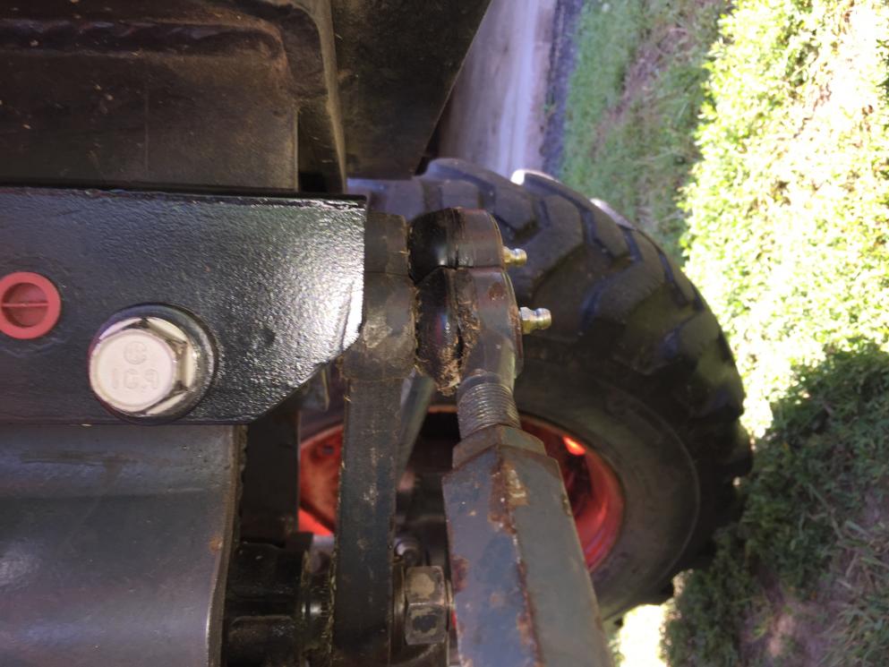

Trying to figure this one out before taking a bridge, I noticed the steering stops on the knuckles were quite worn, combined with a little play in the tie rod ends (the reason I drilled and tapped for grease fittings), along with a poor design.... I got it!! Now how do I fix it?
This is what I came up with. I found a piece of 1/2" x 2 1/2" , cut, drilled, fit to hit pitman arm, and spaced out with flat washers for adjustment. I had to cut the angle to clear the tie rods when the axle articulated. I set it so I could get my fist between the loader valve and the tire (after straightening the bracket). Now I have plenty of safe area with the pitman arm hitting the stop long before the ball nut hits the bearing retainer blowing the box apart. Now I know why it's the defunct "old style steering ".
