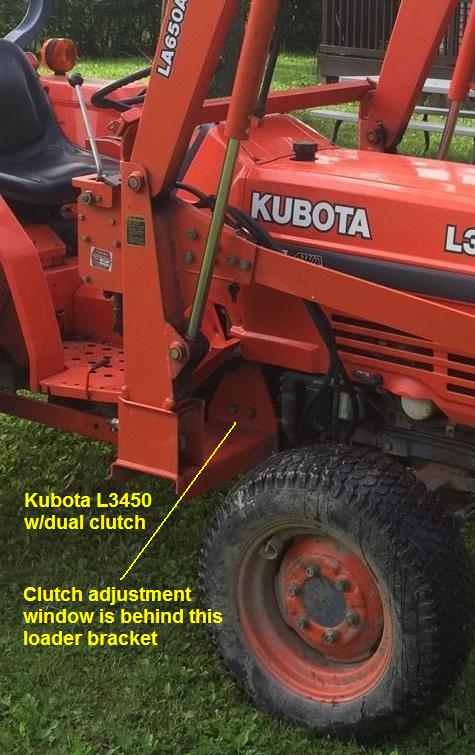

If the original travel disk's facing material had mostly worn away, clutch adjustments may have been done in the past to compensate as it got thinner. The throw out bearing may be adjusted so far back there isn't travel enough to disengage a new full-thickness disk.
There is an access hole in the right side of the clutch housing which allows adjustment of three screws in the dual clutch. See L3450 owners manual para 12.1 attached - same setup.
A loader's lower bracket covers the hole so it has to move - see marked-up pic. It's possible to leave the rest of the loader in place. Take out the wedge on that side, and at the rear axle leave one bolt in but loose so the bracket 70 can swing down - and go back up in the right place later.
Hope this is useful - Good luck, Dick B.

Another tip is an easy way to bring each bolt into the window. Jack up the rear tire and put the trans in 2wd highest gear (4th hi range). Turning the rear tire by hand turns the engine.
