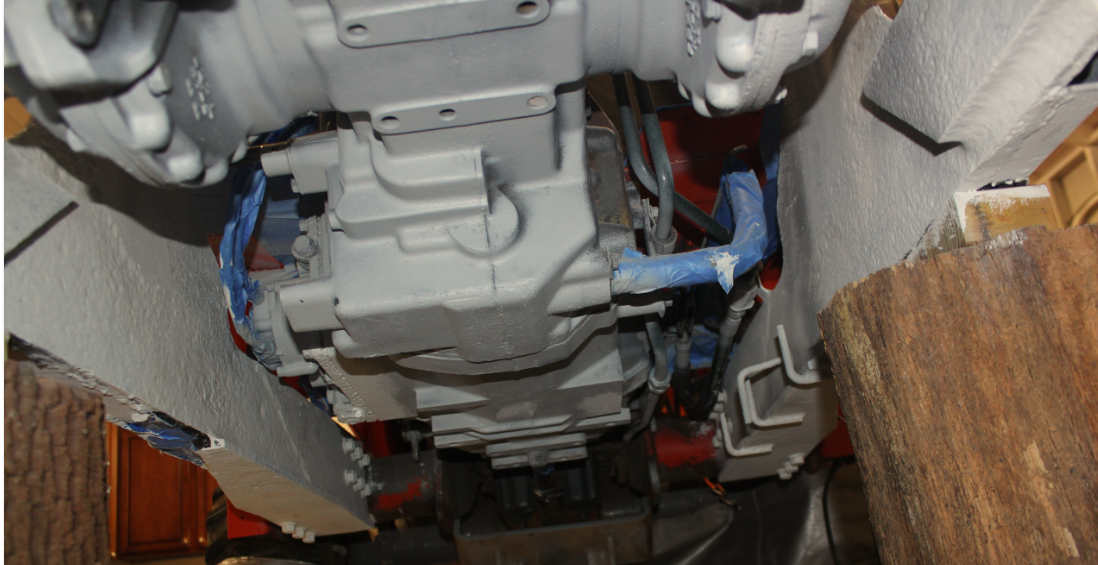

Here are a few pictures of the ongoing progress.

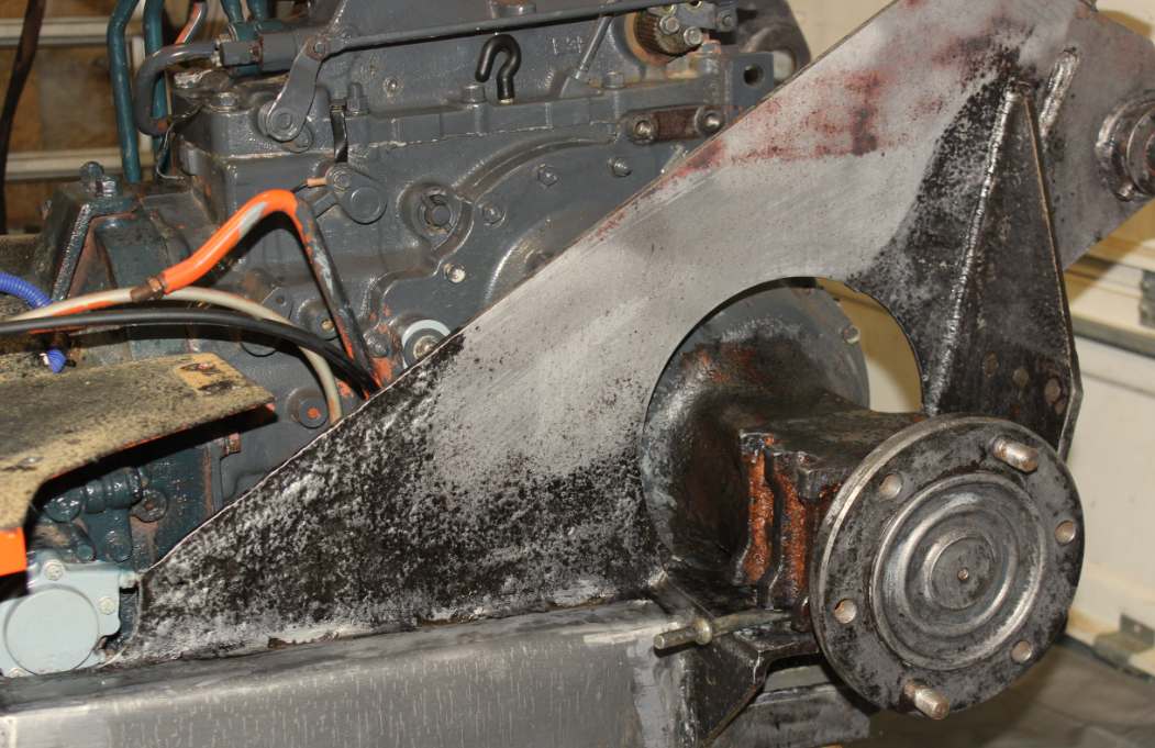

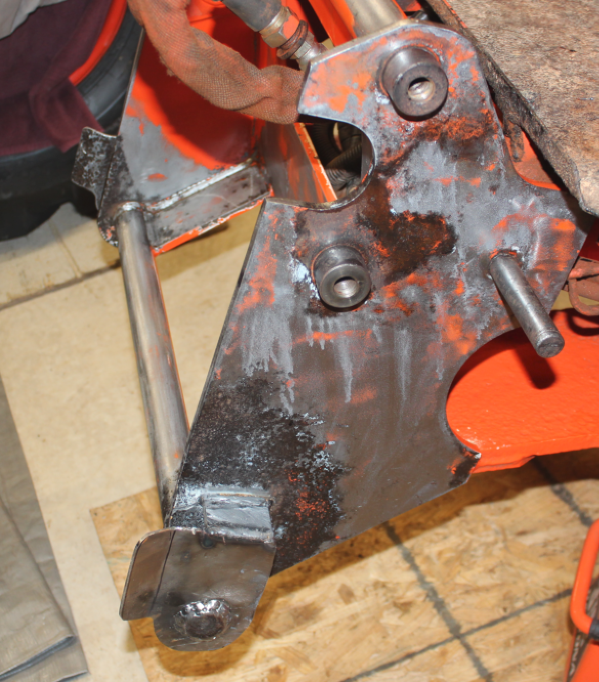

The next two photos are how rust is being converted using OSPHO.
Rust turns black as the process continues.
I don't know why that section of the axle shows as orange - it's not paint.
The result after two days was a slightly rough surface ready for primer.

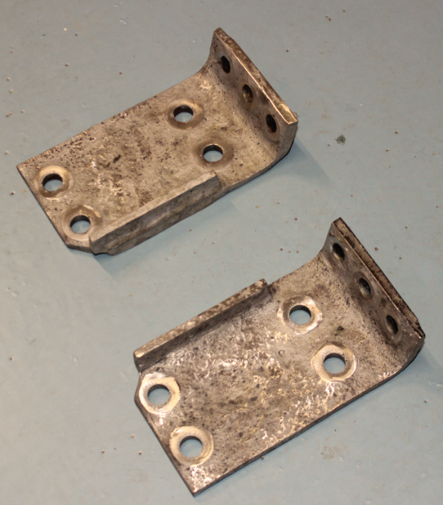

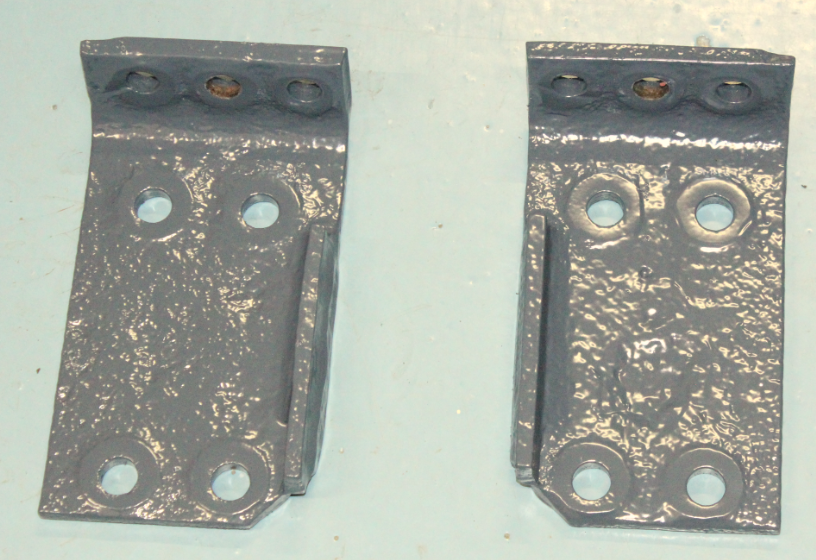

Frame supports after cleaning and before/after blasting.
I decided to powdercoat these.
I used high zinc powder primer, then top coated with Dark Grey powder
I had both white and grey primers so I used both:
The first color coat turned out rather nice!
More to come...

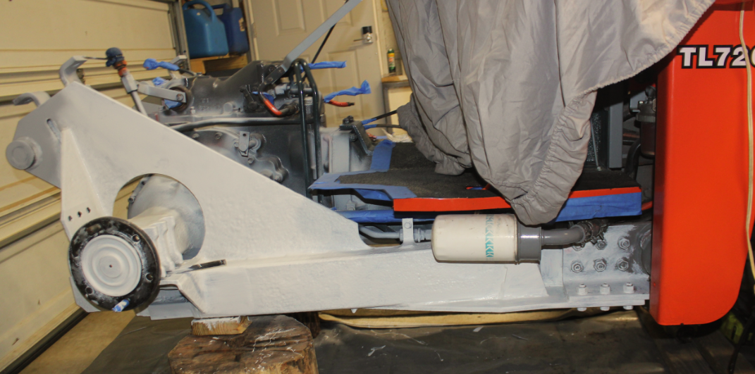

CONTINUING.......

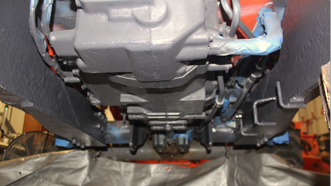

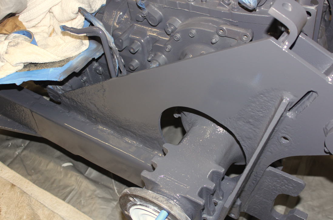

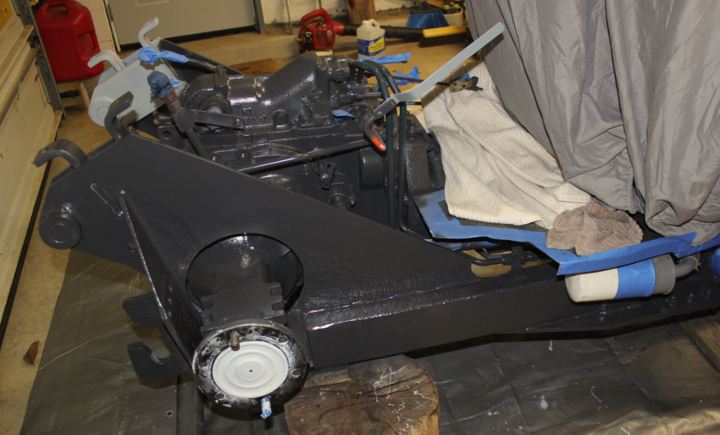

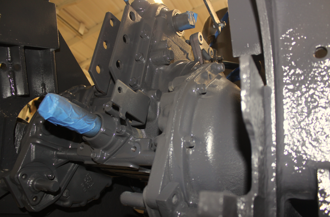

Here are a couple of pictures from the latest work on the L35:
I won't bore you with pictures of the painting action - just a few pictures from the now-completed frame.
I think I'll give my back an extra day to recover, then I'll start putting the tractor back together (without the rust!)
Sometimes the flash makes the paint look light grey - but I assure you it's dark grey.

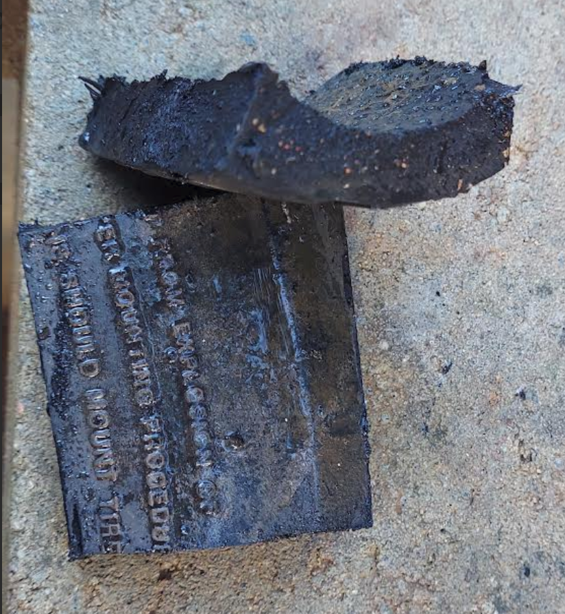

Just for kicks I cut out the sidewall of one of the tires so I could see what there was to see.
Wow! Those sidewalls are thick! The rubber is much tougher than a car tire.
Cutting was horrible. I used an angle grinder with a cutting disk - which was a mistake.
Cutting reminded me of my son's drift car burning the tires around the course!
Hmmm, I probably should've used a recip saw or similar. :D
Nonetheless here is a photo.
After thinking about the costs and especially the time to dismount the old tires, sandblasting, (possibly finding rusted spots), cleaning and painting and remounting, I just decided to purchase new front rims.

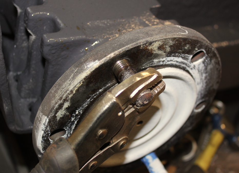

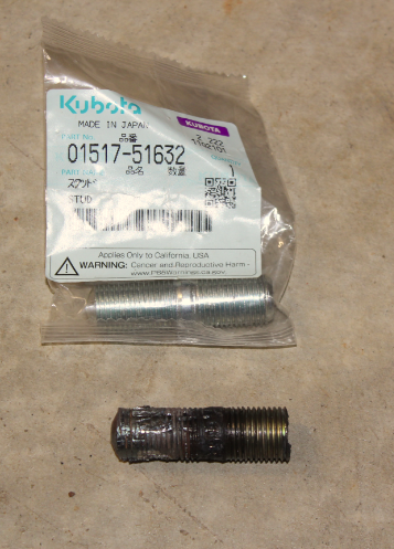

The Rear Hub received 2 new studs. The old ones had a lot of thread ground off - I guess from bad removal habits. A torch, Induction heater, PB Blaster and vice grips were ALL that was needed!
New studs went in easy.

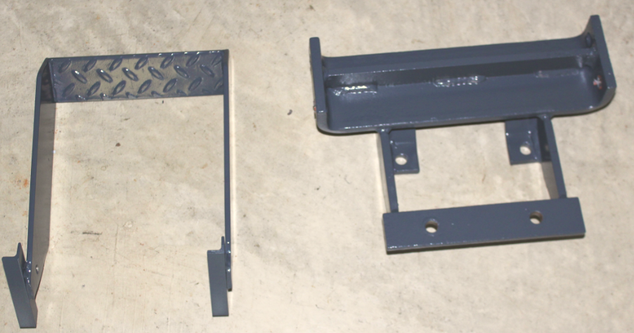

The Step and Loader Brace got some new powdercoating
Of course the Frame Mounts were painted

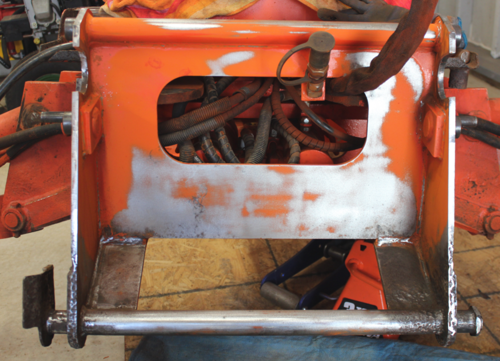

Then - I hit a snag.
Years ago when I was rebuilding, I was pretty new at this and didn't use any real rust prevention.
So from the Frame Brace forward, the machine is undergoing stripping and redo.
The rust came back with a vengeance and it needs to be stopped!

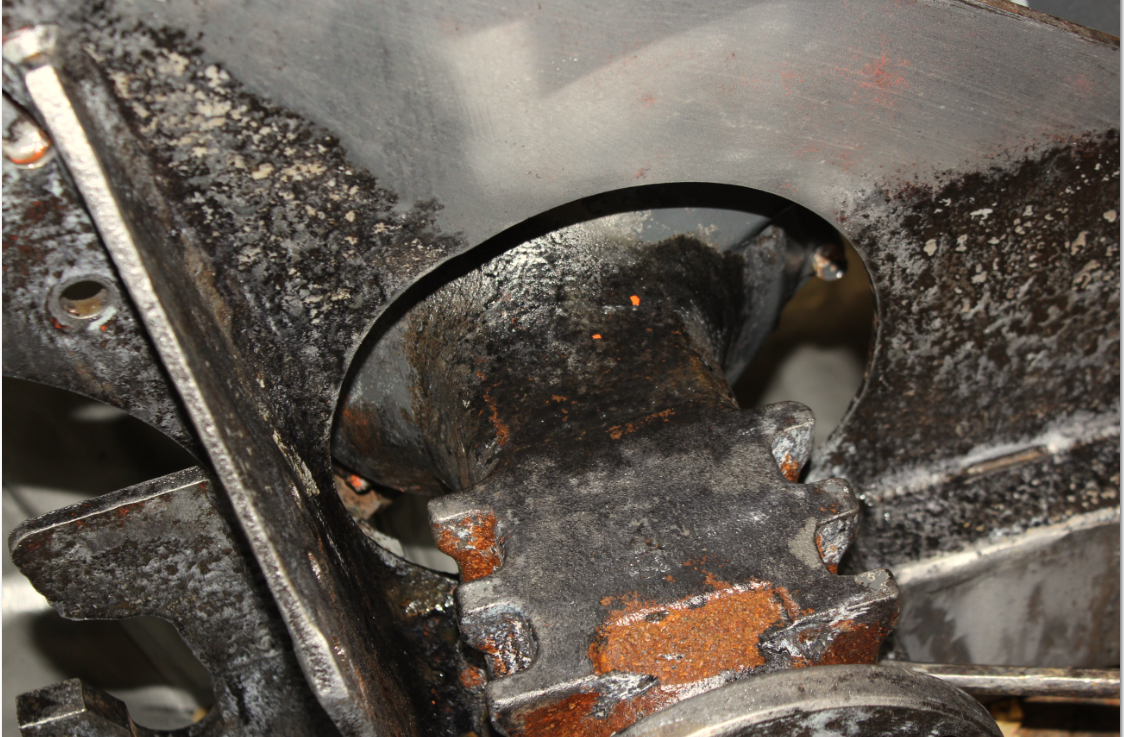

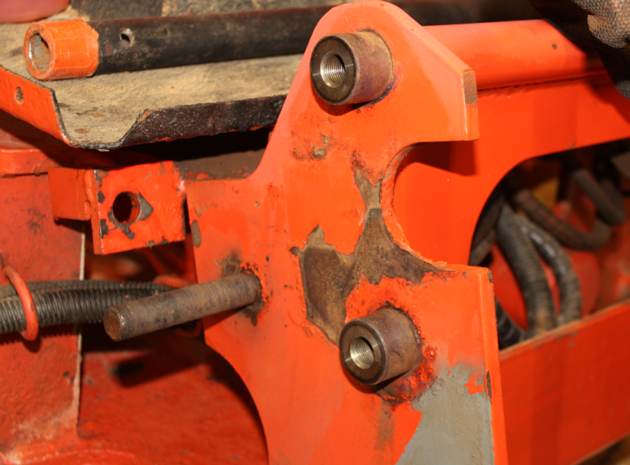

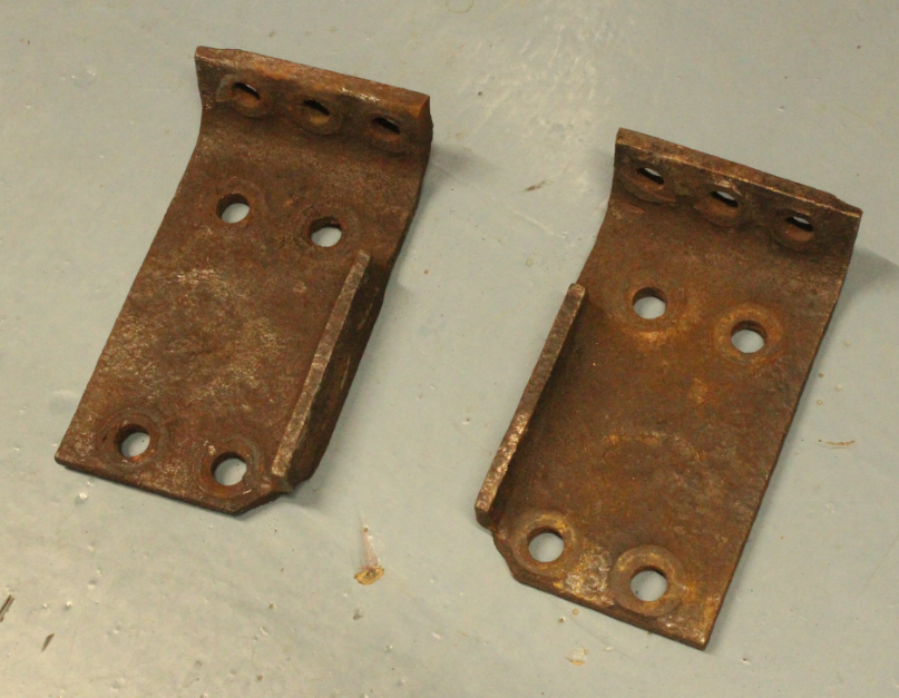

The part of the backhoe I never got to until now...
Closeup of the Frame after cleaning - showing lots of rust.

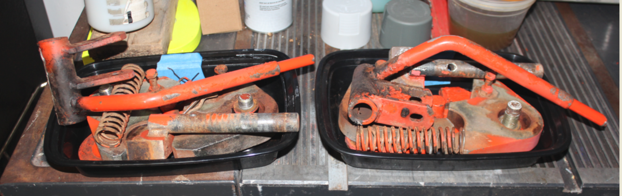

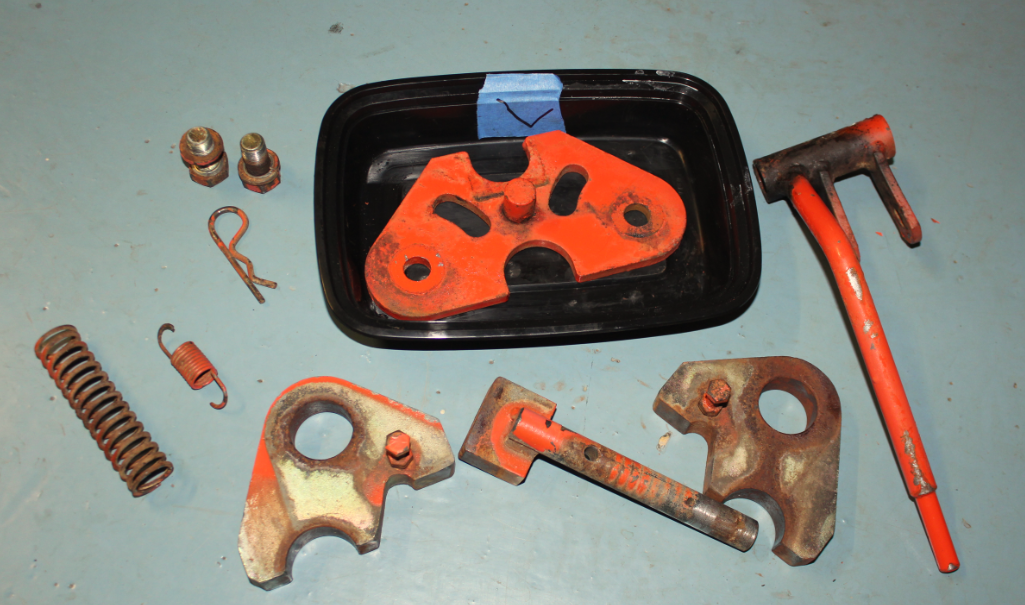

Left Side Release components. Rust removal very much needed.
This work with require a lot of TLC in the form of blasting, and powdercoating.
It's no wonder I could never budge the Release Levers. Everything was rusty and locked up.
This mechanism should move smoothly to be able to release the backhoe from the tractor.

For some of these parts you can use something that eats the rust off the metal.
Like this
Thank you Russel!
I've used EvapoRust for some time and I think it's great.
I find that if I put small parts in a container with EvapoRust and then place the container into hot water, the heat makes it work faster. I use that technique with my Ultrasonic heater.
I wish I'd known about products like that 5 years ago!

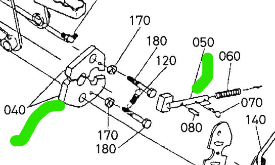

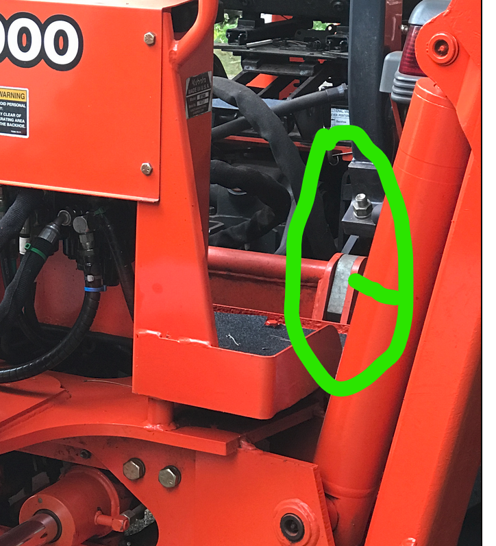

Check out this photo of the latching mechanism (Holder Mounts) on an L35 I found on the Internet.
It appears that the actual Part Number 040 "Holder Mounts" (and other parts) are unpainted - which makes sense.
One of the many issues on my L35 is that paint was randomly strewn everywhere. You can see it in the above pictures.
@PoTreeBoy and @L35 I'm assuming your holder mounts and Pin Sets are unpainted as well.

Yes bare, but zinc like coating so no rust.

Thanks guys!
I was able to get all the parts cleaned and ready for powdercoating today.

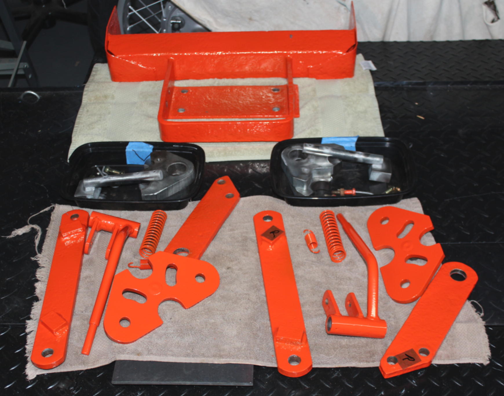

MEANTIME...moving along with the project...
I've got the BH parts powdercoated and ready for install, but that darn "life thing" happened again.
Fall brings leaves and dead batteries in cars and Dr. appointments!
I've been delayed a bit while replacing the battery in my wife's car and blowing leaves off - well - everything!

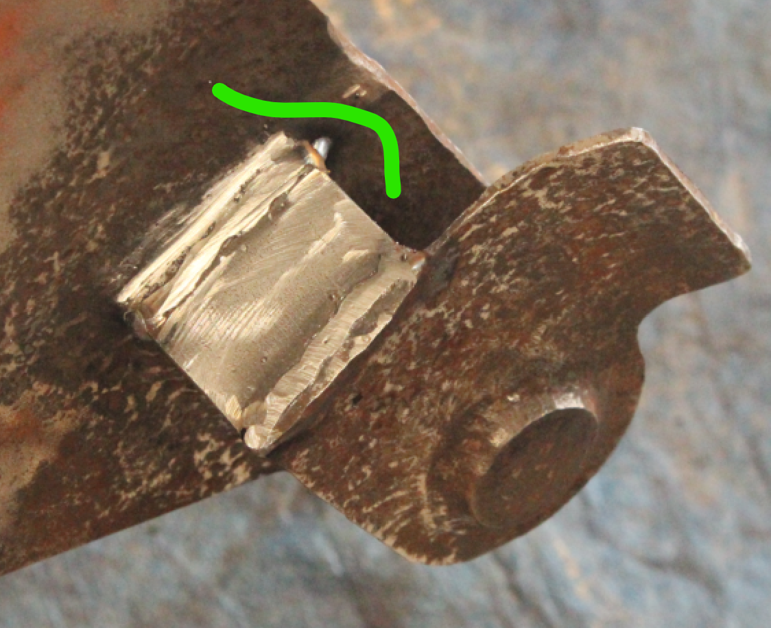

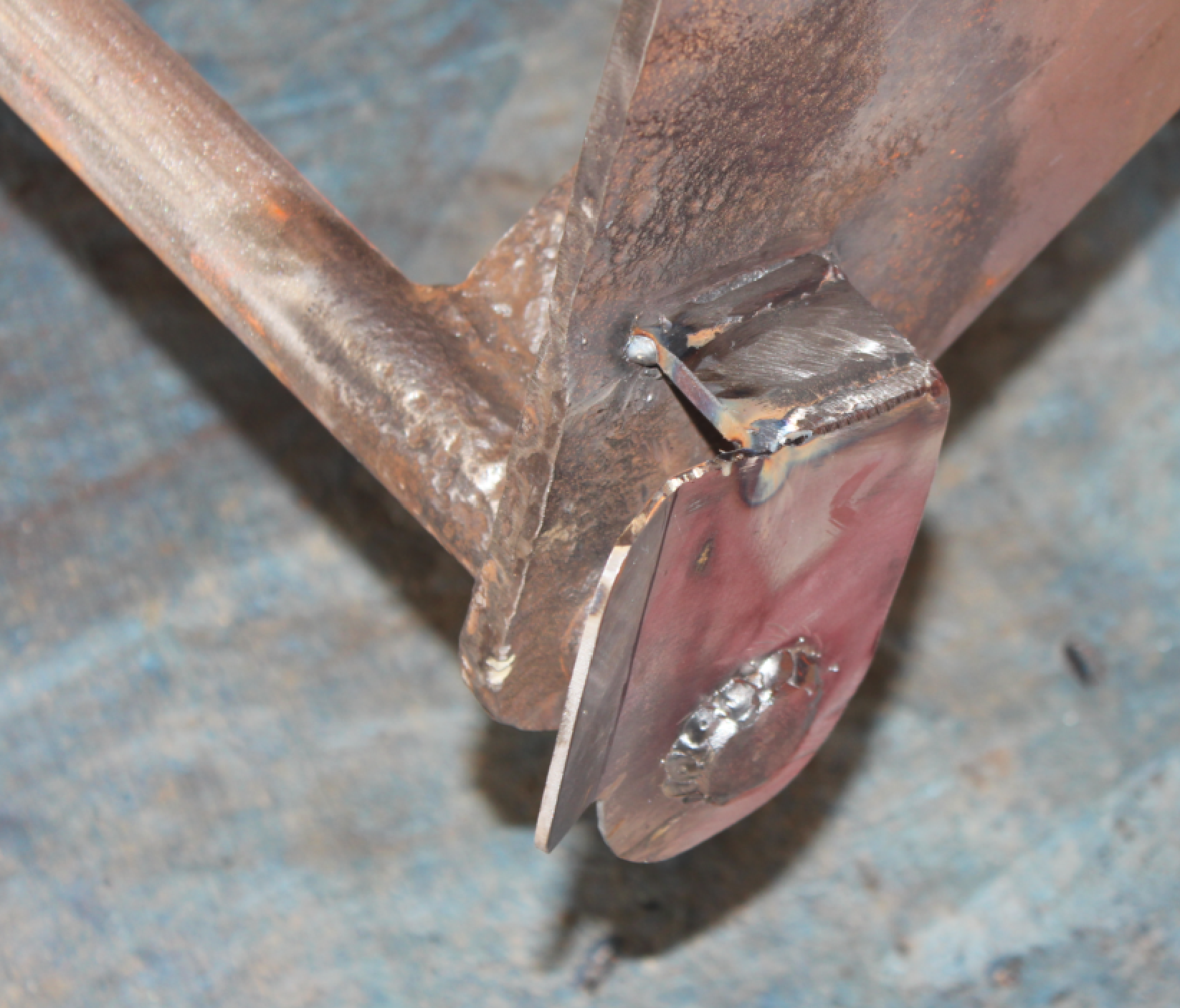

I welded the slots I'd cut in the release arms (to get them off the BH).
Some decisions are needed on the very front of the machine where the steering cylinder lives and the bonnet mounts. Rust removal and prevention is needed. I may end up simply replacing some of it with new metal - decisions, decisions.
The BH frame where it meets the L35 is clean, and ready for rust prevention and paint.
Here are some pictures of the parts after cleaning and initial degreasing.
And here are the BH parts and also some of the Tractor Grill support pieces after coating.
All parts are coated with zinc coating and then the final topcoat.
Funny - everything really does take longer than you think!

Here are some pics of the progress...
The bottom of the BH has guides to help it engage the hooks on the tractor frame. The Right side was damaged and the Left side was gone.
Here is the new Left side
The Right side received a top brace
After sanding and removing lots of rust and old paint.
Here is are the same areas after OSPHO application. You can see how rust was converted to black.
Here's another view showing the LEFT (worst) side
Primed and ready for paint
Completed
The OSPHO technique I used on this portion was to wet a towel with OSPHO (very dry) and rub the OSPHO onto the surface. The conversion began immediately and was amazing. I left it overnight, and very LIGHTLY sanded rough spots with 320 paper and then applied primer.
The tools I used are as follows:
Harborfreight (copy of Eastwood) surface conditioner. I've used this for years to remove rust, paint, and mill scale from metal. It's staggeringly good.
Air tools including an air drill with Roloc discs
