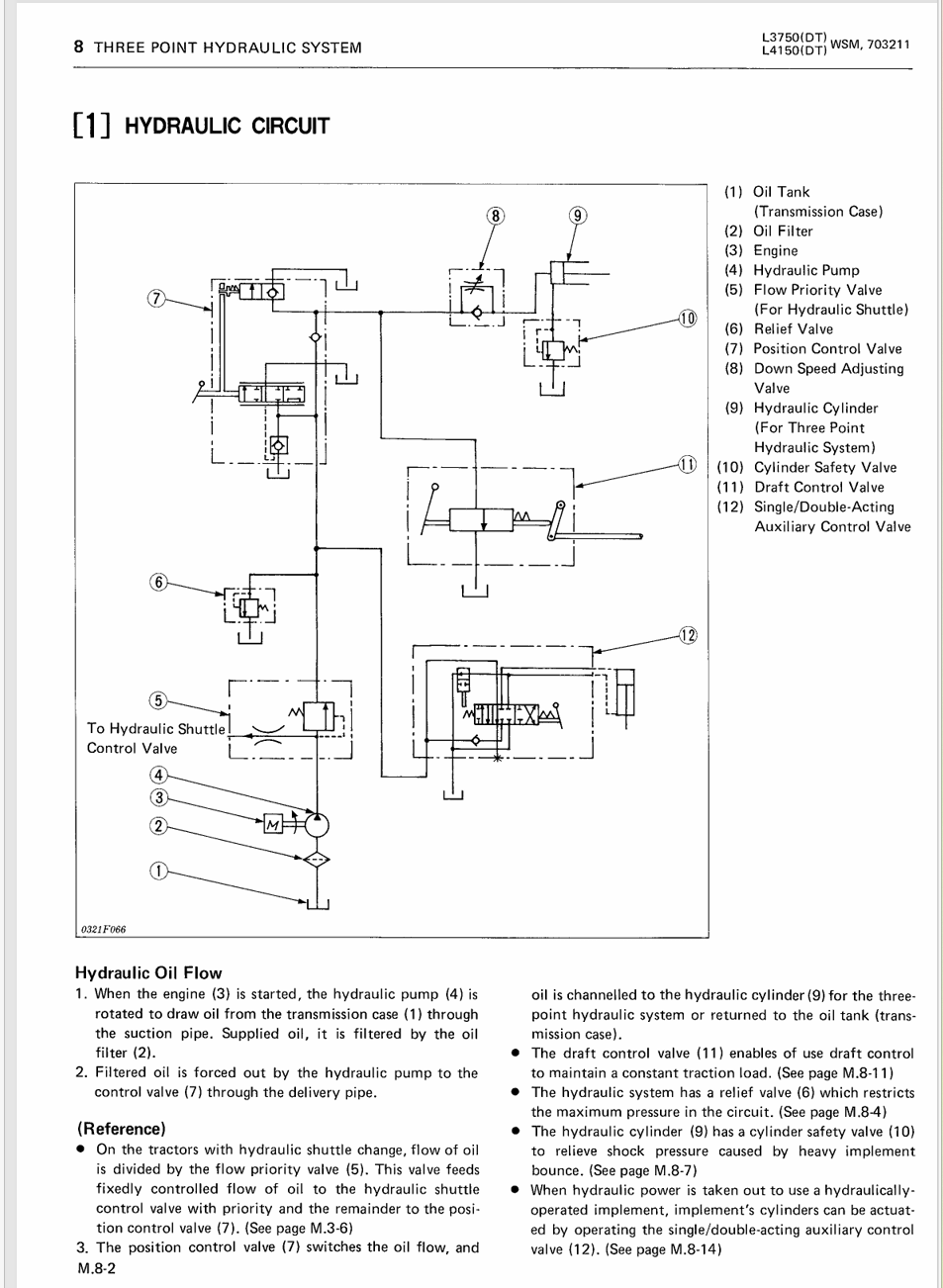

I will add to what @North Idaho Wolfman said. If the valve appears to be working the next step would be checking for flow and pressure at the valve. Thats where your problem is. Stsrt there and work back, not the other way around.

Just looking at the parts disgram it appears the shuttle valve is fed by a prority flow divider. The loader is on the excess circuit?

I understand all that. I am trying to understand what cycling the PS or loader tells you.

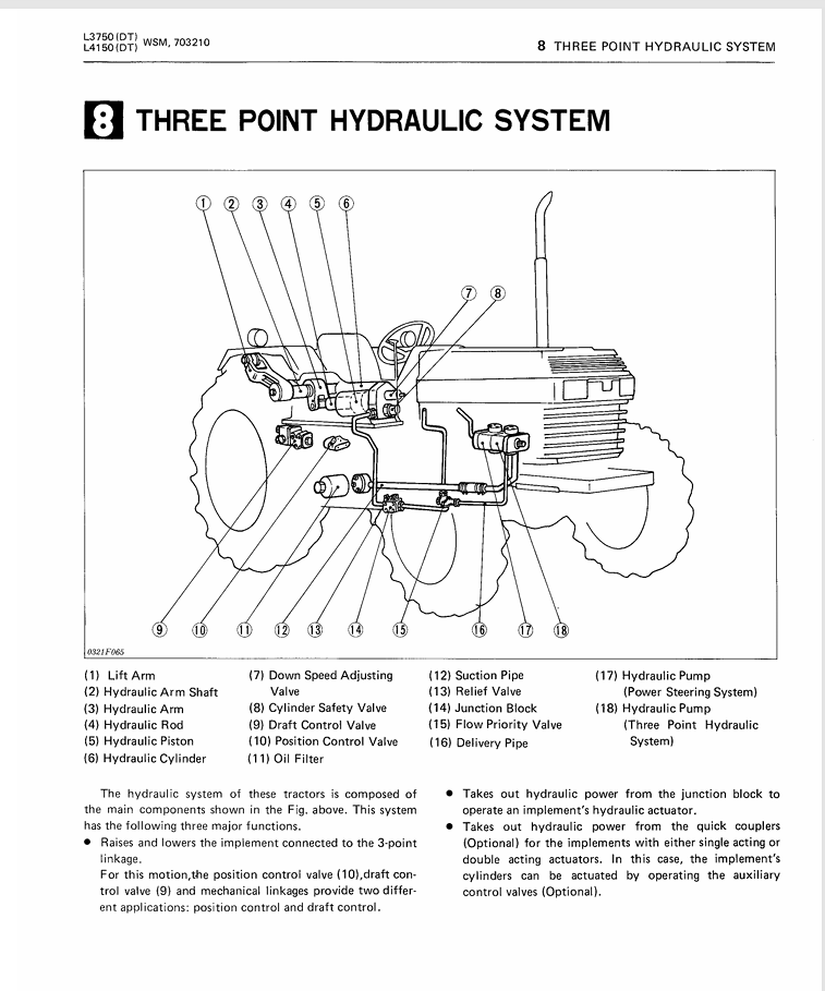

That tractor has a tandem pump. One section for PS and a implement/shuttle section with flow divider. Checking flow at in and out of the flow divider is real easy.

I asked and he answered way back in posts #6 and #7. According to him the loader is behaving erratically.
I think its time to pick up a wrench. The question is how and where. I suggested the PB line on the loader valve. Hard to tell from browsing the parts listings but it looks like the loader valve contains the primary relief for that half of the system so its an easy and safe test point. Would you agree?
I would agree.

Thanks to @whitetiger for the shop manual pages. That lays out the hydraulic flow and component locations quite clearly. It really would be helpful if the OP would answer whitetiger's PS question
