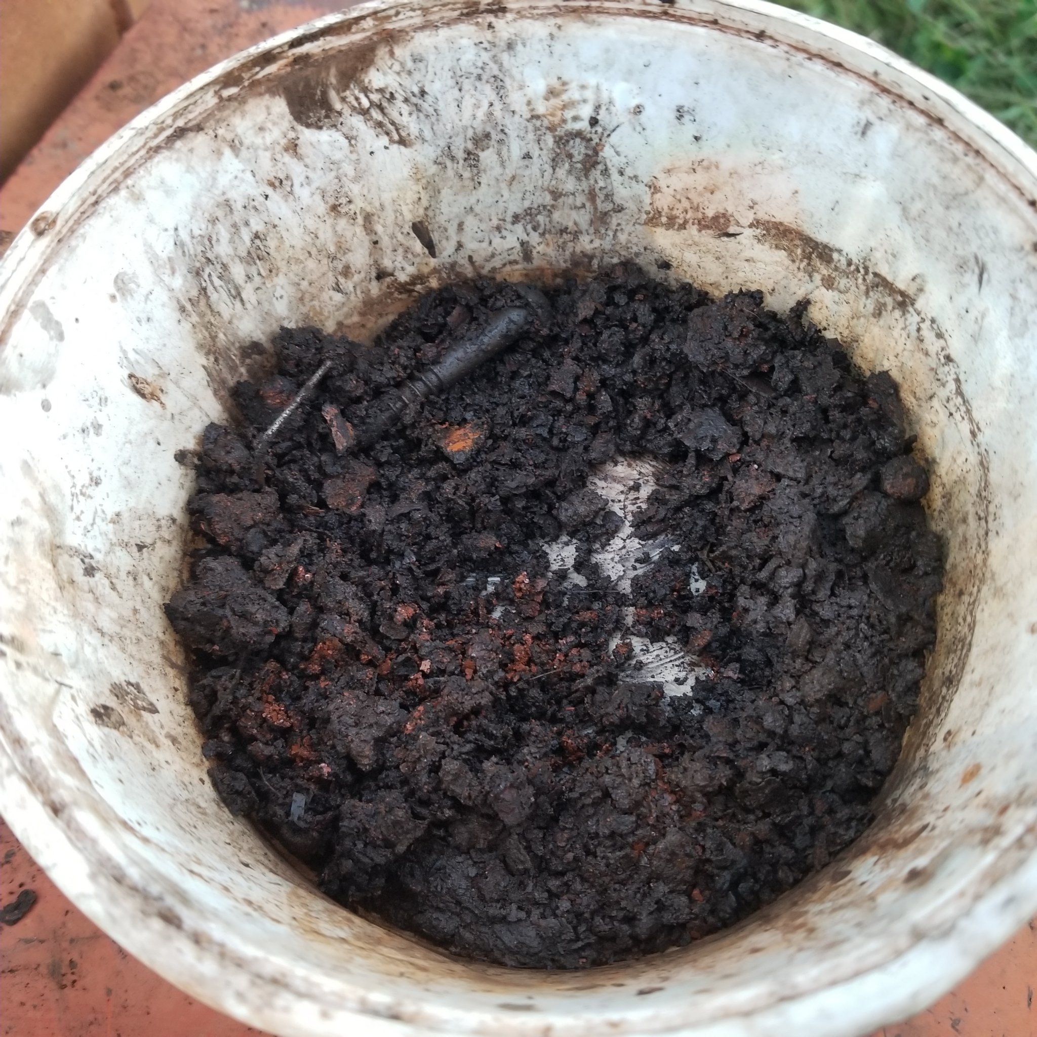

I've got a DitchWitch R40 trencher. Has a gas tank that is integrated into part of the machine. Be a major job to get the tank off and cleaned. The machine in a 1980 model so it's have a lot of opportunities to get junk and rust in the tank. It has a sediment bowl, inline filter, then a lift pump (which it doesn't actually need). I had trouble getting it to run for any extended period of time last week so I spent several hours trying to get the tank clean.
Here's a collection of the majority of it. Even found a 3" screw in there! This is a plastic container for Cool Whip.
